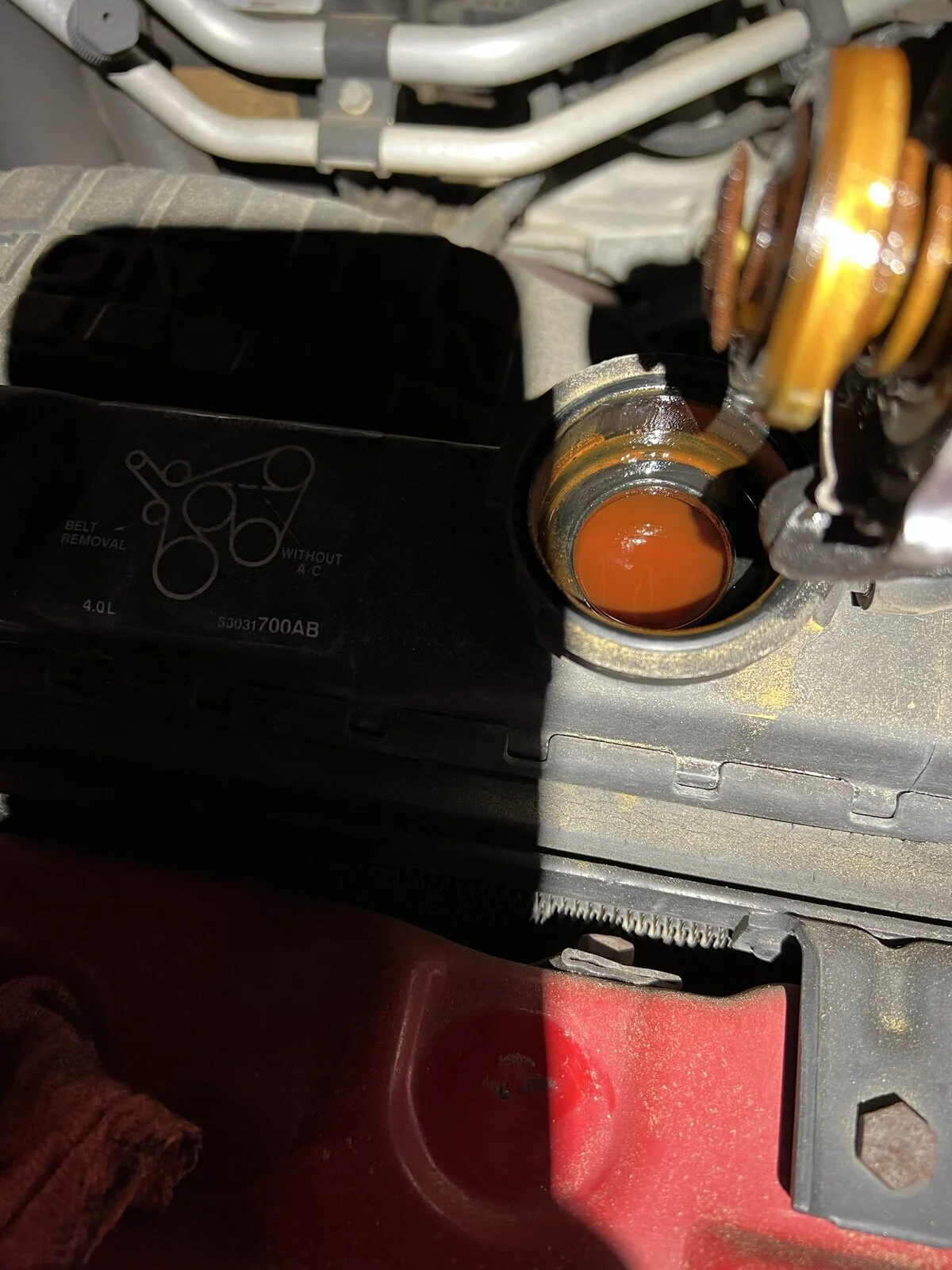

History is spotty, I picked it up last October with ~32k on the clock after it was mostly parked during the PO’s divorce. I did the typical fluid changes when I got it last year + replaced the rad cap with a new stant after the coolant was changed. Attached is what the coolant looked like before it was changed last year. Everything I’ve worked on has been original, so I’m assuming the water pump is as well.

Your coolant looks horrible

Now that I've seen what the coolant looked like at time of purchase I'd say absolutely a thorough flush is in order. While I did say I've never noticed a benefit from a flush, I also have never had one where the coolant was opaque enough that I couldn't see the aluminum in the top of the radiator.

Yours looked solid rust water, definitely looks like Thermocure will be big help.
