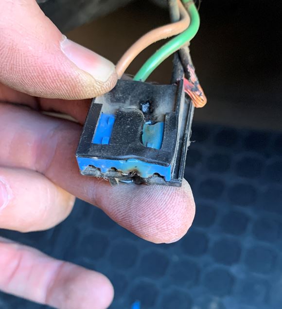

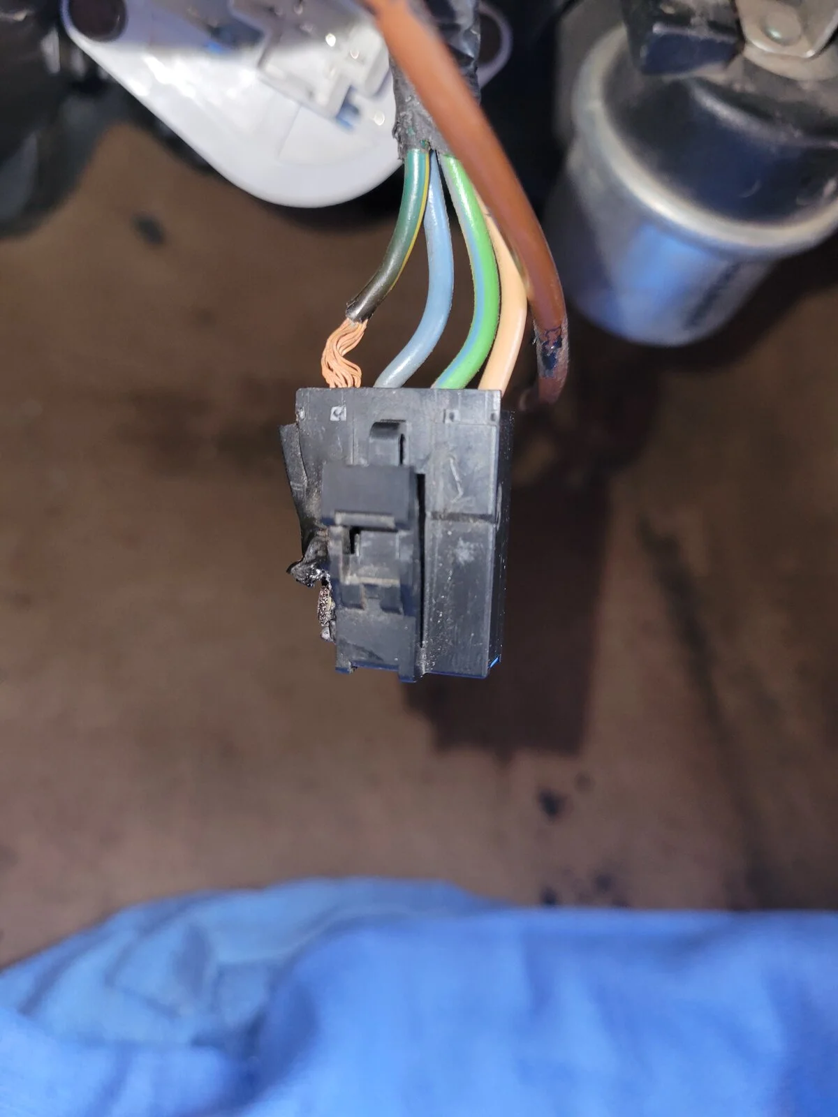

I recommend looking to verify the wires/plug are in good condition. That way you can also get those parts if neeeded. Photo shows what mine looked like, the entire left side of the plug got melted
yupp, resistor plug is fried. do yo recommend to change the blower motor to although it has no visible damage? just for the sake of time?
Blower motor going bad is the cause of voltage spikes which causes it to melt. So yes, change the the blower motor at the same time
