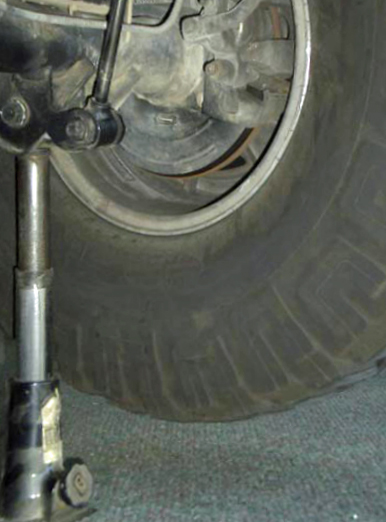

The factory jack works fine up to 35" tires and 37" in a pinch. Lift height doesn't matter, my TJ has a 4" lift and this is my factory jack lifting my 35" tire off the ground nearly 4".

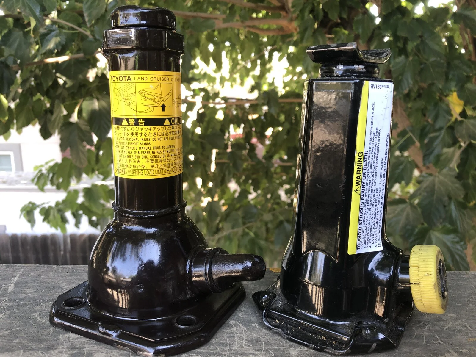

If you no longer have your factory jack or it doesn’t suit your likes, factory Toyota Land Cruiser bottle jacks are extremely well made and lift about 3 inches higher than the Jeep jack. I got mine on Craigslist for cheap.
