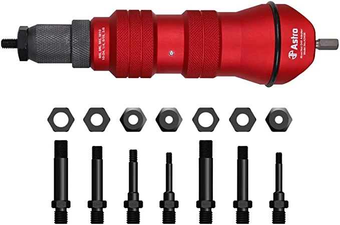

I am a big fan of nutserts. I use them in many of my projects. I have a variety of tools including chunks of steel with lock washers, hand operate lever tools, but my favorite when it will fit in the confines of a project is this
Astro Pneumatic Tool ADN38 XL Rivet Nut Drill Adapter Kit - 3/8" Capacity​
and this Astro Pneumatic Tool 9456 Rivet Nut Hog - Stepped Installation & Removal Bit
I hate that piece of shit with a passion. We've broken ours so many times that now we only use it on 1/4" or smaller nutserts, only with a 1/4" hand ratchet, and only when it is convenient. I still use it and won't get rid of it but what a great idea with very shitty execution.
