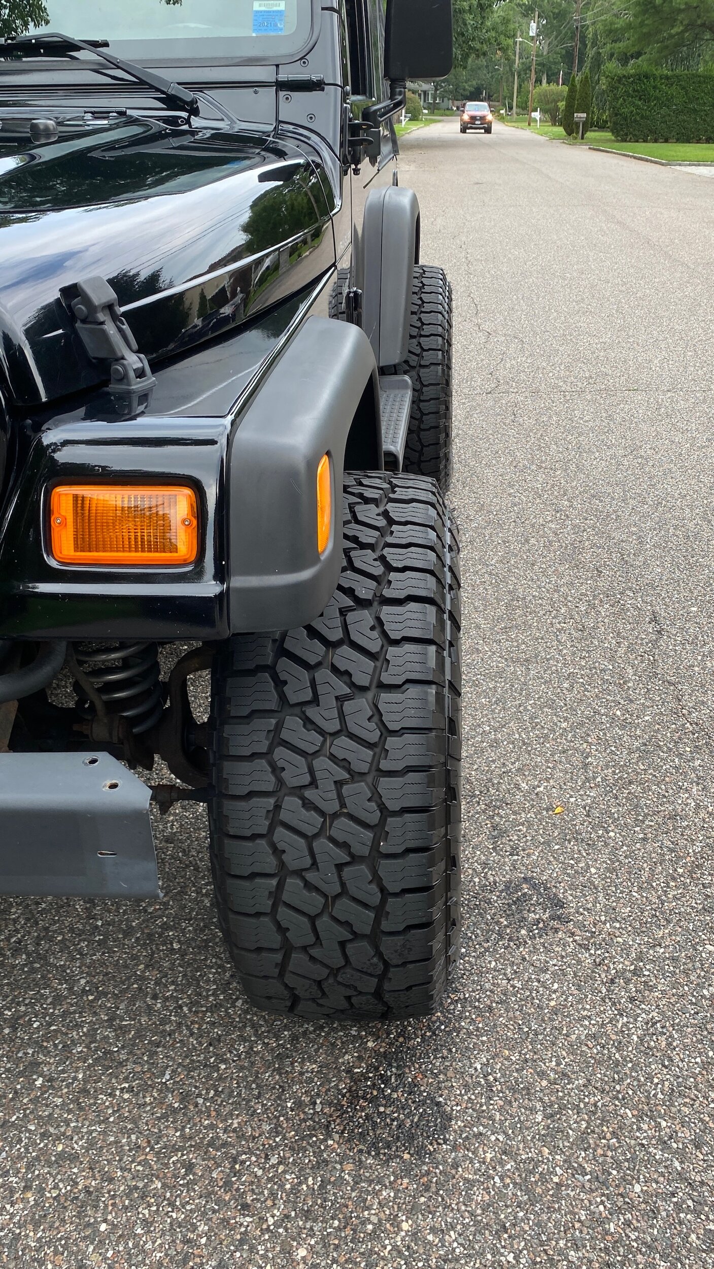

Are you trying to keep the tires within the flares without any poke? Backspacing of 3.75” will probably stick out a bit unless you have extremely narrow tires.
Here’s mine with 33x10.5x15 tires on 3.75” backspacing wheels with Rubicon flares:
Reactions: Sayantsi

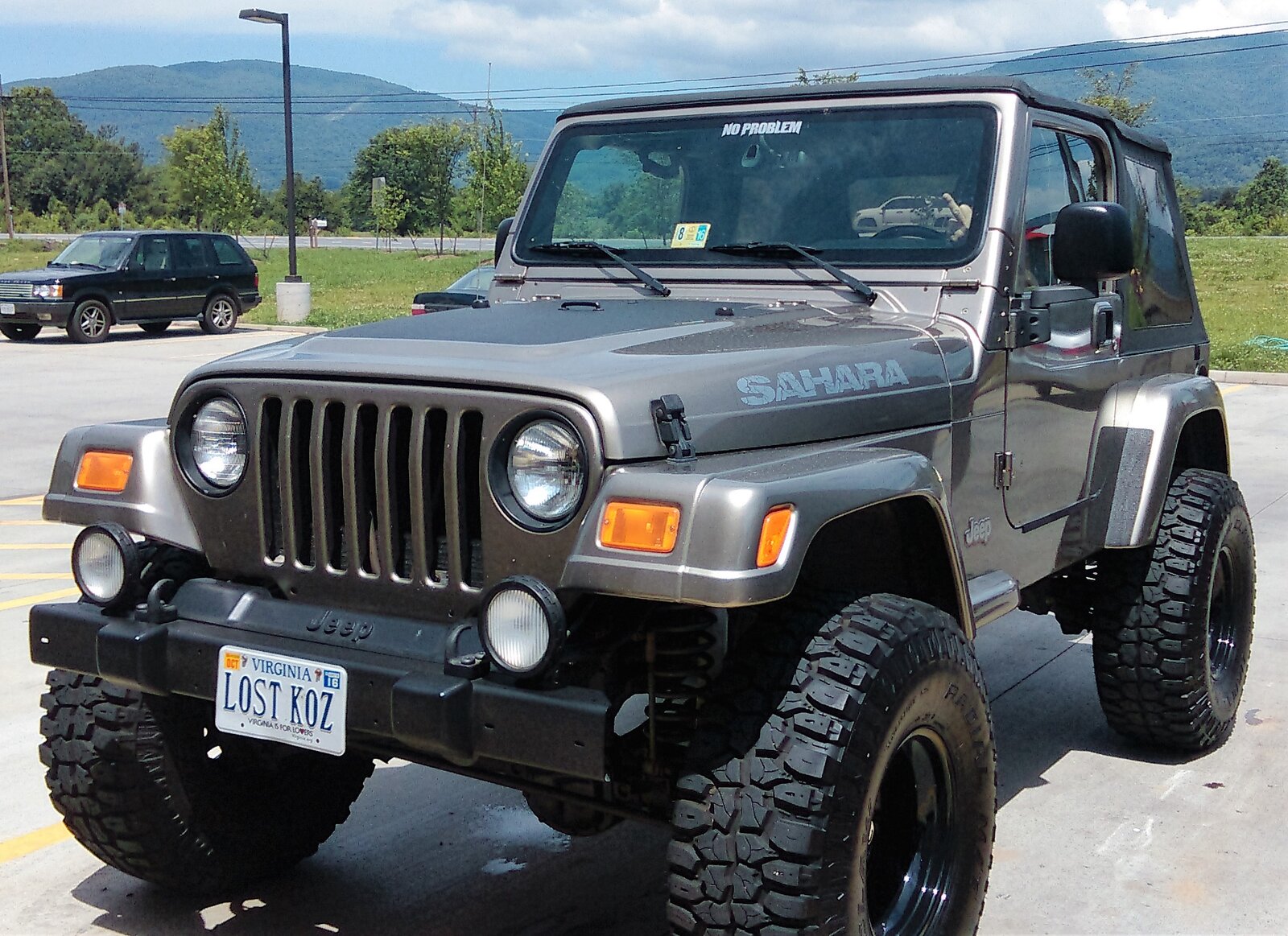

ProComp 69's. 15x10. 3.75" Backspace.
Falken Wildpeaks, 33x12.5
2.5" SL
They extended far beyond the stock flares and I'd say would still extend past the wider Sahara/Rubi width flares. Too far for me...
Reactions: Sayantsi
