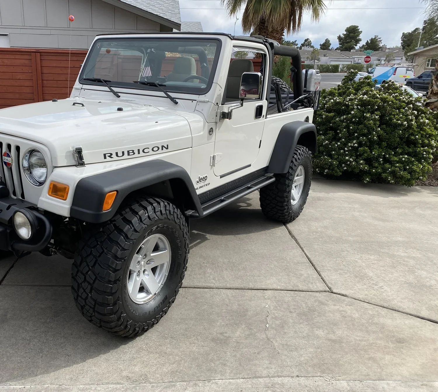

I went with RC 5.5" flares on my Rubicon. Didn't quite cover my tires. ;)
