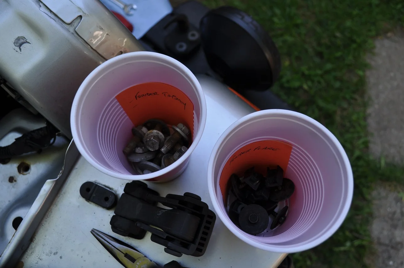

Looking at your location, I assume you will have rust. Use penetrating oil repeatedly for days in advance of the procedure. I suggest having spray paint on hand and clean and paint as much of the engine bay and engine as you can. Make it pretty. If you need to do exhaust manifold or gasket work, it is a good time to do it. Good time to make new battery cables and clean up wiring as well. You may want to use nutserts to reinstall the fender flares. I replaced my right fender on my rust-free 2003 and it was an easy job. The only hiccup is my battery temp sensor quit a couple weeks later and threw a code. I do not tolerate a CEL coming on. I assume it was fron unplugging it and then plugging it back in. I replaced it and restored karma. Have beer on hand. As you are Canadian, might I suggest Grizzly Beer? Do they still make Grizzly Beer? It is not safe to do this job if your hops and barley levels are depleted.

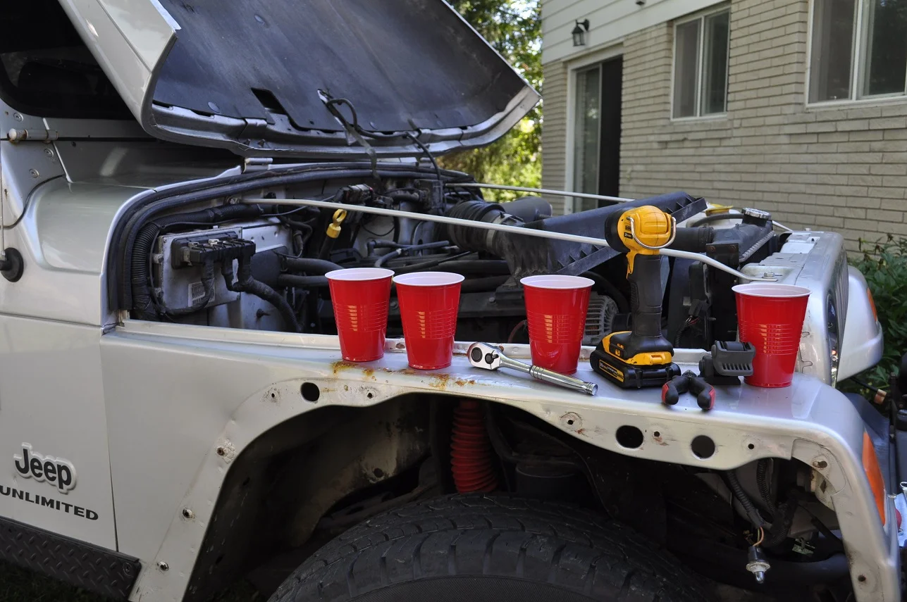

Solo cups ... lots of solo cups. Hopefully enough for lots of beer when you're done.

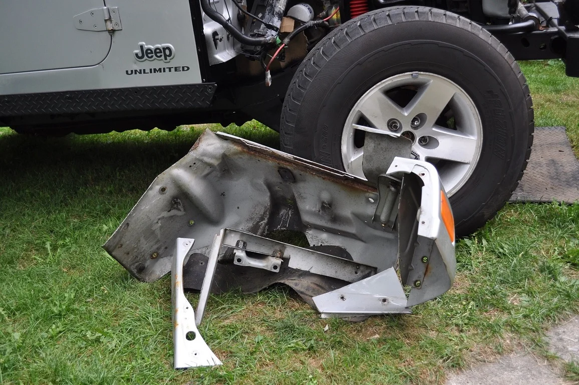

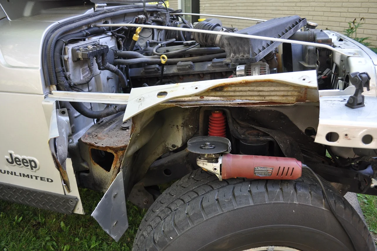

I broke the bottom bolt on both fenders where they attach to the tub, drilled and tapped for new (different size) bolts. Broke most of the bolts at the front where it attaches to the grill, drill and tap.
Ha Ha, I thought those solo cups were filled with beer. I guess you could fill 'em all with Beer before you start, THEN use them to hold the replacement screws (takes longer, but more fun, and who knows you may have some parts left over ;))
