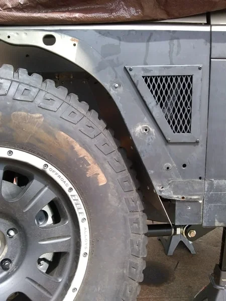

35" wheels homemade HL's and GR inners
the wheels 7" off the ground. see the fender i raised and the bottom fold i flatted out (my patch is missing i'm doing some rework). the span at the bottom went from 5" to 3.25".

again with the info that the factory fender is 5" wide at the bottom you can look at almost any of the fenders and have a fair idea of the real room they move the back wall.
a fender that gives an extra 4" up in the top corner until we run square wheels it's moot. it's that bottom foot up that's the key area.
this all needs done by cycling the suspension. lift height and link length will have differing effects.
