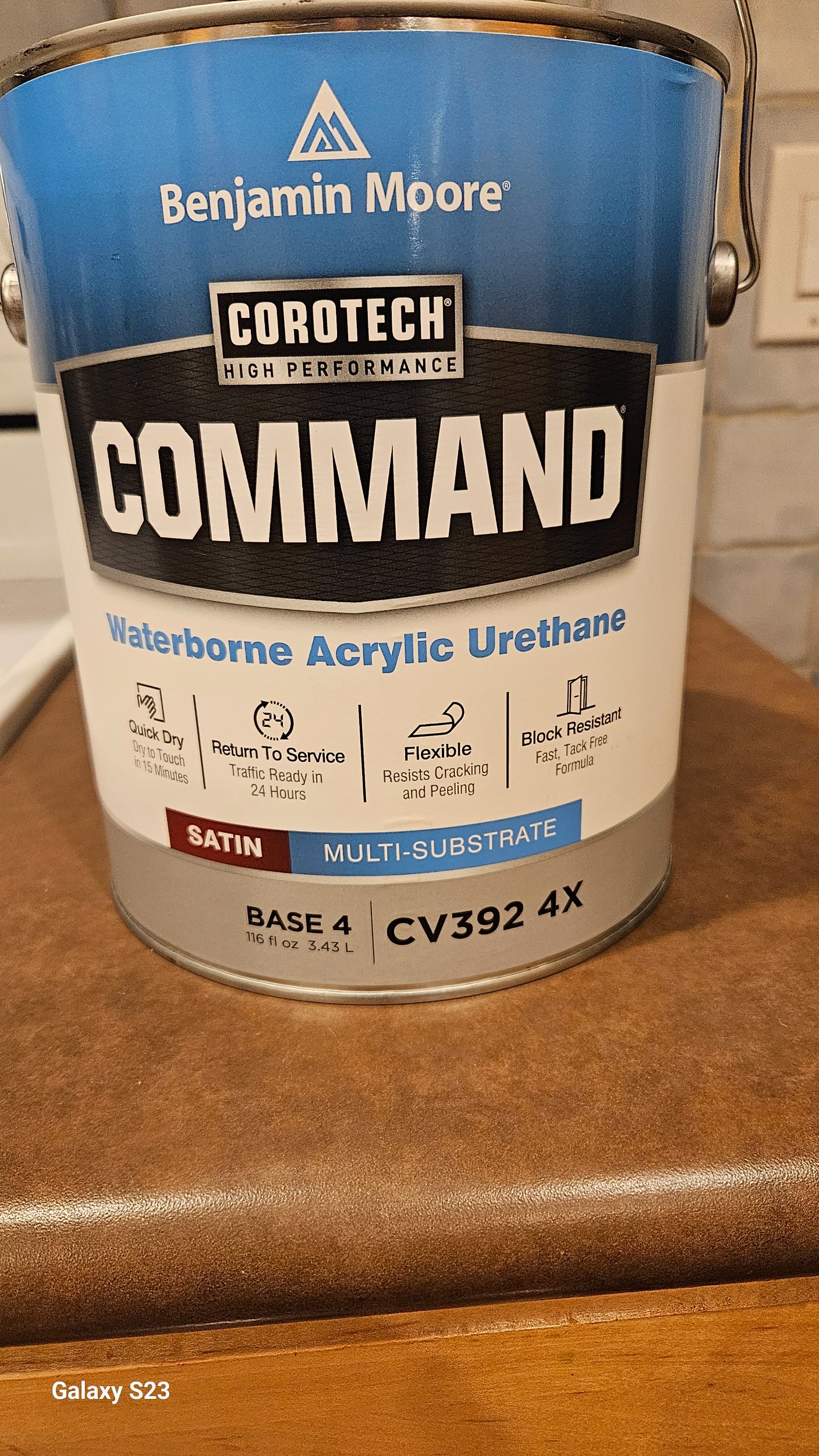

Chiming in on hardtop painting because I'm also in the tri-state area and have been researching it myself (need a spice hardtop painted to match the dark tan ("carmel"/VK9 color code) hard uppers (which match the soft top). Was planning on doing it myself with spray cans or spray gun but I don't have a heated garage and missed the window of warmer weather. The color matched spray cans are also super expensive (I did get one to make sure of the color) so figured I would shop around for a cheap paint job since the rear glass is still out.
I went to three different body shops and explained: it's 24-year-old car and a 27-year-old top. Don't need the tiny chips fixed. It's not a daily driver. It won't sit in the sun; hardtop is only on in winter so it doesn't need massive UV protection. It's garage-kept. But it *does* need to be color-matched (there is no SEM match for dark tan).
Shop #1: Gotcha, quick & dirty, can match the color, will mask off glass & vents, $750.
Shop #2: Wouldn't touch it unless they could "do it right" - taking the glass out, fixing the scratches, (which I respect, but no way I'll risk messing with the gaskets). $1500-2000.
Shop #3: most thorough guy, but..."you need primer, need UV protectant, you need a topcoat", $650, plus 2 quarts of paint, which would cost...wait for it...$613 🤣 "with his discount" (and no I didn't mis-hear him, he wrote it down).
So I got more help on this forum and looked into PPG paint, which brought me to Aboff's. Spoke to a knowledgeable guy who recommended this stuff, apparently it's also suitable for the canvas on the uppers. He color matched my spray can sample perfectly. Only downside is the minimum order was a gallon but it was all of $72 😀. Neighbor across the street (who works on classic cars) has a heated garage and offered to spray it for me. I'll post pics when it's done. Hope this helps.
(And you can totally spray a bumper yourself!!! I really like the "hammered" black finish.)
