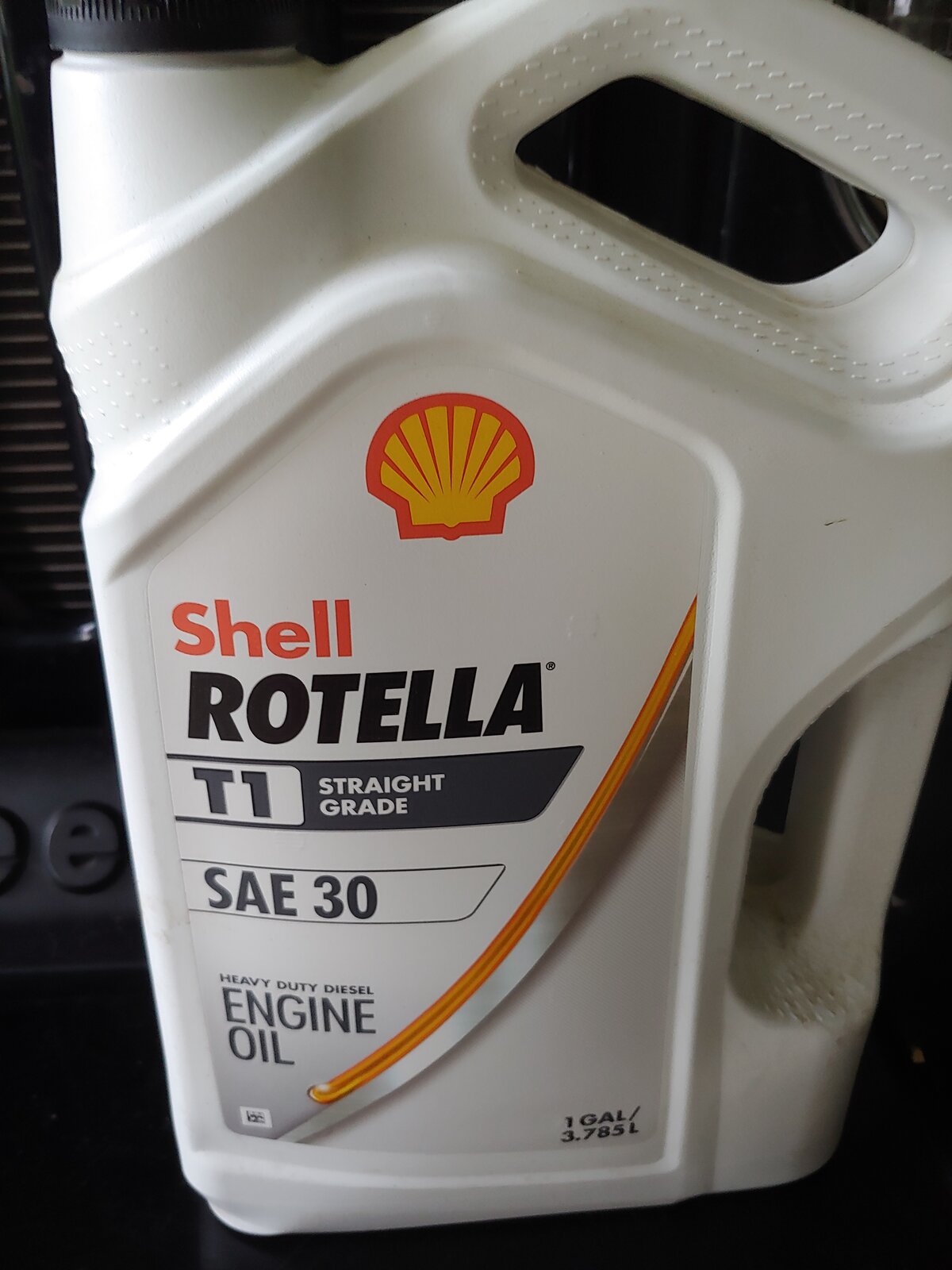

I bought a 4.0 from titan 2 years ago, the engine has held up fine. I drove down and got it to save shipping. I've used a strait 30 weight diesel oil since I got it.

That's the oil they're going to tell you to use in south.

And I've used that oil for over 2 years and 12,000 miles.

Thanks so Much. The picture helps. I’m going to look around here to see availability. So I take it you still have your Jeep with this engine? This was all good information.
