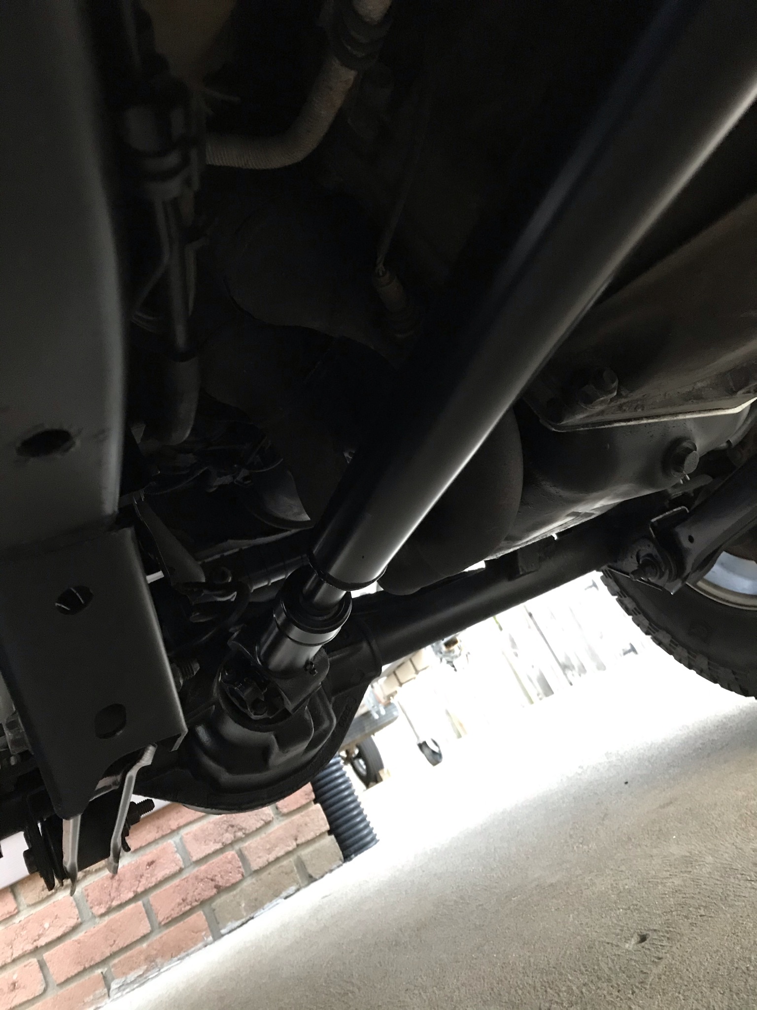

Finally got the TJ undercoated. Rust inhibiting semi gloss black, with woolwax on top. Pictures here are just the paint, I'll need to upload the woolwax coating.

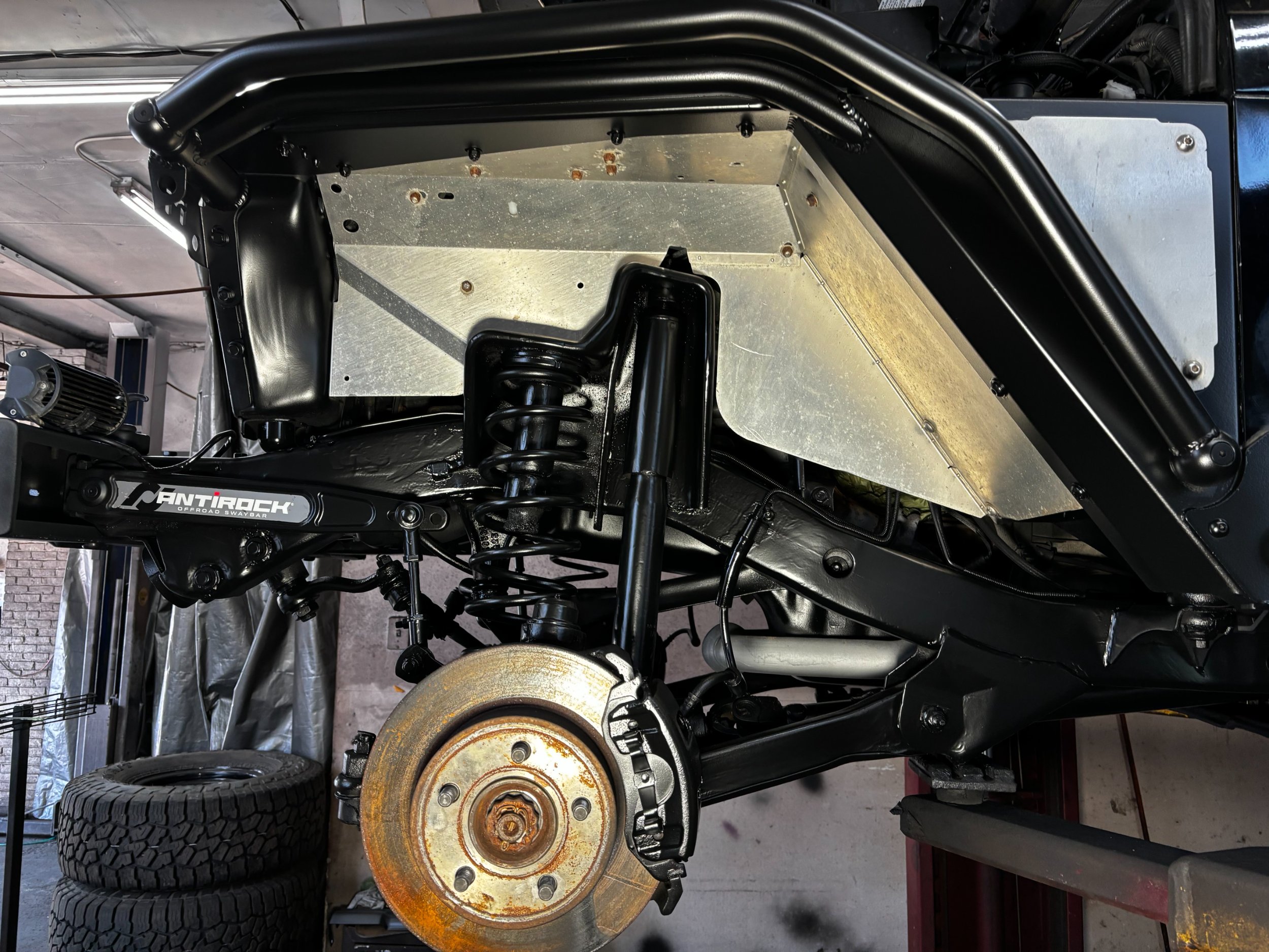

I’m actually having the same treatment done to mine late next week at a shop here in NE Ohio.
They drop the suspension components to enable them to get the entire frame.
Having the underside of the body pan done also.
Gotta keep it protected.
If you don't mind me asking, what kind of $$ are involved with this procedure?
$1200 - $1500 as I’m having the pan done also. Full suspension disassembly, total cleaning, and finished with a satin finished rust preventive paint. 3-4 day time frame.
Well worth the investment as I will be driving it this winter.
