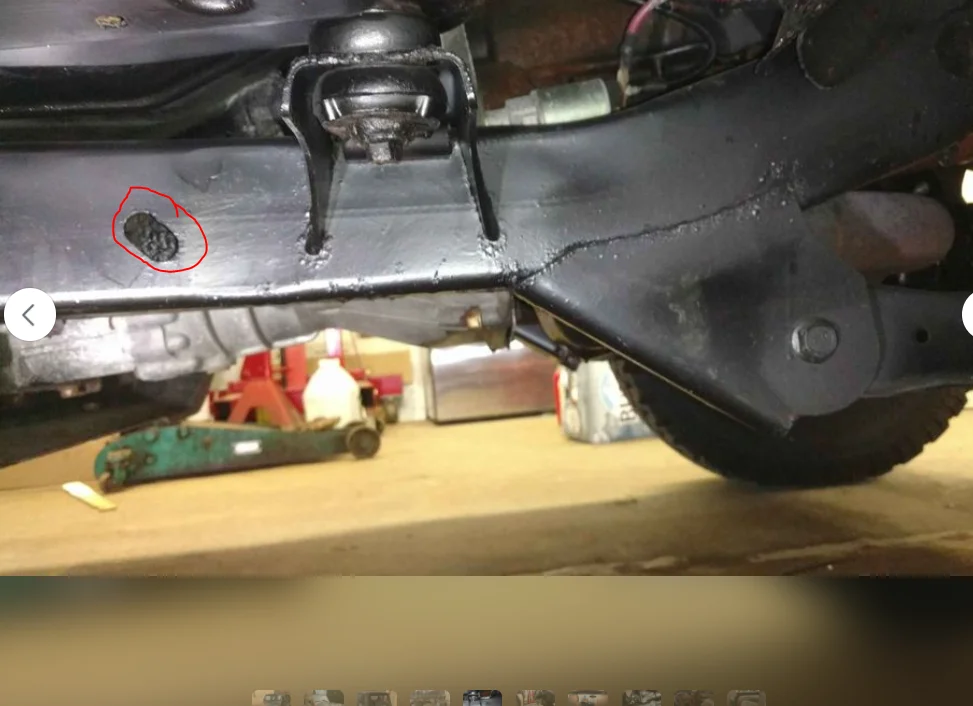

The way you can tell there is a lot more rust than perhaps you want to deal with is given in at least 3 places. The two pics of the underside show fresh paint with no masking of bolts or body mounts plus the bubbling at the edges of frame openings. The second glaring clue is the mention of swapping out brake lines for SS. That means the OEM ones rusted to crap and failed.
That and you can see some bubbles of rust inside the frame. I'd inspect in person and get my head under it.
For the price and mileage, something is definitely wrong with it. I see internal rust covered up. I'd check it out in person anyway.
See, that's why I asked! Would you consider this to be dealbreaker rust or just something to be wary of? I know a lot of these can have some scaling near the frame holes but knowing that the brake lines probably rusted through kinda freaks me out. Seems like it may end up an uphill rust chasing battle that isn't worth it.

Having seen many Va Jeeps with rust, only you can look and determine how bad it is. It's always way worse internally IMO. The low price and mileage makes me think it's much worse than the pics.

For someone like you it isn't. For someone just looking for a decent Jeep to drive without major work, that could be another $3,000+ where I live. PA is a horrible rust belt state. I bought my first XJ from there. Never again.
And had I said it wasn't worth it to swap out a frame if that is the worst of it, there would be 10 fucks in here giving me shit because they swap them out in their sleep.

Here is how to win every time with rust- walk away. It is almost always worse than it appears, the repairs delay the enjoyment, to me I would not feel as good about the purchase (whatever that means) and it de values the vehicle monetarily- TJ frames are known to rust badly and there are so many non rusted ones that cost less to find than fixing a rusted one.
