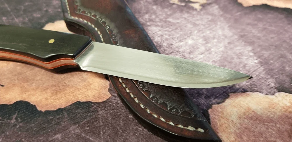

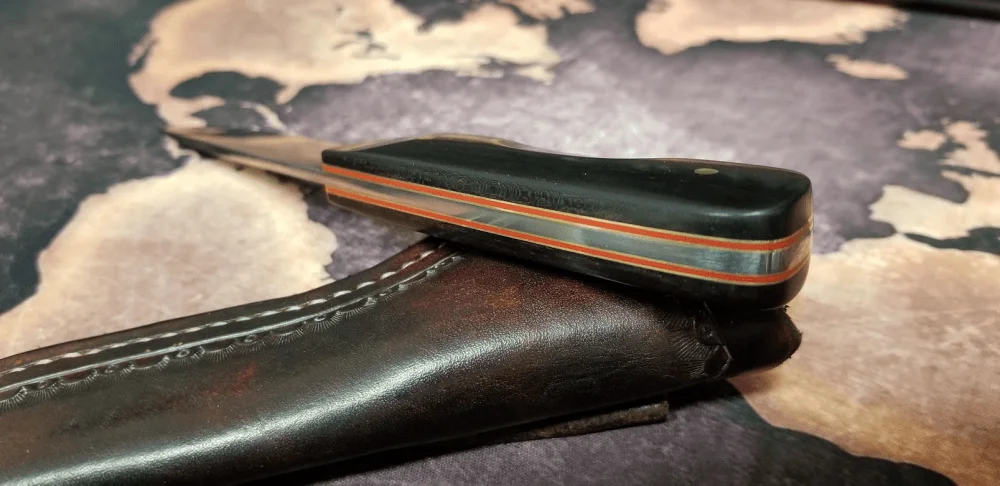

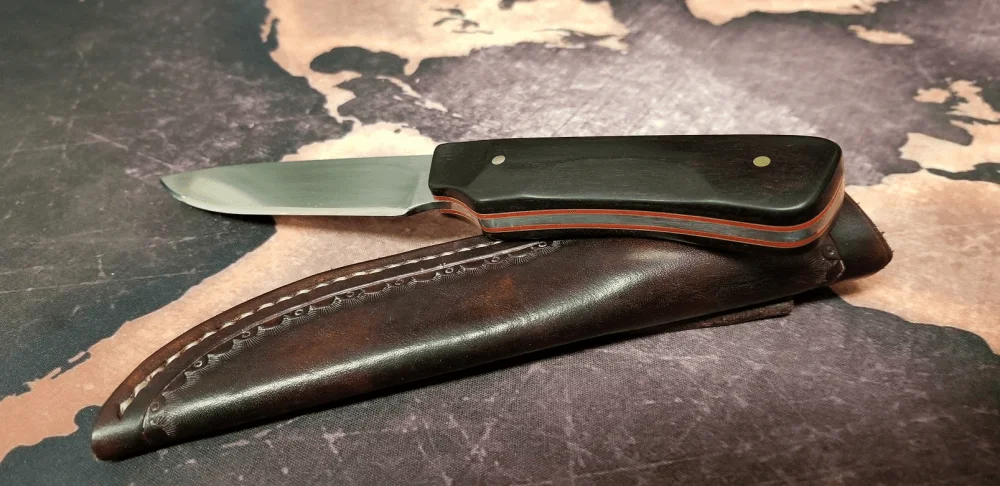

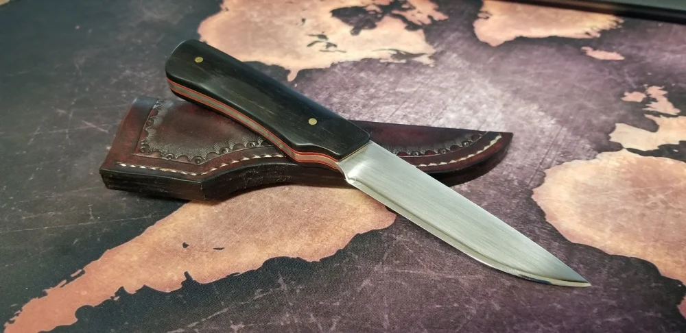

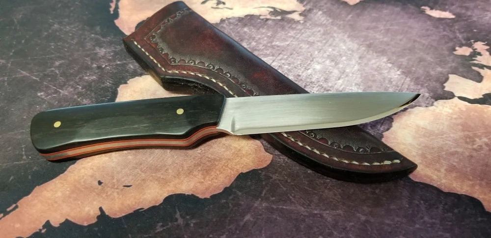

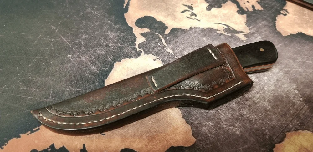

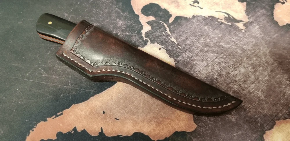

Finished a knife
I've been working on this off and on for a while now, figured I'd share it with you guys as well. I started it around xmas of last year with some others that I made for gifts. I'd kind of like to redo the sheath but it will take a while to build the ambition to do it over again even though it doesn't take that long.
Knife specifications:
O/A length: 7 3/8"
Blade length (sharpened): 3 1/2"
Blade thickness: 0.106" at thickest part of spine
Blade height: 0.825"
Blade material: O1 Steel (probably 58-60 RC)
Handle length: 3 5/8"
Handle thickness: 0.640"
Handle height: 0.932"
Handle Material: 0.010 brass shim stock, .030 red micarta, Gaboon ebony, 0.125" brass pins

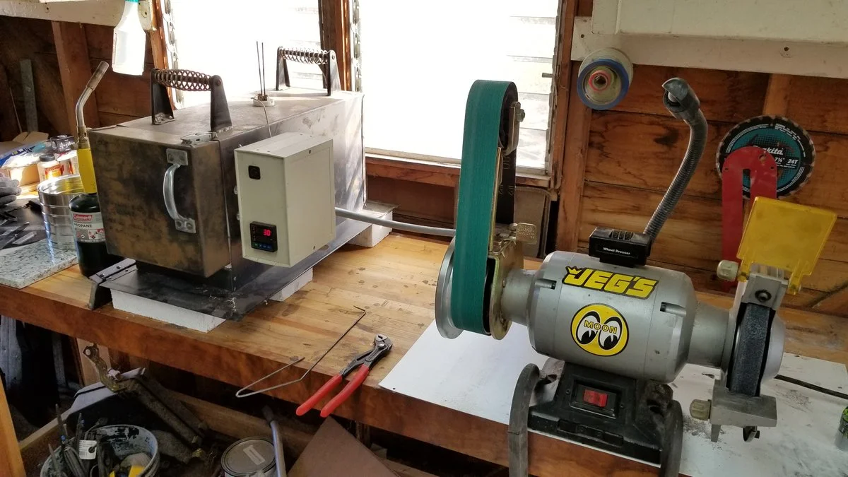

Really nice, my sons been making knives for a few years too.
Heres the first firing of his home bilt propane tank forge.
