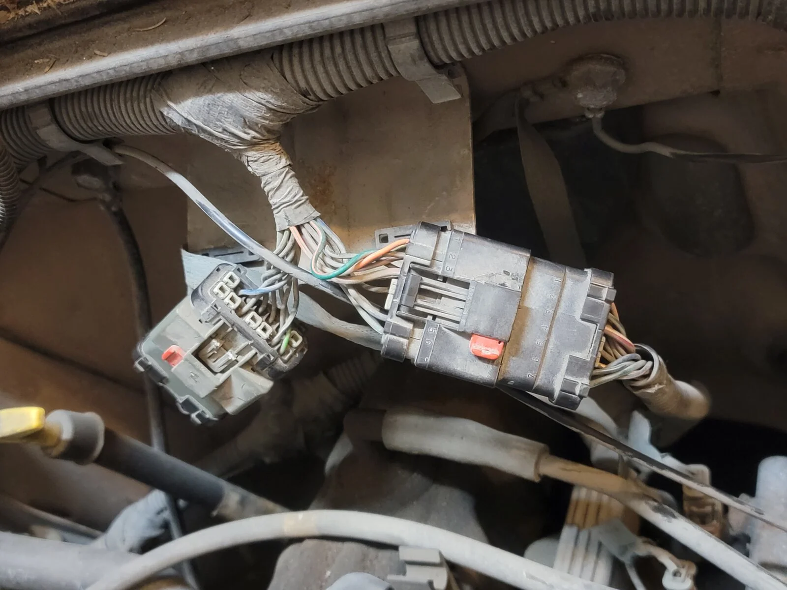

Is there a trick to disconnectig the wiring connectors at the top center of the firewall on a 99 tj? I'm taking the body off to work on the frame over the winter and these really don't want to come apart. Figured I'd get some input before getting too aggressive.

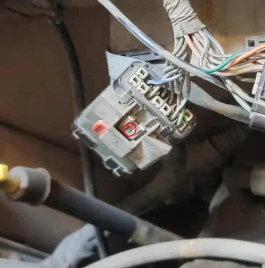

The red tab shown in the photo is in the unlocked position. Now, all you need to do is press down on the black tab that is behind the red lock and pull them apart.
