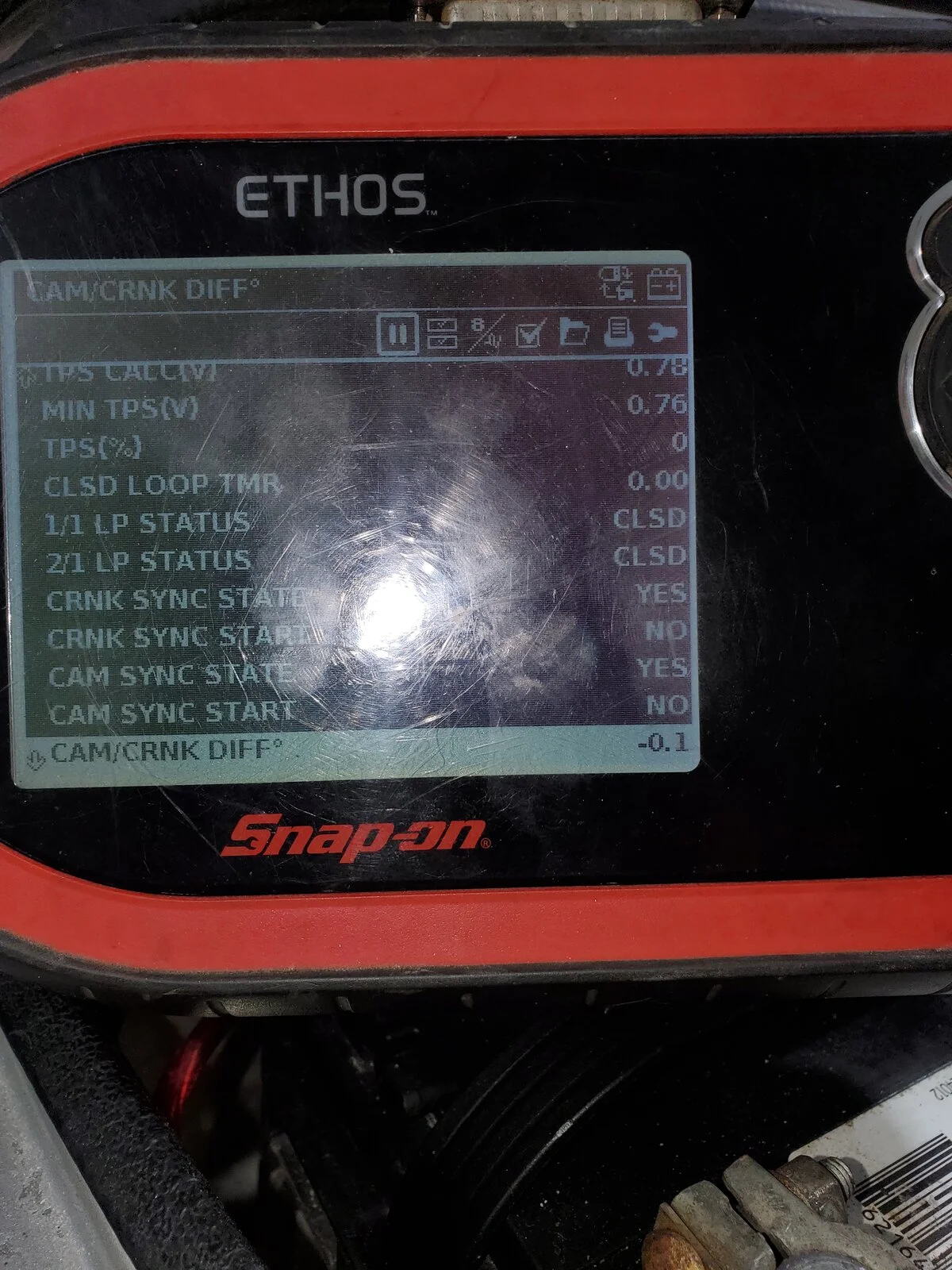

I rook it to the dealership and they performed the tsb (at their expense). It's been about 600 miles and I still get the ten flashes. No codes. My snap on ethos tool hooks up and I can run full diagnoses with it (Had to change OPDA.). Just as a side note, you can see the cam/crank degree correlation ° with this tool. Adjusted to 0°. What am I missing here?

Bought the obd device used. Tried it on my 2016 dodge caravan without success as well. I betting you are correct in the statement that the device may be bad.
