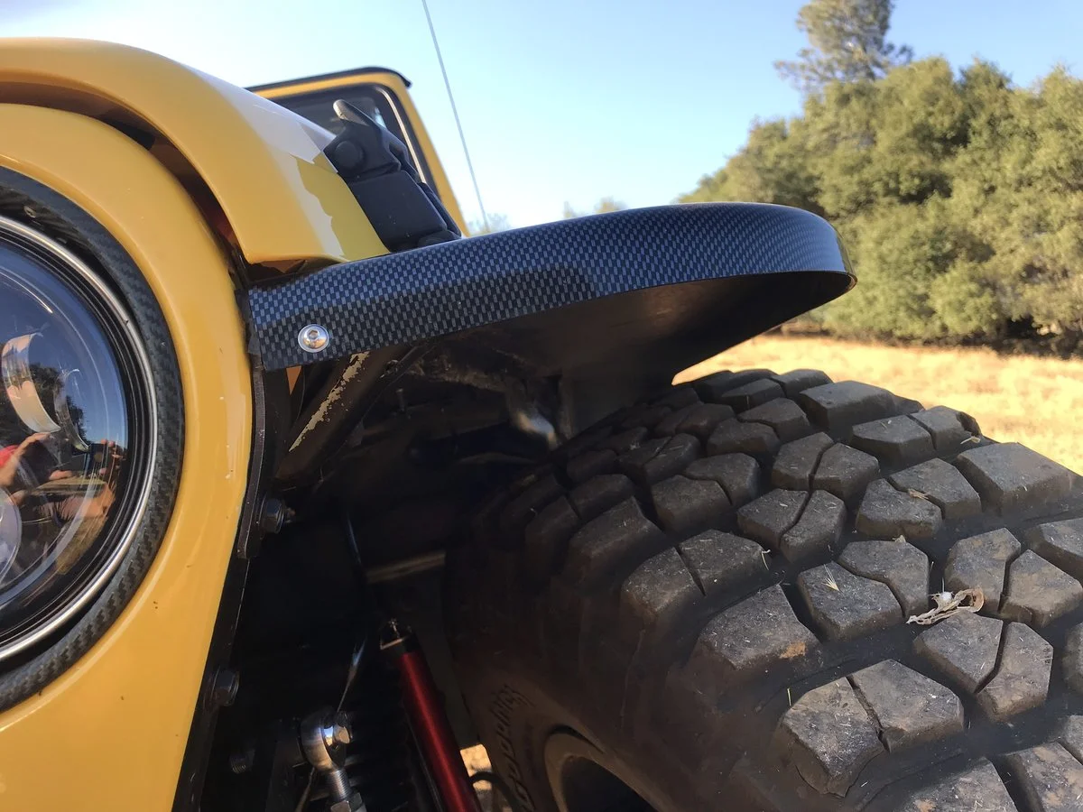

On mine there’s nothing there to contact.

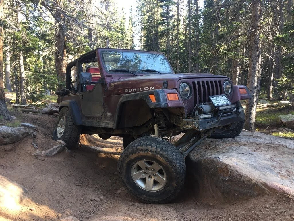

Those are MCE flares. Not quite your typical flat fender. Though your tires still contact the rear wall at full flex full lock unless the bump stop extension prevents that.
Describe the position and what I’m doing that will get me into the rear of my fenders besides trying to flip my jeep over

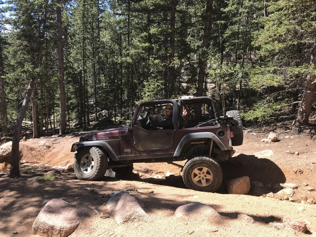

Something like this. If mine has 35s and the same bump stops after raising the shocks, the driver's side would be mashed hard into the rear wall.
Wheels turned from the opposite side, but this shows the tire is very well stuffed.
MCE Flat Fenders not flares. What is it you are doing while sitting behind the wheel (steering wheel) that you are at full bump and full lock? If it did rub how hard would it rub? How long would you be in this position before the dynamics would change?
