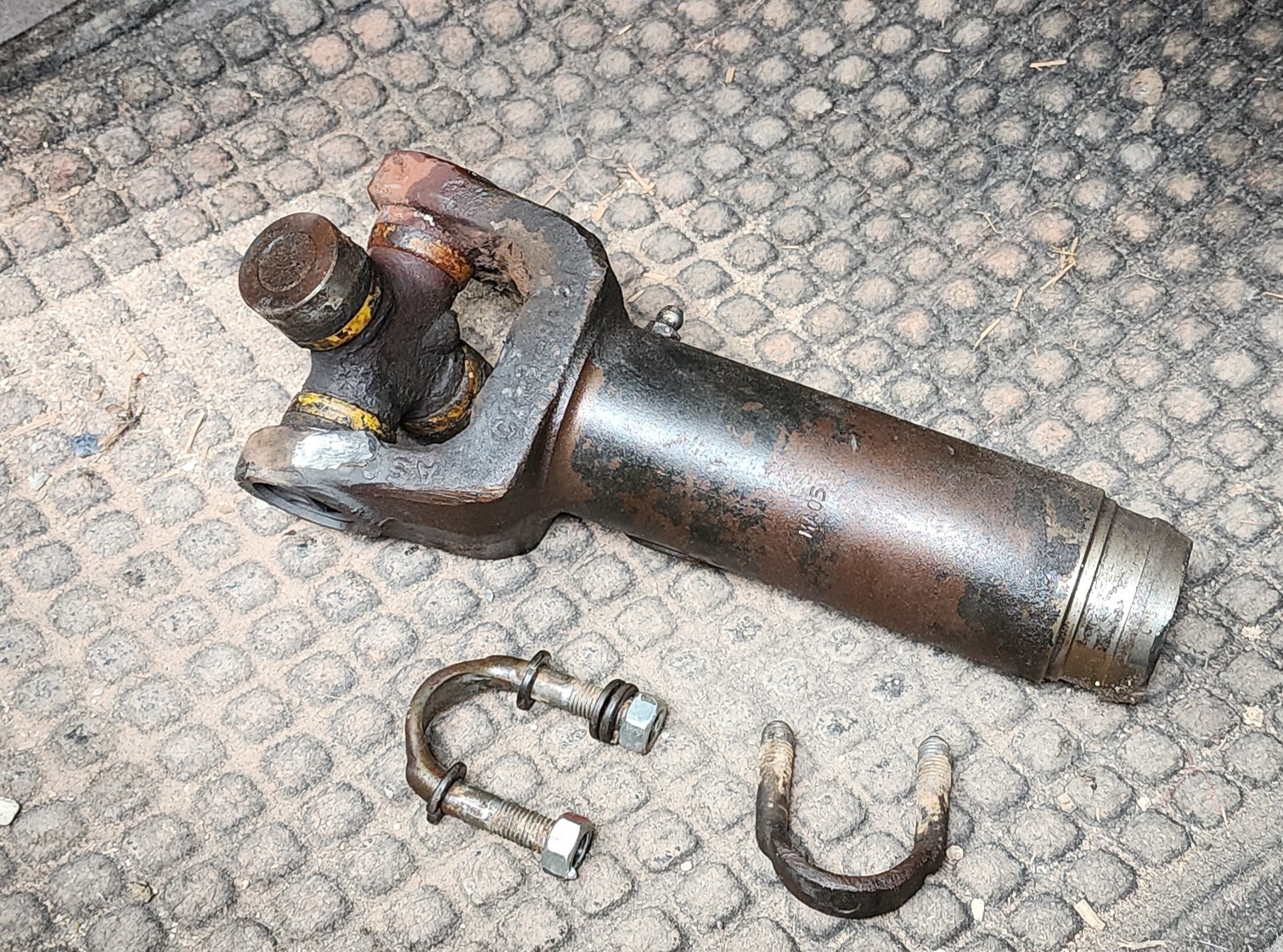

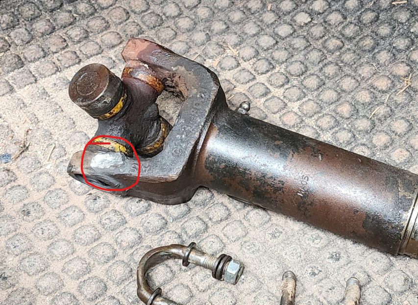

Probably unrelated to the problem being discussed, but what the heck is this?
Was this welded back together at some point?

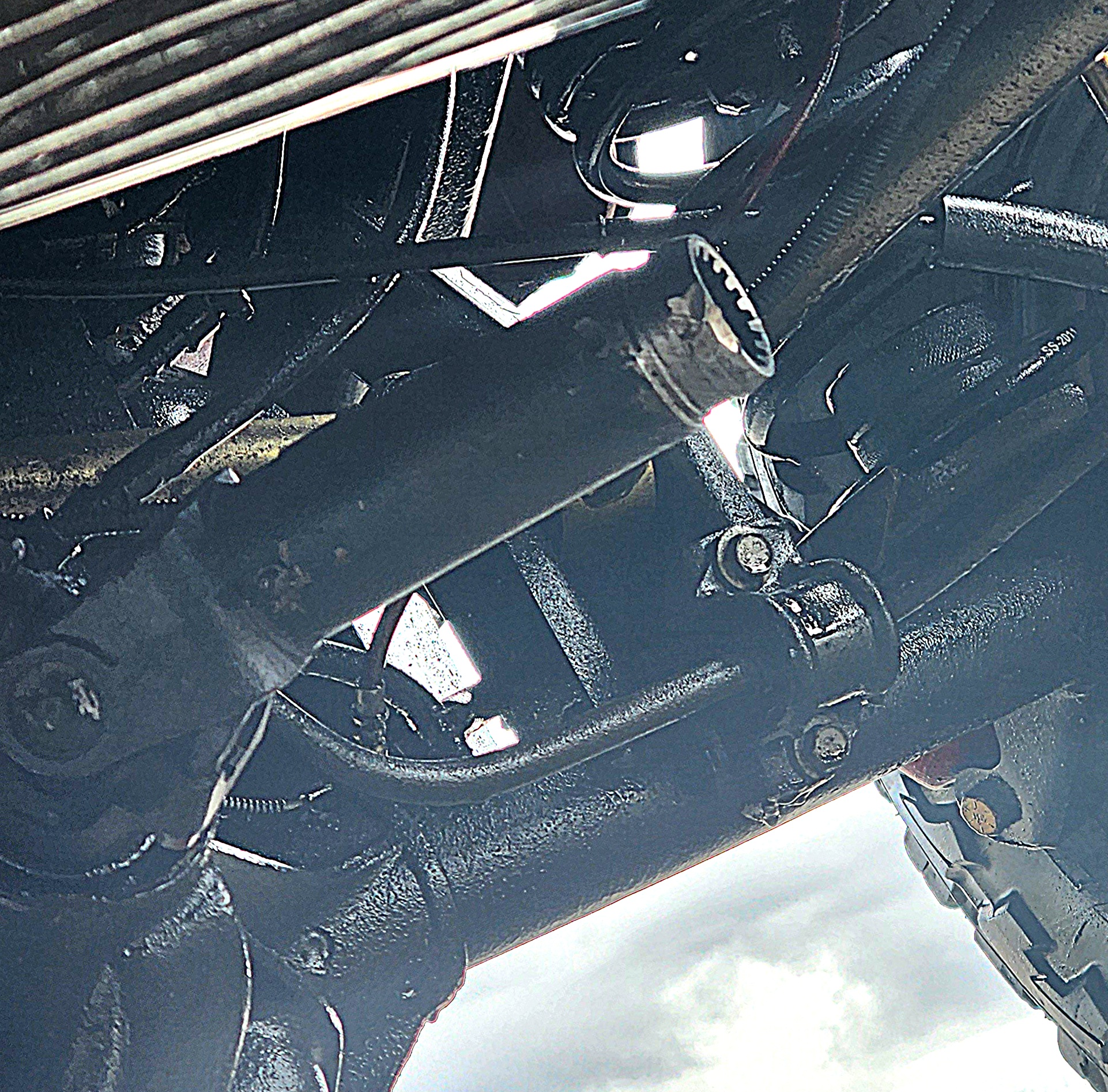

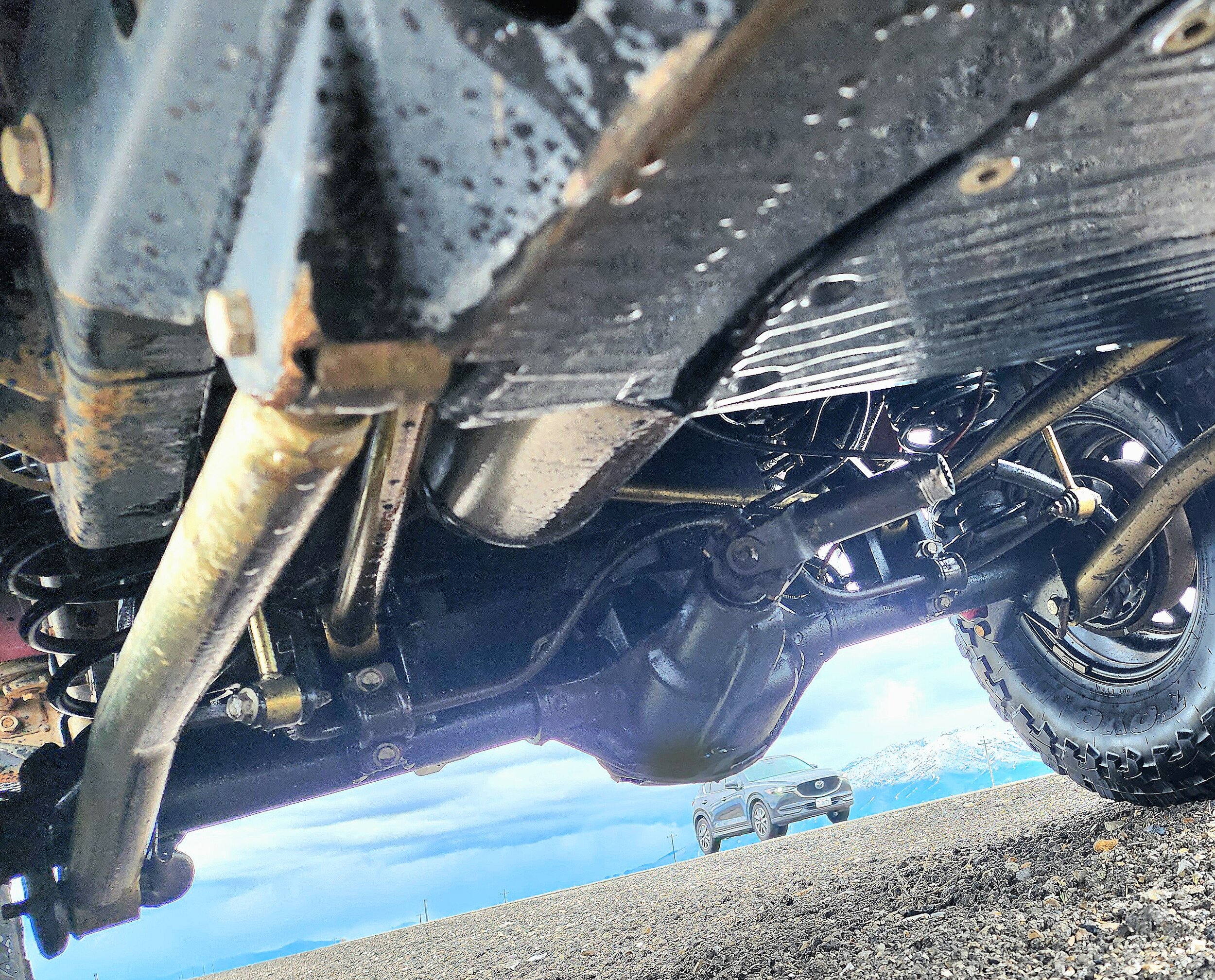

Is it me, or is this not what is seen on TJ's often?
This looks more like the old school CJ drive shaft. It doesn't look to be a Double Cardan or have a Slip Yoke TJ OEM style end, does it?
Each end is a standard U Joint, unless I'm missing something? So it wouldn't be the DC joint seizing.
As a guess, the pinion looks rotated up to point the pinion at the driveshaft. It would be odd to have those arms and not have a SYE of some sort and a DC driveshaft. Purely speculative until we see the t-case.
