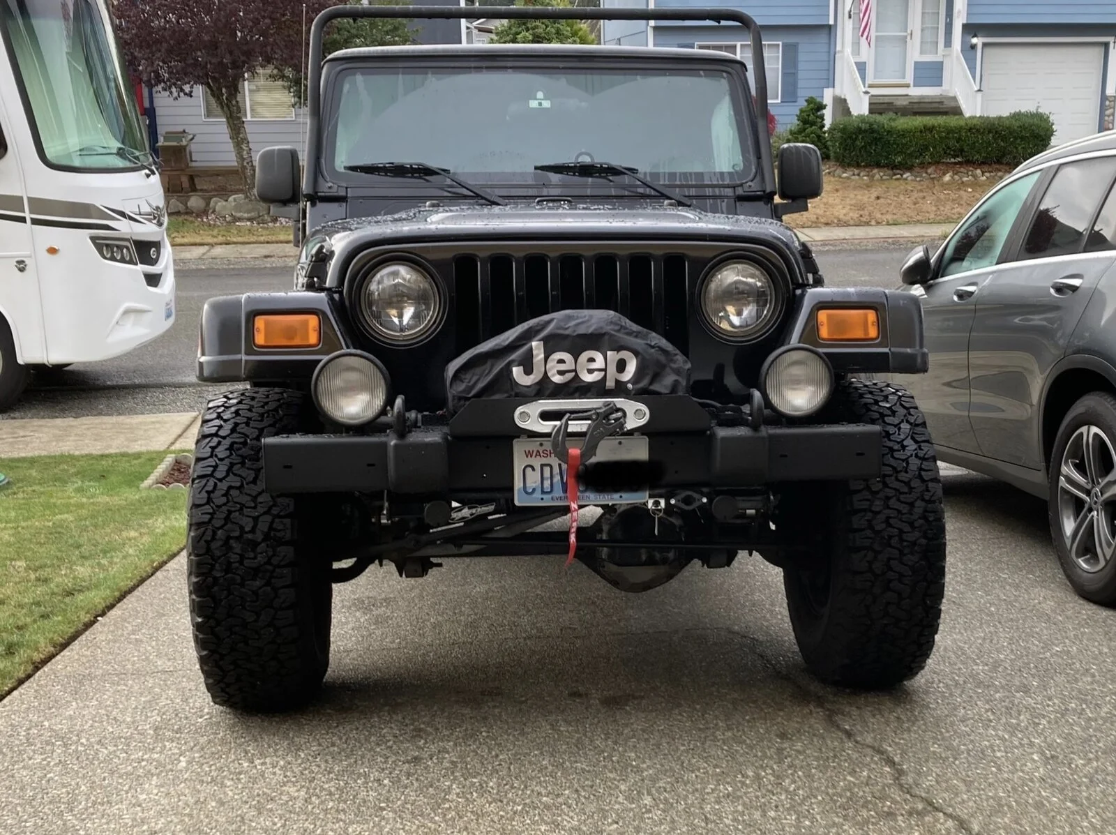

I setup the Turtle to flat tow behind my RV.
Turtle, 2006 Jeep Wrangler LJ Rubicon 6sp
RECREATIONAL TOWING
NOTE: The transfer case must be shifted into N (Neutral) for recreational to prevent damage to internal parts.
1. Depress brake pedal.
2. de- press clutch pedal on manual transmission
3. Shift transfer case lever into N (Neutral).
4. Start engine.
5. Shift manual transmission into gear.
6. Release brake pedal and clutch ensure that there is no vehicle movement.
7. Shut engine off, leave in 3rd gear required to maintain trans lubrication, steering wheel lock position ignition to prevent release parking brake.

I use a RVi 3 braking system. Other popular brands in no particular order are Demco, Roadmaster, Brake Buddy, Blue Ox, and Ready Brake.
This was my shopping list for my flat tow system:
Sourced from e-trailer.com:
Roadmaster High-Low Adapter for Tow Bars - 2" Hitches - 10 1/4" Rise/Drop
11-1/4" Long – 10,000# GTW 400# TW P/N RM-048-10
Roadmaster Falcon All Terrain, Non-Binding Tow Bar
Motorhome Mount - 2" Hitch - 12" shank - 6,000 lbs. P/N RM-522
Adapter for Jeep D-Ring Bumper Mounts to Roadmaster Motor Home Mount Tow Bars
3/4" Thick P/N RM-035
7-Wire to 6-Wire Coiled-to-Straight Cord for Roadmaster Tow Bars
8' Long P/N RM-1676-7
CE Smith Tie-Down Bracket for Boat Trailers
Galvanized Steel - Bolt On, 2 ea., P/N CE26214G
[Used for safety chain attachment points on jeep]
Roadmaster Tow Bar Cover P/N RM-055-3
[Unnecessary, but it allows me to keep the tow bar on the motorhome out of the weather
Sourced on Amazon.com:
Roadmaster 76" Single Hook, Straight Safety Cables
8,000 lbs P/N RM-645-76 [Also available from etrailer.com.]
Sourced on E-Bay:
Previously owned RVi3 Supplemental Brake System with Command Center and 6-tire Tire Patrol.
Sourced locally:
Magnetic Trailer Lights [already on hand in my trailer tow kit]
Hitch pins and clips
Miscellaneous hardware
