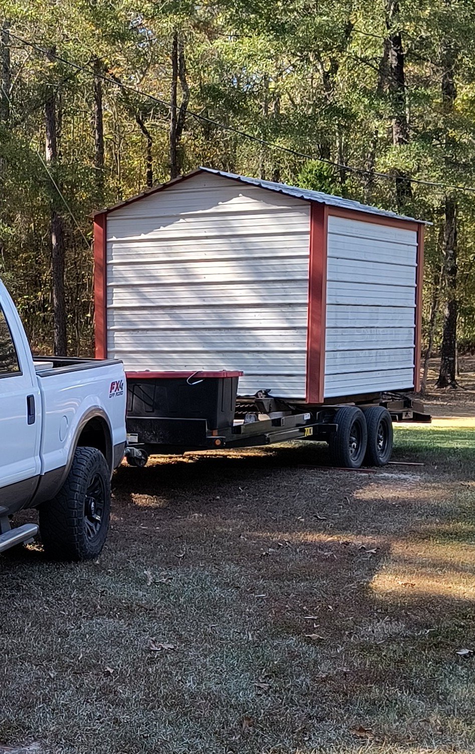

I don’t flat tow any more. I find it easier to trailer, it allows me to bring extra supplies such as firewood and I can bring a broken vehicle back home. Personally I would go with a 10K trailer and go 18’. I question having the tires on the dovetail. Also I prefer to have the hitch mounted on a C-channel because it gives more options for height adjustment and hitch type. You’ll find other uses for a trailer once you get one.

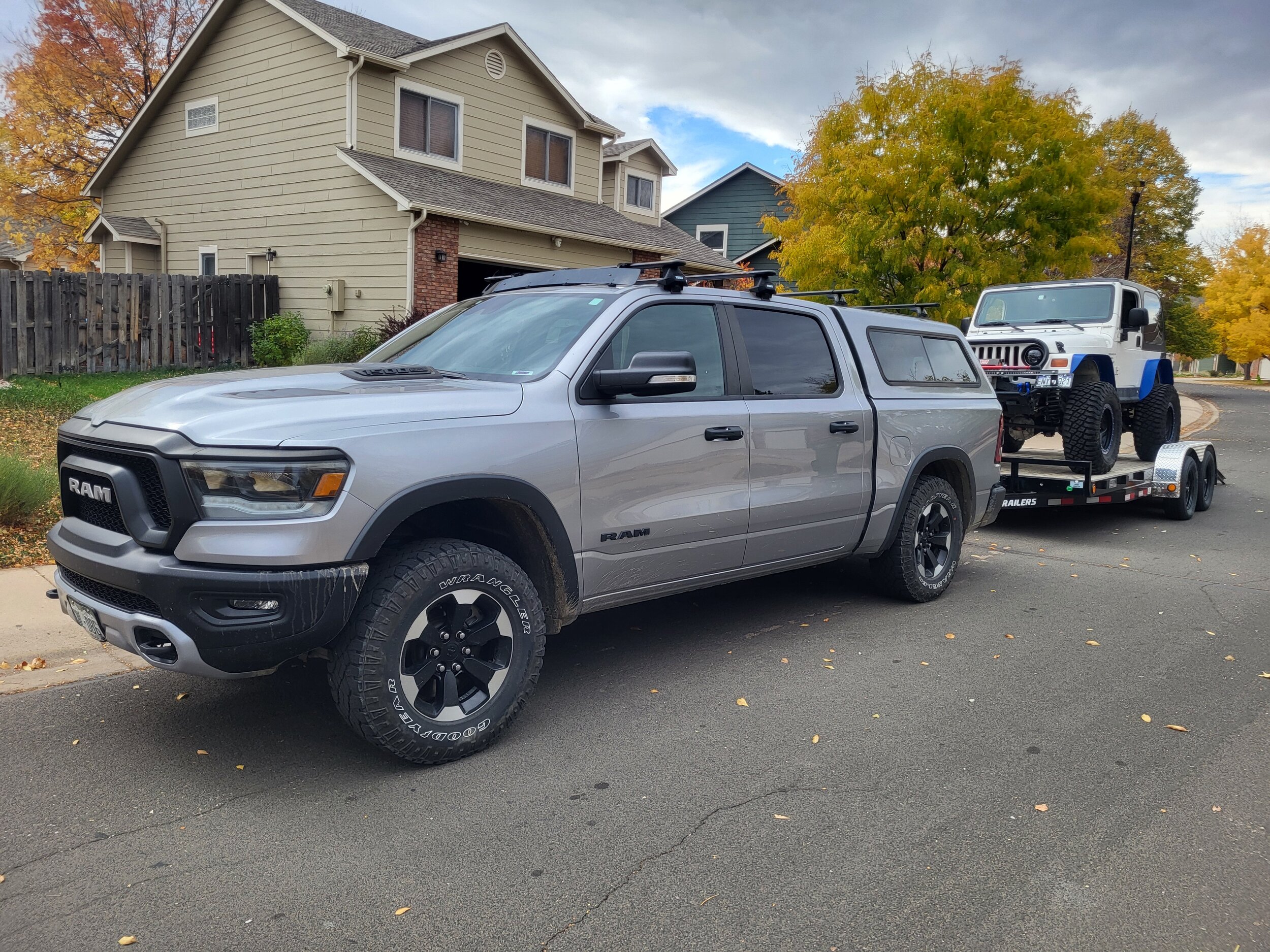

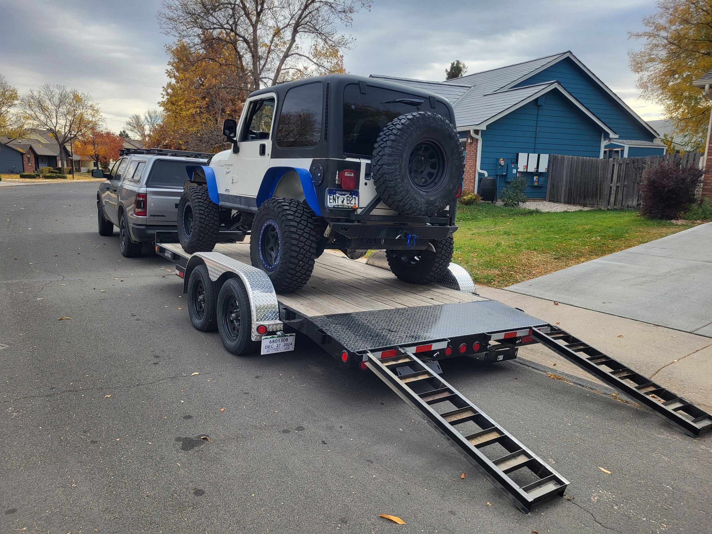

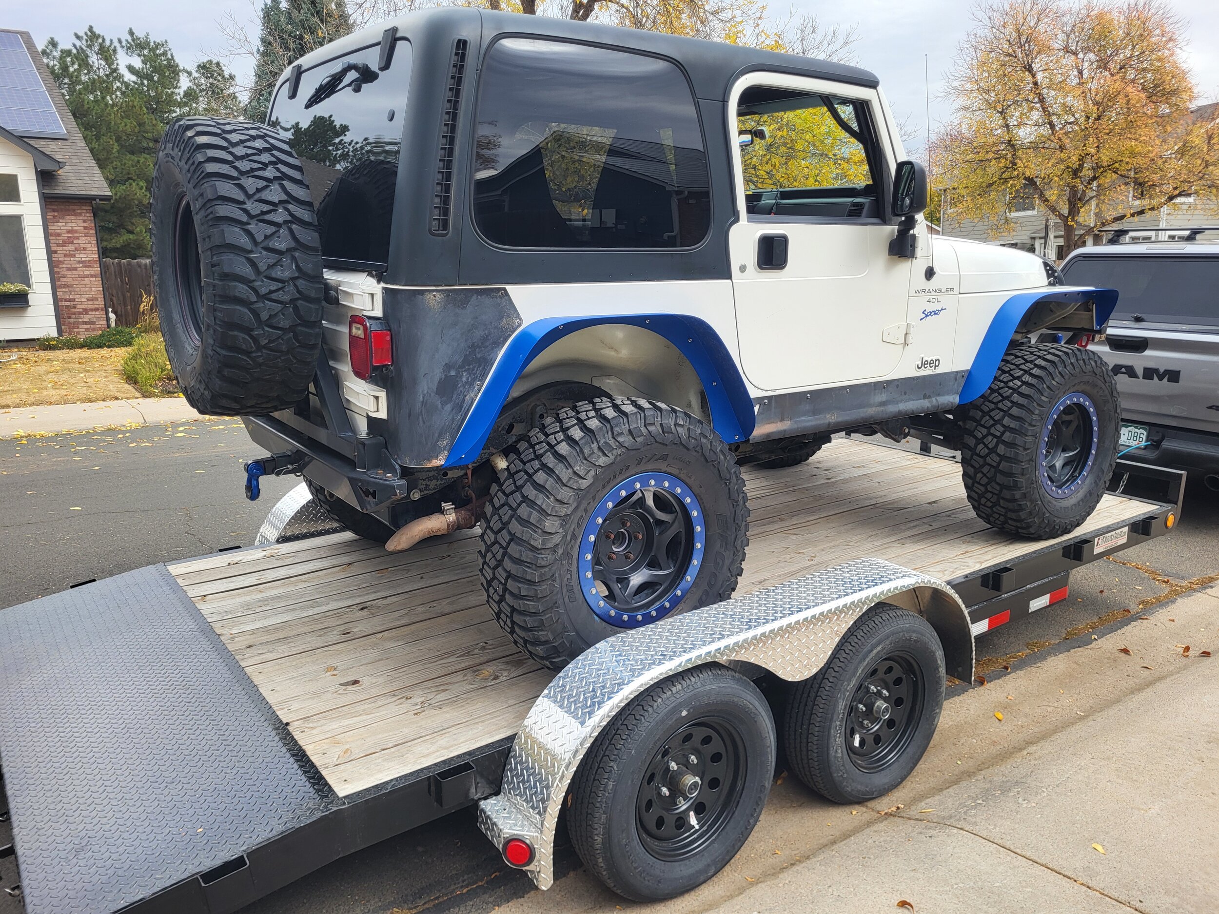

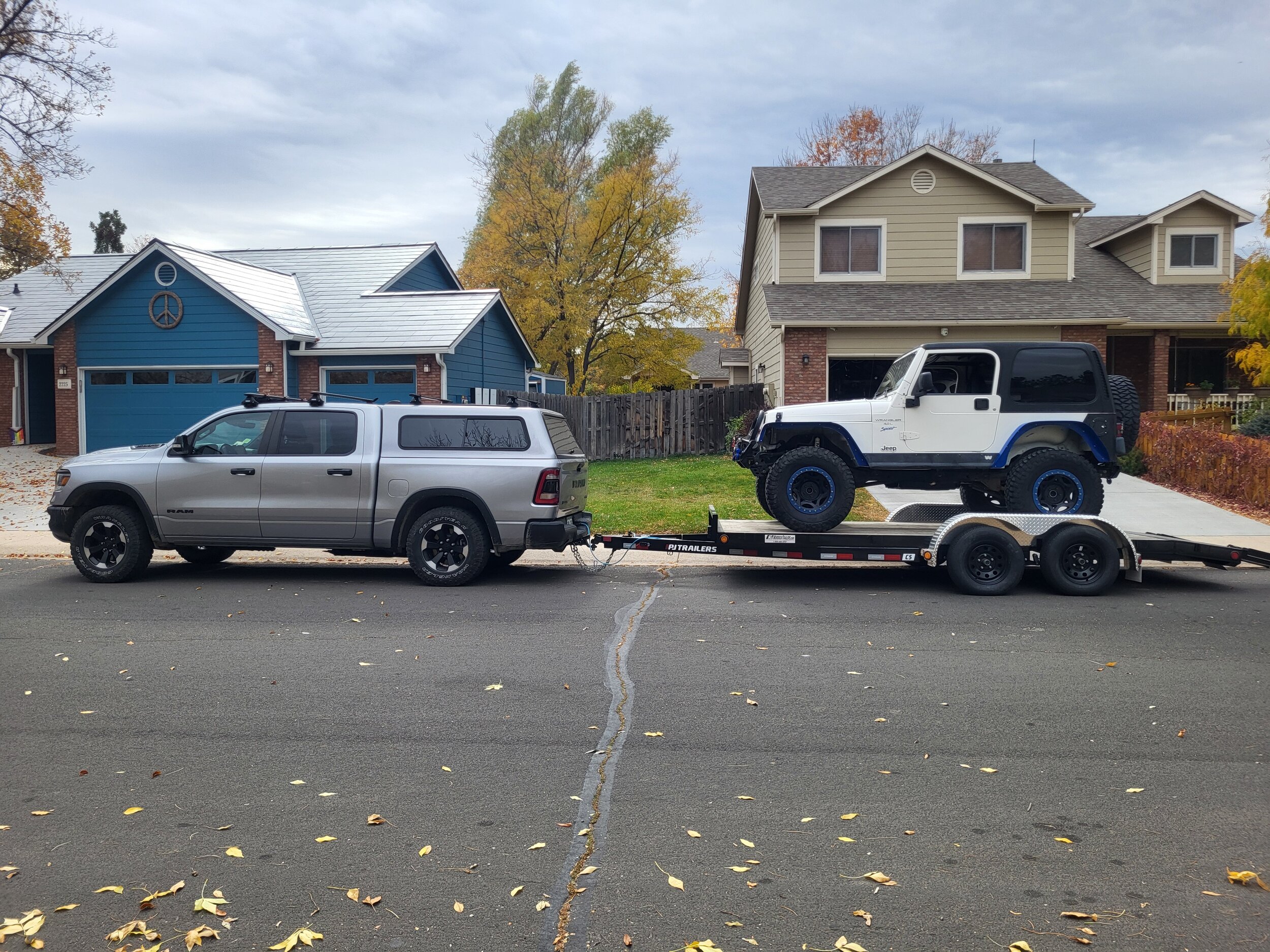

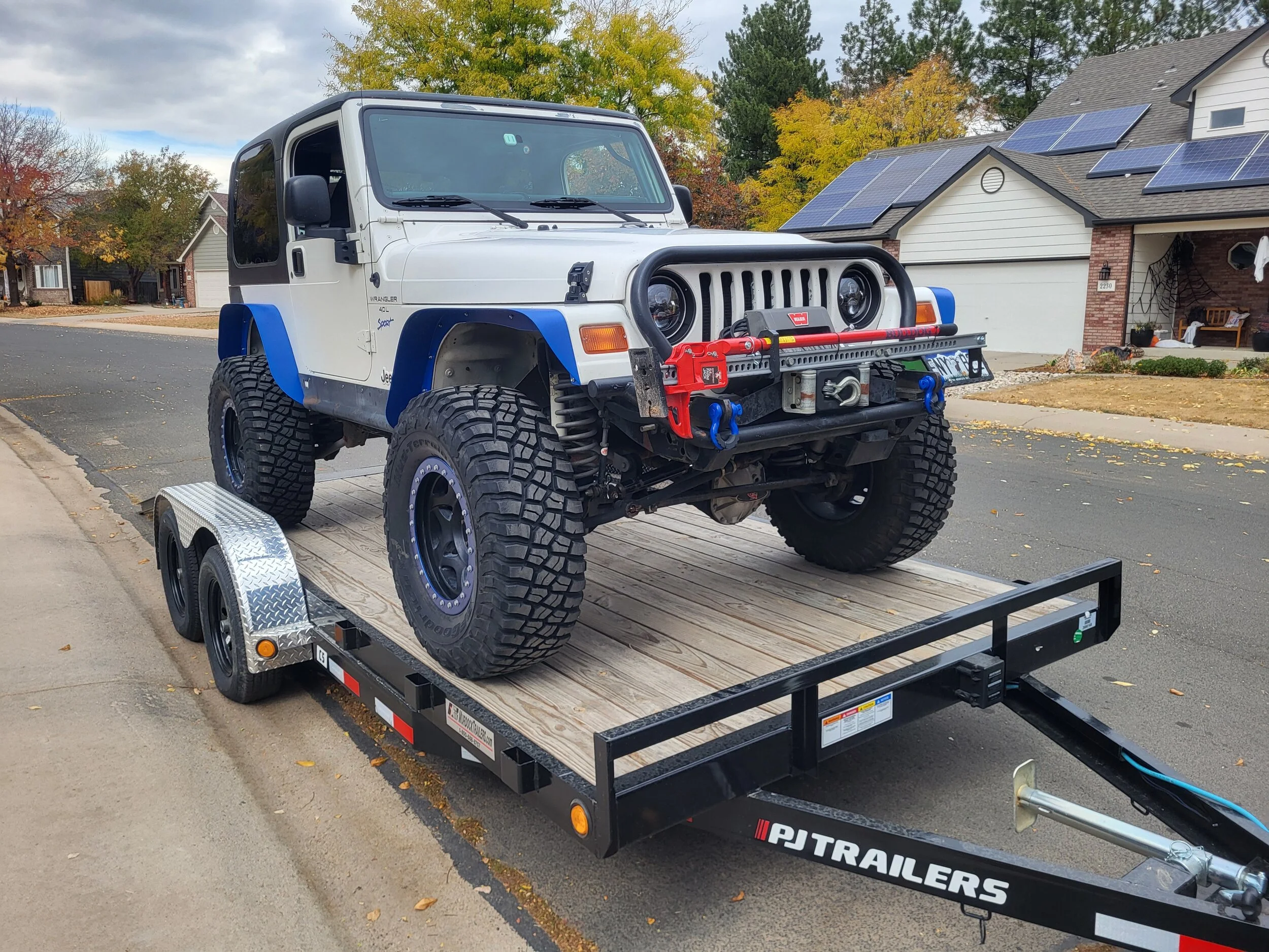

Here's what it looks like. I need to drop the hitch another couple inches. This is on a 2" drop, so I'll try a 4" drop next. It also looks like I need to add some air to the trailer tires. I don't have straps yet, so I'm not planning to take it for a "test drive" yet. I also might park it further back on the trailer to balance the weight a better.

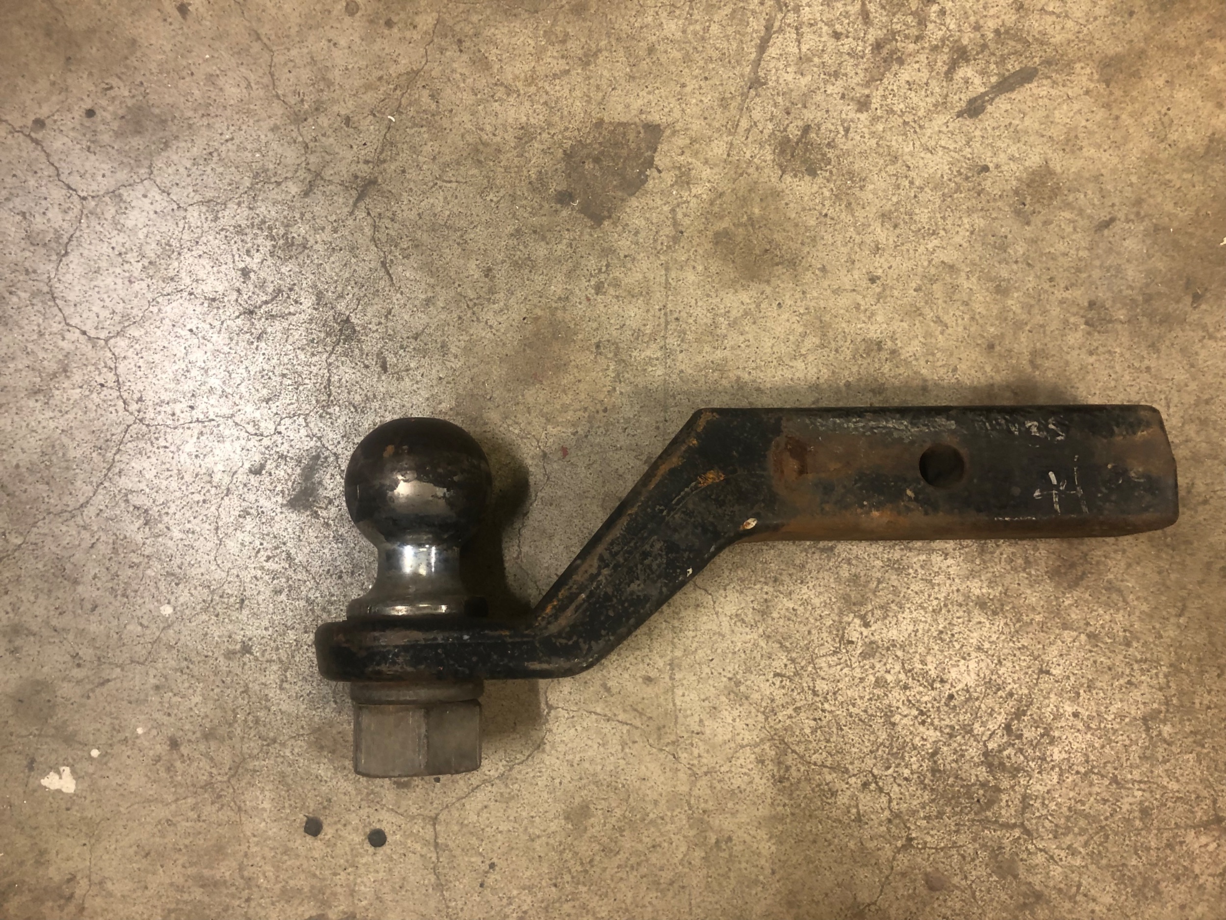

Nice trailer. As you drive it on the trailer you will feel the weight shift to the tongue. 10-15% is what you are looking for. Your’s looks a bit too far forward. I put a paint dot next to my door so I can get mine is the same spot every time. Just a little trial and error to find the sweet spot.

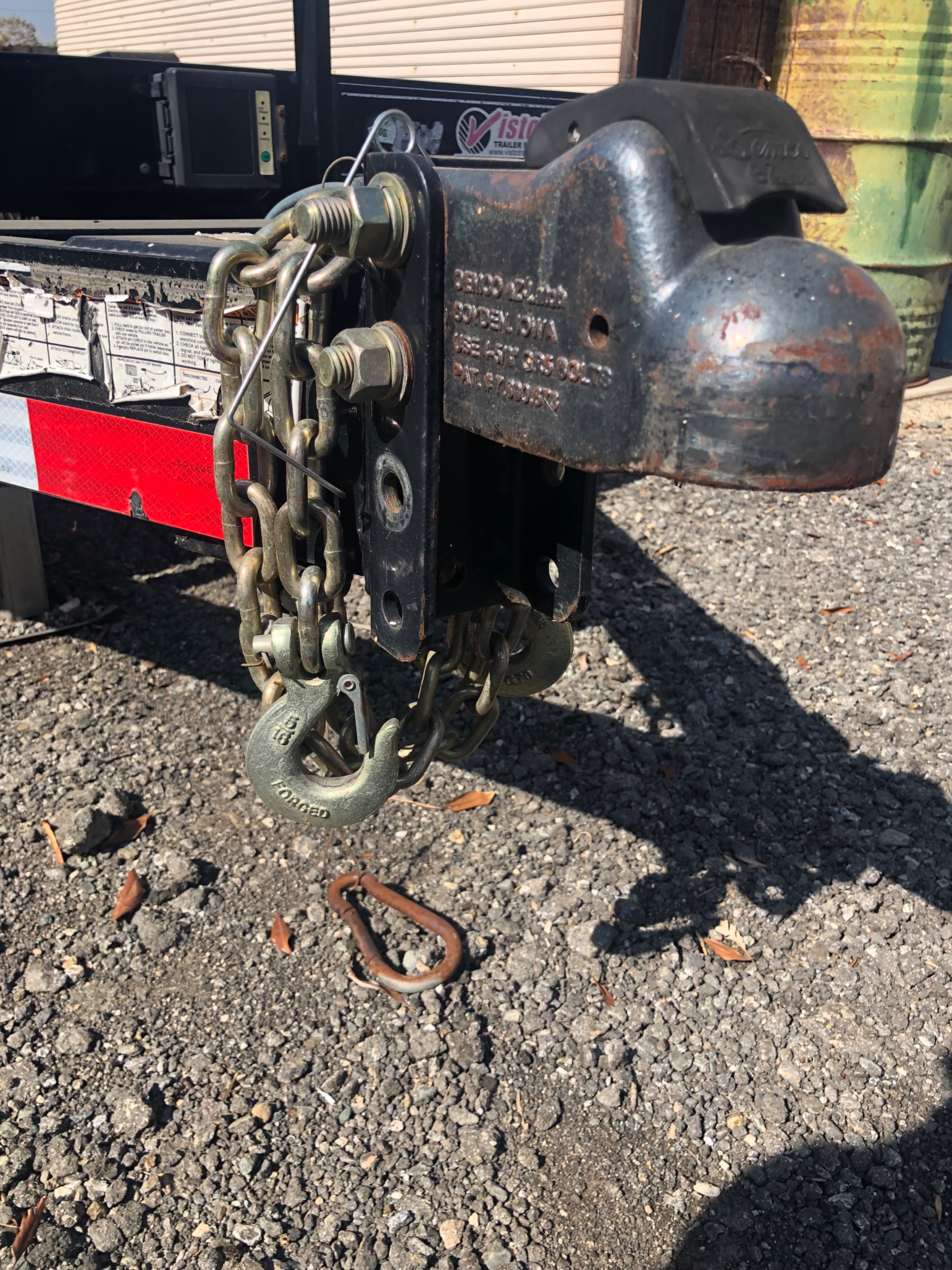

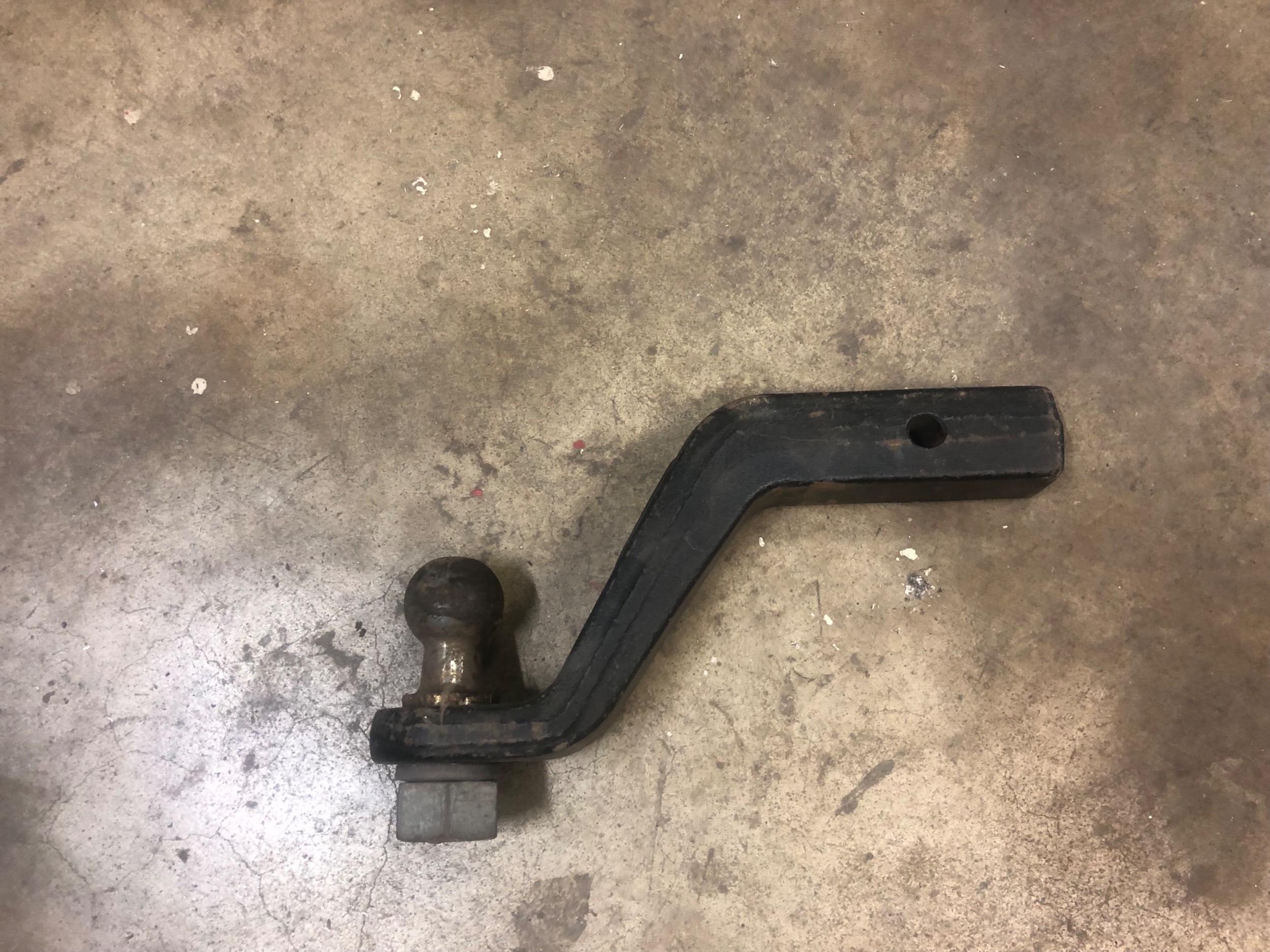

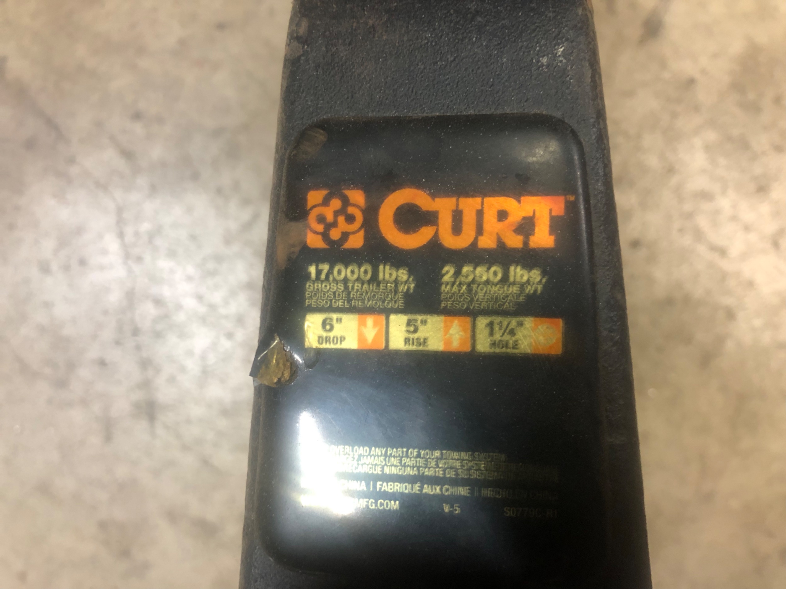

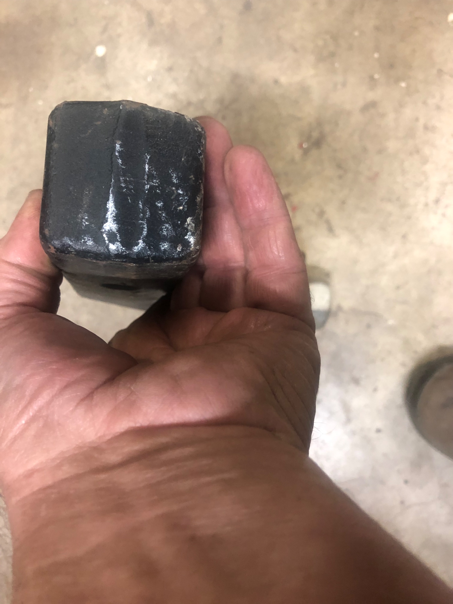

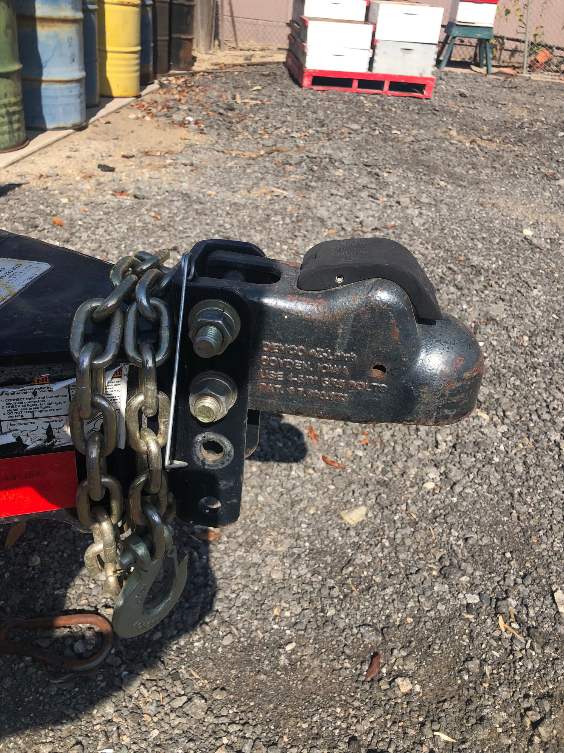

Spend the money on a good ball mount and ball. I mainly use drop forged solid ball mounts from Curt. I use 1.25” shank gooseneck balls because they have the highest rating. It may be overkill for most people but most of my trailers are rated at 12K-18K. Always better to be safe.
4” and 6” drops in pictures.

Do yourself a favor and keep an eye on the tire pressures and buy a spare. Running low psi at near max cap with todays fine imported tires can end bad, seen way to much of that. Nice trailer though. There always handy for so many things.

I have the exact same hitch with the 6" drop. I've got the 4" drop version of this on order. Right now, I have 6 or 7 hitches littering the bed of my truck, but none of them are "just right" yet. I'll eventually get this right! I've collected a lot of hitch hardware over the years from various types of trailers, but it always seems like I have to buy something new.

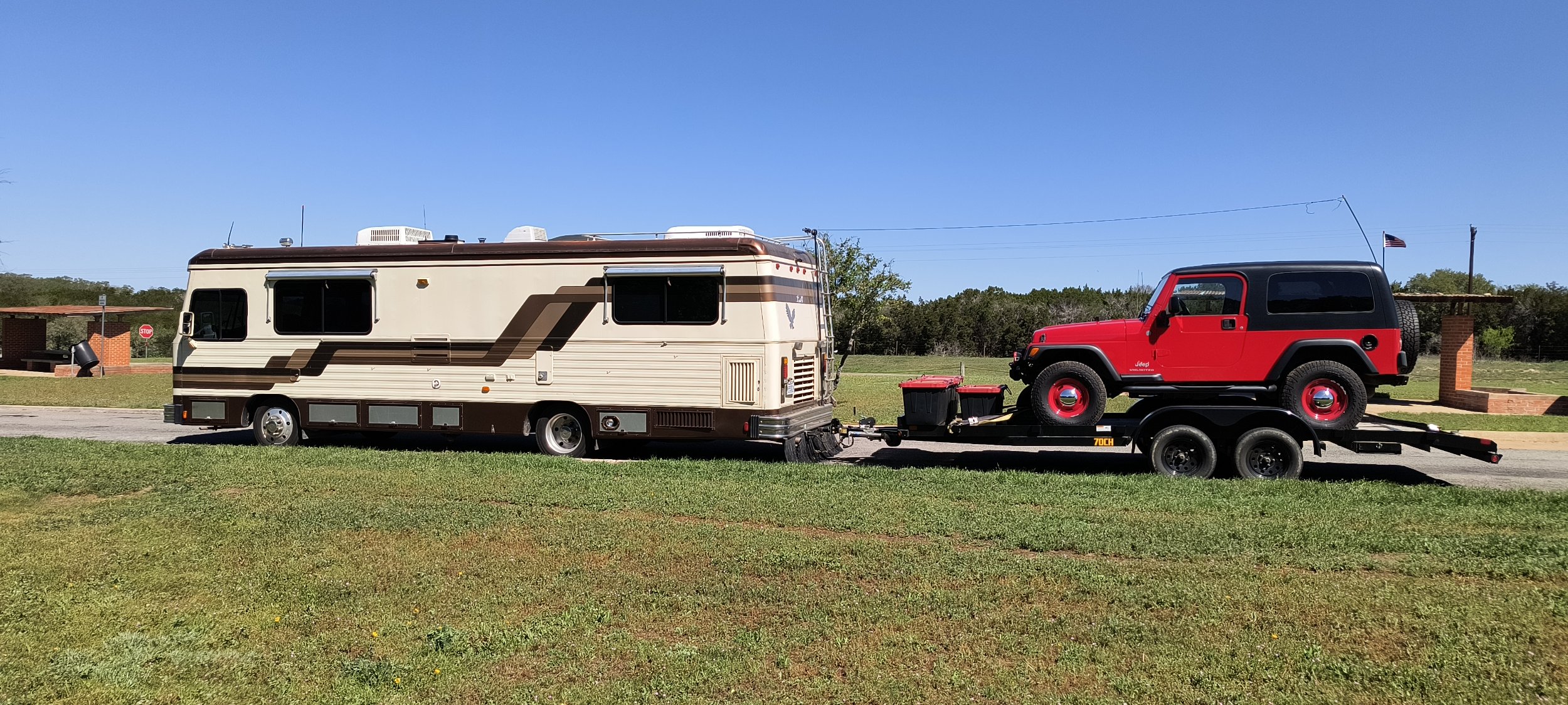

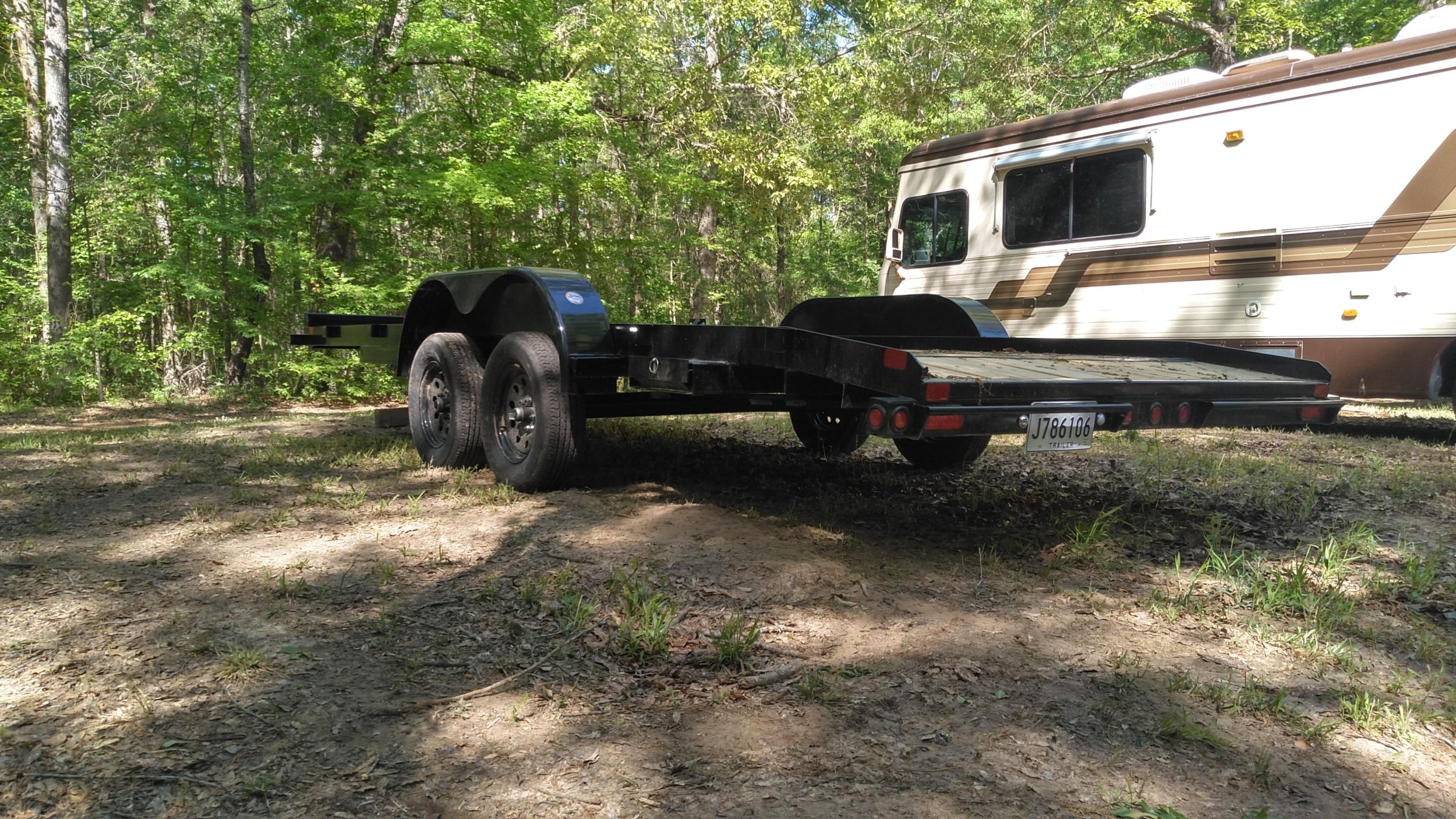

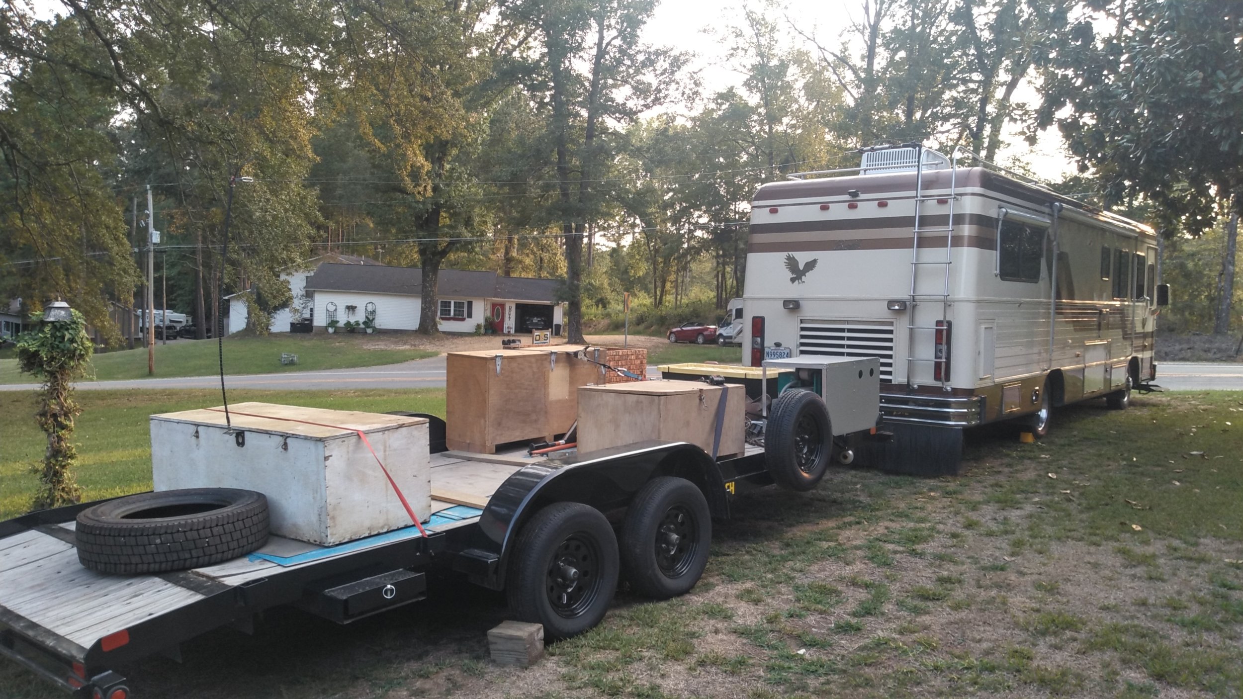

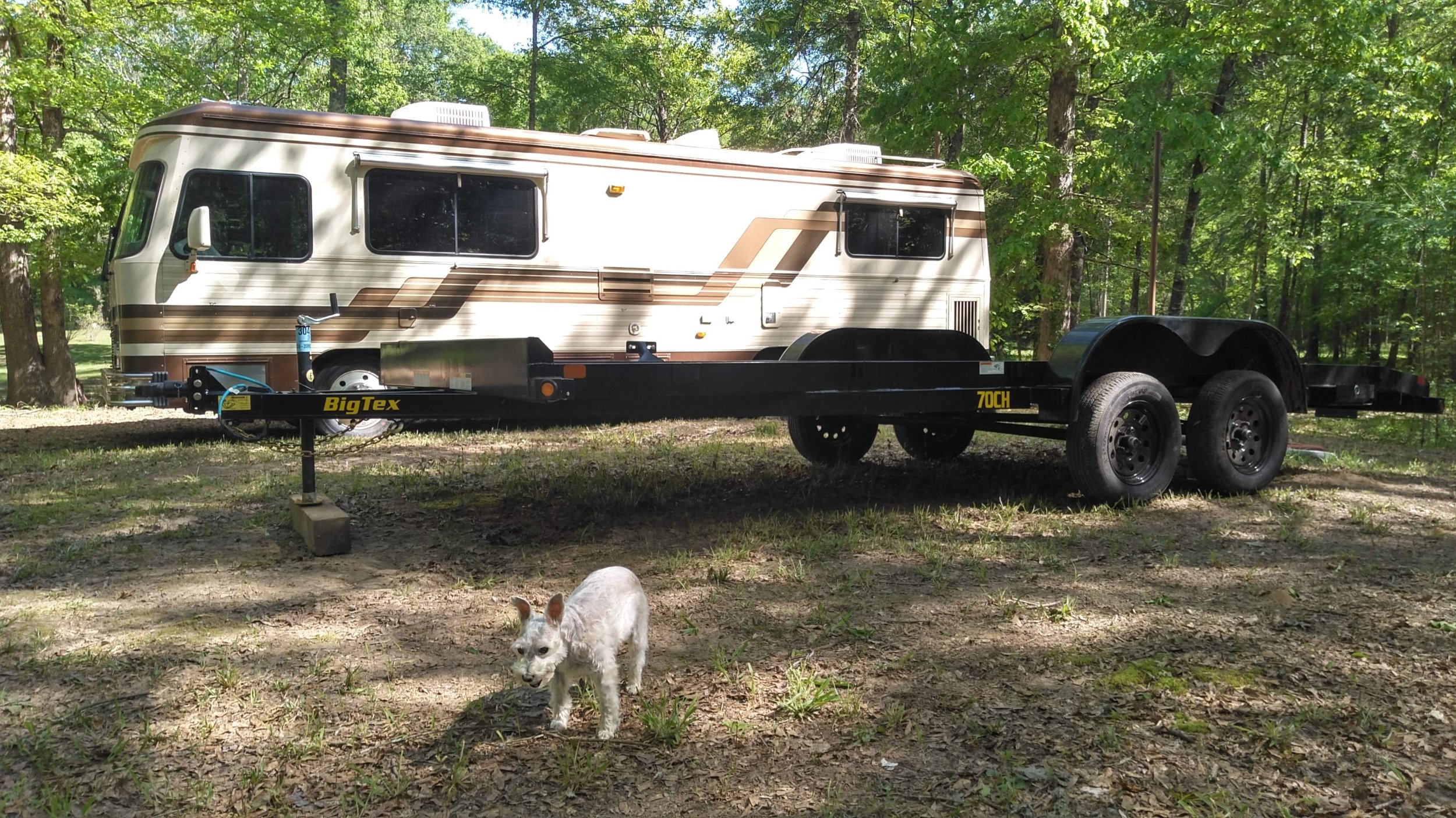

Ours has a 20 foot deck which gives us extra storage . I also had to put a lift kit on it to keep the rear from dragging on steep driveways .
I've never heard (or thought about) putting a lift kit on a trailer. Seems like a good idea though. It's probably not as big a deal for the shorter trailer I got.
Nice looking setup. That's got to cost a fortune in fuel with that big motorhome pulling a 20' trailer with a Jeep on it. Looks like a great way to go though.
It's not too bad . The coach has a 5.9 Cummins and pulling the Jeep we normally get 10 mpg .
The lift kit was easy to install , it just puts the springs on top of the axle instead of underneath . Research showed that it could negatively affect handling , but I haven't really noticed any difference . Certainly helped with the rear dragging . You can't use it to haul low to the ground vehicles unless you can back it into a ditch to load , but not a problem with vehicles that have some ground clearance .
Our spare mounts on the passenger side of the trailer . I also carry a spare for the motorhome under the front of the Jeep laying flat on the trailer .

That’s an old YJ trick, spring over to get some free lift 👍
