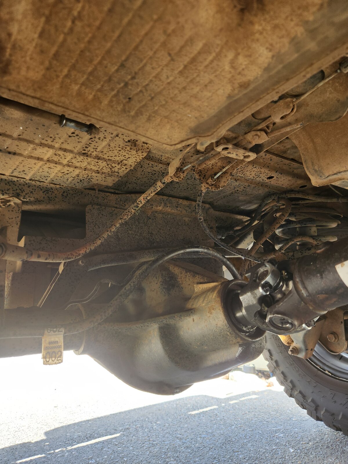

Jackson S Member Joined Mar 15, 2022 Messages 46 Location Australia Feb 6, 2023 #1 Hey does anyone have any idea what all this stuff is spraying everywhere?
Modoc Guy Jack of all trades, master of none Supporting Member Joined Mar 22, 2020 Messages 1,844 Location Canby, Northern California Feb 6, 2023 #2 Looks like your pinion seal is leaking. I can see oil running down the diff housing. Reactions: NashvilleTJ and Artsifrtsi
TheBoogieman Disturbed Jeepaholic Supporting Member Joined Jan 1, 2019 Messages 11,419 Location CharlottesHELL, VA Feb 7, 2023 #3 Pinion seal leaking.
TWiG01 TJ Addict Supporting Member Joined Jun 1, 2020 Messages 1,872 Location New Jersey Feb 7, 2023 #4 Definitely pinion seal. Looks like there’s a bunch of oil in there
