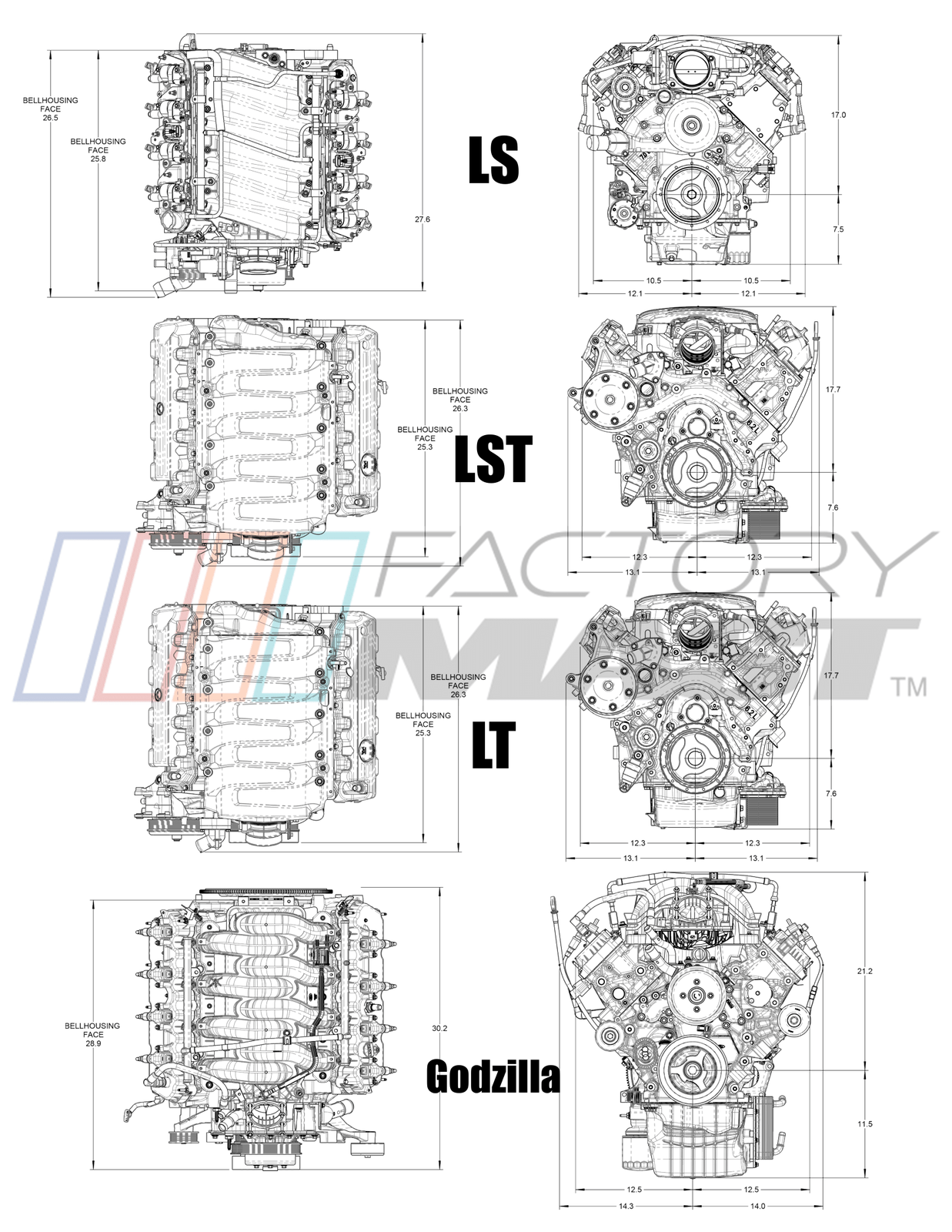

One of the primary advantages of the Godzilla engine is its small size for its displacement. Technically a small block, it is narrower than a 5.0 Coyote, although just a little longer. It measures 24" long from the bellhousing face to the timing cover, and about 29" long including the harmonic balancer and FEAD. Compare that to the TJ 4.0L I6 which is 32" in length. So the engine is actually shorter than an I6, about the same width as most GM options; however it is a bit taller. Aftermarket intake manifolds could probably shorten the height closer to the average GM option.

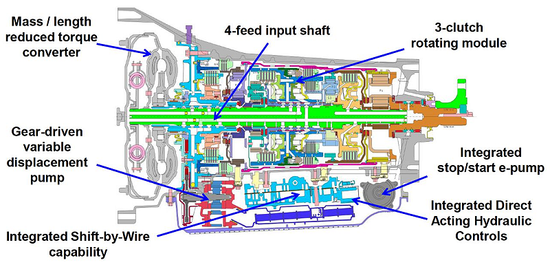

Out of all those options I would be most tempted to pair it with the 10R80. Given that the 10R80 is 27.8" and the 7.3 is 29" long, for a total length of 56.8". Compare that to a TJ 4.0 (32") equipped with an NV3550 (23.1"), which has a total length of 55.1". With an electric fan conversion, the engine could be placed in such a way to maintain OEM driveshaft lengths or similar. The 10R80 should be more than stout enough for even a modestly modified 7.3L. The 10R80 is used behind F150s with up to 19,500 lbs GCWR, so it will pull your little 4,000 lbs jeep and 3,500 lbs trailer with not a worry in the world. Now, if you slap a massive supercharger or turbocharger on the 7.3L, you might need the 10R140.
Diagram showing 10R80 construction

  • Compactness - this engine occupies a smaller footprint than even the 5.0 Coyote, and theoretically could fit in a TJ engine bay without much issue. A small body lift may be preferable to increase clearance, but we really won't know until someone tries. Relocation kits for the oil cooler and oil filter are available aftermarket.
