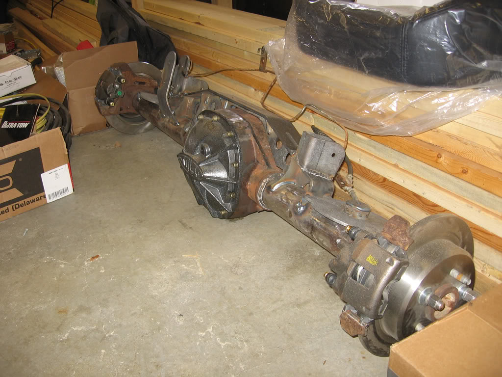

For those U-Tube junkies out there, there is a lot of cheap wrecking yard finds. Take this videos for what they are worth. Trust me, there is no cheap way around any of this.
Once you get your junk yard find, the axle still has to be totally cleaned inside-out. All the original mountings have to be removed and welds ground clean. Then the new mountings have to be welded on before you can begin the axle build.

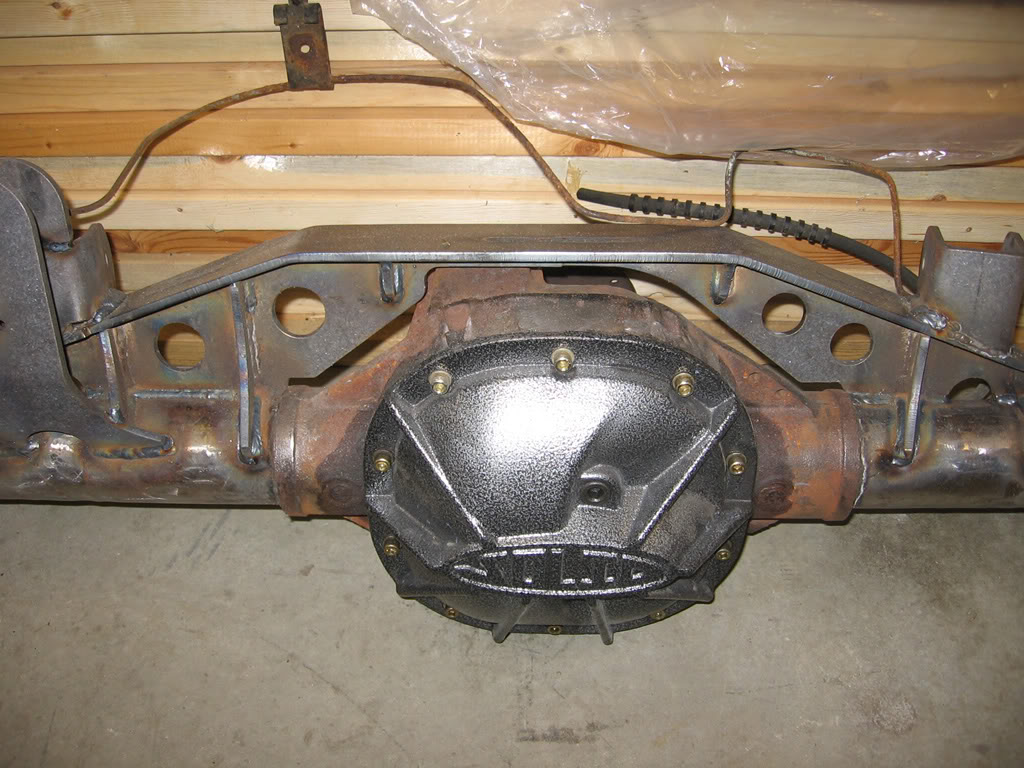

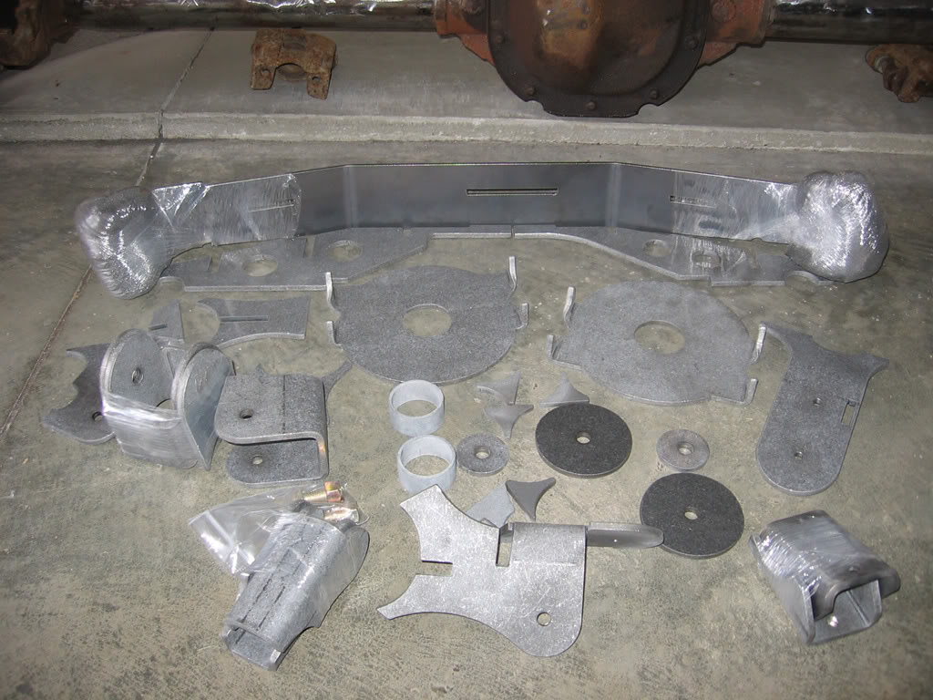

Now then, I purchased my 8.8 for $20.00. Great deal. Now the axle assembly needs to be upgraded for off-road use and fitment under El Diablo.
Purchased - G2 4.88 gear set, G2 gear set install kit, a replacement yoke for 1310 stock U-Joint, ARB selectable air locker for 8.8 - 31spline, AZTEC Industries TJ 8.8 Swap Kit with Truss, new rotors, brake pads, parking brake shoes, parking brake cables, caliper assemblies, 3x quarts Royal Purple 75w-90 full synthetic gear oil. A few other this & that I haven’t discussed. Around $3,000.00. Yep. If you cut corners in your 8.8 build you will regret it.
Now, why did I want a truss for the 8.8? Simply, the ability to upgrade and added strength to the axle to help keep it from twisting. All welding should be completed to your new 8.8 while its still in bare form.

If considering the 8.8, I highly recommend the Artec TJ truss/brackets. I was originally building an 8.8 several years ago and got one of the first kits. Pure beef, and takes the guess work out of bracket placement; you just have to determine pinion angle and comparable angle for the spring buckets.
I ended up selling the axle before I got it regeared and installed since I got a smoking deal on a HPD30/Dana 44 combo already geared and locked. The 8.8s are definitely great axles, and anything is better than the Dana 35.
Here's the kit:
Here's the kit:
Damn, that thing looks beefy!
