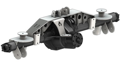

Now, why did I want a truss for the 8.8? Simply, the ability to upgrade and added strength to the axle to help keep it from twisting. All welding should be completed to your new 8.8 while its still in bare form.

Is there welding involved? Yes, but the new brackets you put on are much stronger than stock Dana’s. Not a good idea to re use your old Dana 35 brackets
Can I reuse my Dana 35 brackets? Yes, but it is not recomended. The stock Dana 35 brackets are sort of flimsy compared to the beefy aftermarket versions. Some of the brackets available are in fact for Dana 35 axles to replace the weak ones that come factory. Reusing the D-35 brackets is time consuming even if you have the right tools, not a good idea IMO
Should I weld the axle tubes to the cast housing? I would if it had been salvaged from a wrecked rig. If it is new on a crate (in my opinion) don’t bother.

What is so great about 8.8? Parts are everywhere, as in axle shafts, covers, brake parts etc..
What's not so great about the 8.8? Weak stock carrier, replace with a carrier type locker like ARB or Detroit (not a lunch box type) this will cure the problem.
Spun axle tubes: Simply weld the tubes into the diff housing before they spin. You are welding to cast steel so now would be the time to ask for a professional's opinion. I have heard of guys tossing the works in a oven before welding, some just go at it cold. Both say their way is right.
Thin stock diff cover: Get some armor.
