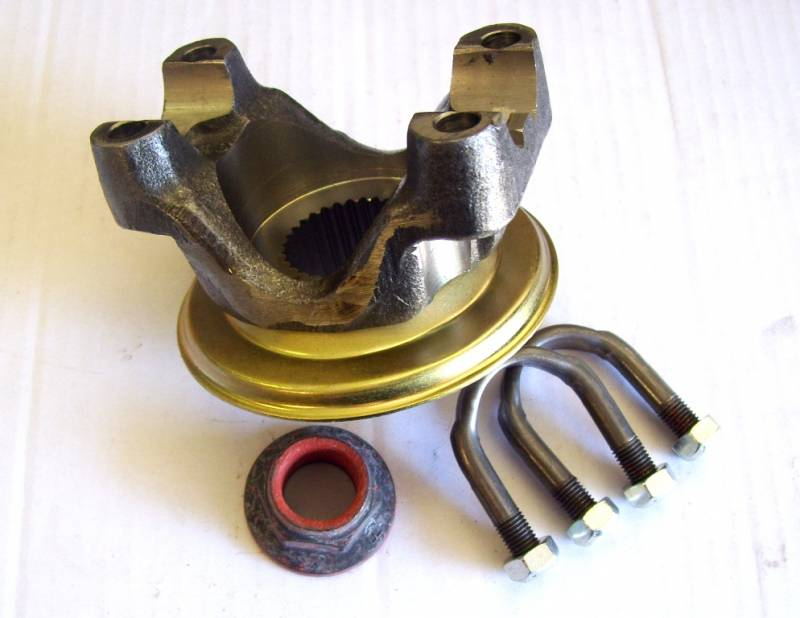

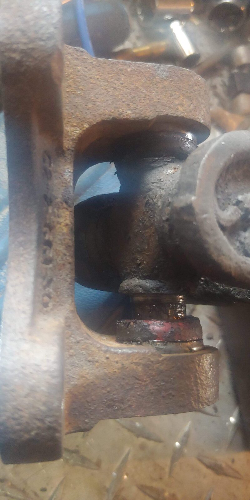

I have the adapter flange from the 8.8
The u-joint that fits into the stock yoke of the diff is skinnier than the flange for the 8.8
I purchased this U joint and used the adapter flange . when pressing in they fit nicely .https://www.amazon.com/gp/product/B000CKN762/?tag=wranglerorg-20I have the adapter flangeView attachment 235977
