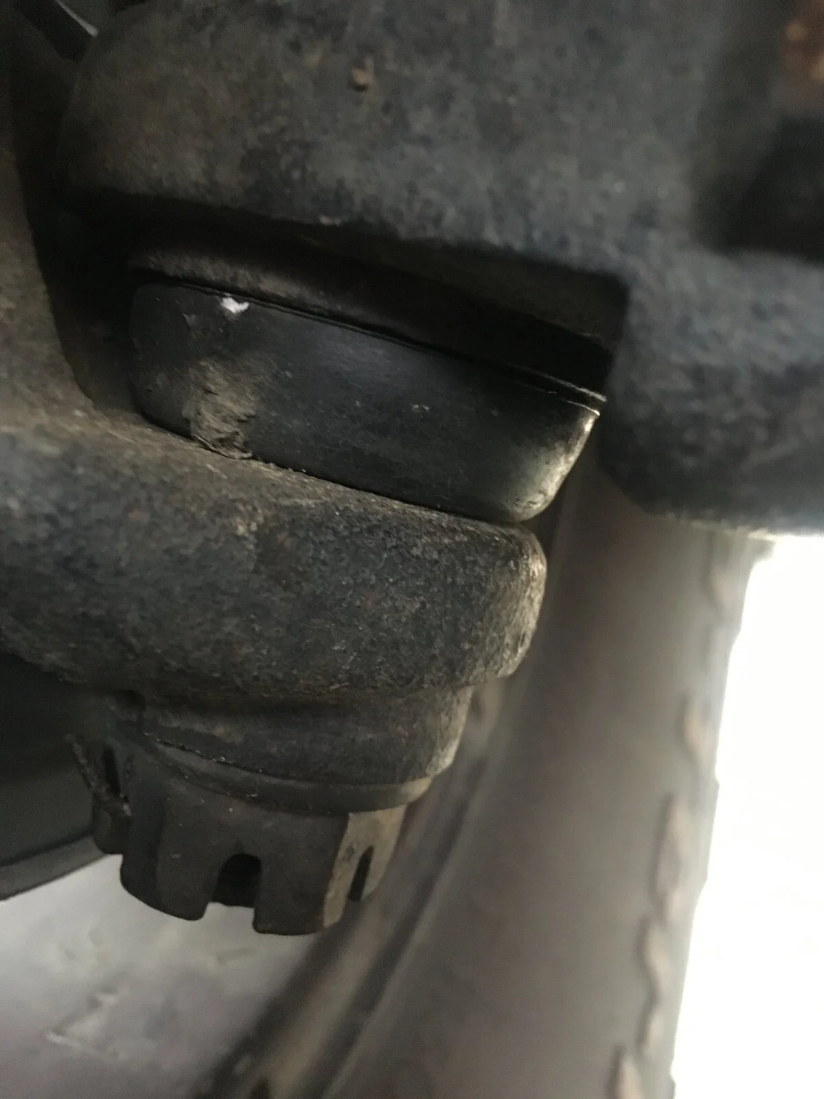

so are there variations in ball joints today?? Are the ball joints in my Jeep from back in 1997? I dont know
No I was referring to the TJ style ball joint as the limiter not just the specific ones in your Dana 30. Same issue with a 44 as well. I’m not sure what can be done but if it was that easy more people would be doing it.
yep i agree. so what i a superman strong ball joint or something else that connects the axle yoke to the spindle/unit bearing yoke?
I mean if I really want to continue fixing the weakest links on my dana 30 , even more implortant than the chromolly axles just installed , would be the ball Joints !!!! I see standard ball joint, heavy duty ball joints. So are the breaking points of these ball joints 100% better
There’s a thread on here that tells you what the best ball joints are. They are spicer but I don’t remember the model number.
All the so called HEAVY DUTY BJ's are really nothing more than smoke and mirrors to get more of your money. The issue once you replace those ball joints with something STRONGER is now your inner "C"'s will stretch out or the housing will bend. Stop spending money on the Dana 30 and step up to a Dana 60.
If beyond all this OTHER advice you still want something stronger there is a new Ball Joint Eliminator available that is too new to say.

Thanks, its really more of a what if question. im not going over 35s. but Ive never really asked about the ball joint/ "C" connections. I mean you could actually say the ball joints are the most important part of the jeep .

As they say if you want to play you've got to pay...... For 35" tires the Spicer ball joints at just fine.

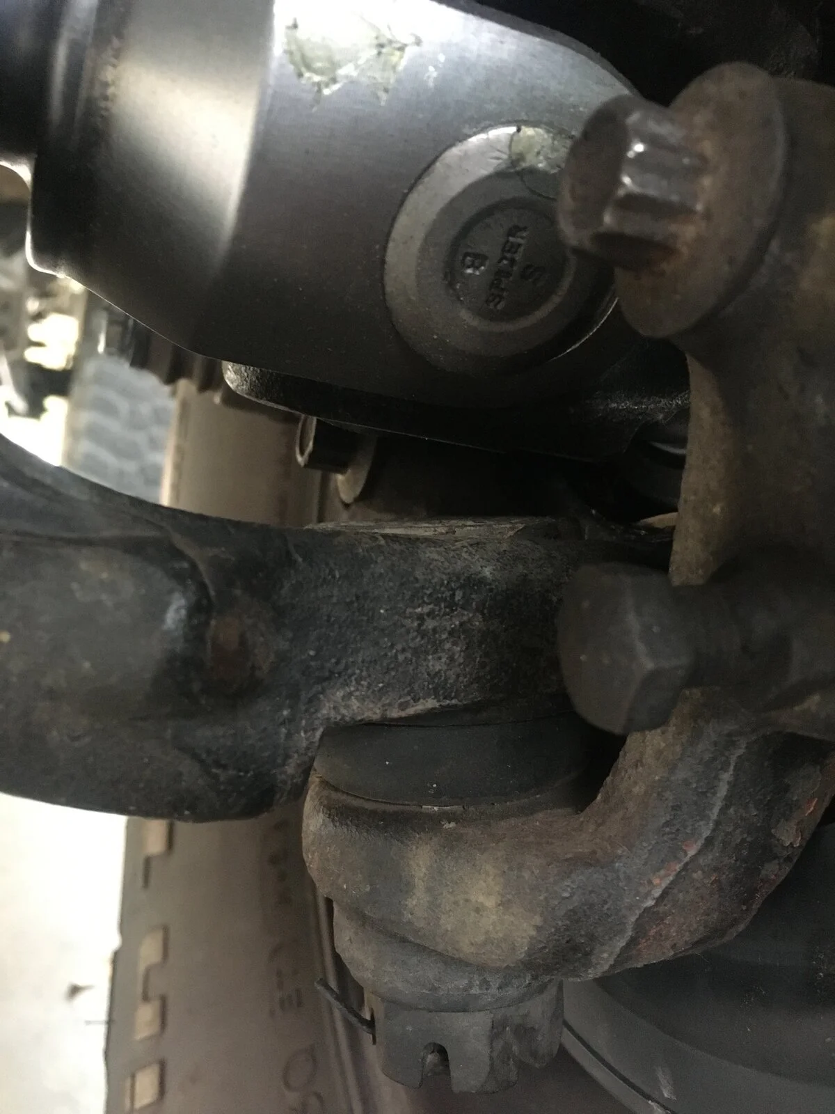

There’s just no way to know how long they have been there
You're in analysis paralysis. Stay with nothing larger than 35's and install those ball joints, odds are they are the factory originals that came in your TJ. You'll have no trouble by doing both of those.

I think your right about the analysis thing. So why would I not change out the steering knuckle too. Is it not a wear item too?

The only thing that wears on the factory knuckle is the brake slider casting. The pads will wear divots in the bearing surfaces. Those can be welded and reground. No biggie.
I suppose, if you had loose tie rod ends, and didn't pay attention to the knocking sound they would make, your tapers might wear out and necessitate a replacement knuckle too. That doesn't fall under "normal" wear and tear in my book, though.

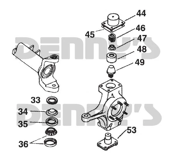

what other types of attachment points for turning purposes are there on front axles other than steering knuckles , or do all front axles attach/pivot from a ball joint holding the steering knuckle to the C bracketr on the axles ?

One Ton axles (some, anyway) use what is called a kingpin. Similar in theory to a Balljoint, but made of many parts that can be disassembled
