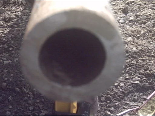

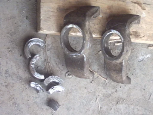

This is a inner "C" off the Ford HP44 I have in my TJ.
This is the axle tube. Compare that to a TJ Dana 30/44 tube.
You have to get inner "C"s that allow you to have stronger ball joints or king pin plus depending on the inner c you use also determines what size u-joint you can run.
It's all a game of choosing the correct parts.
