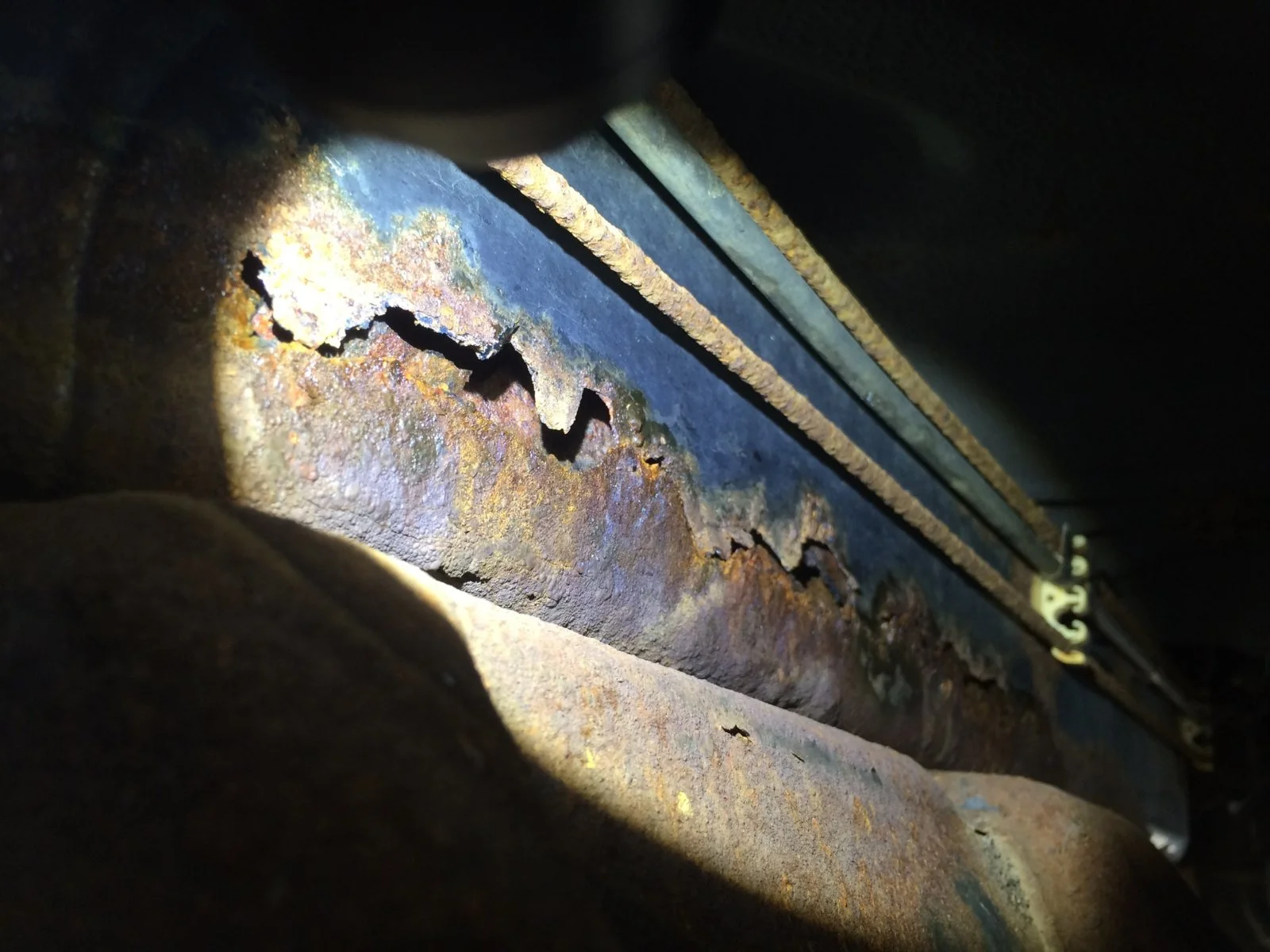

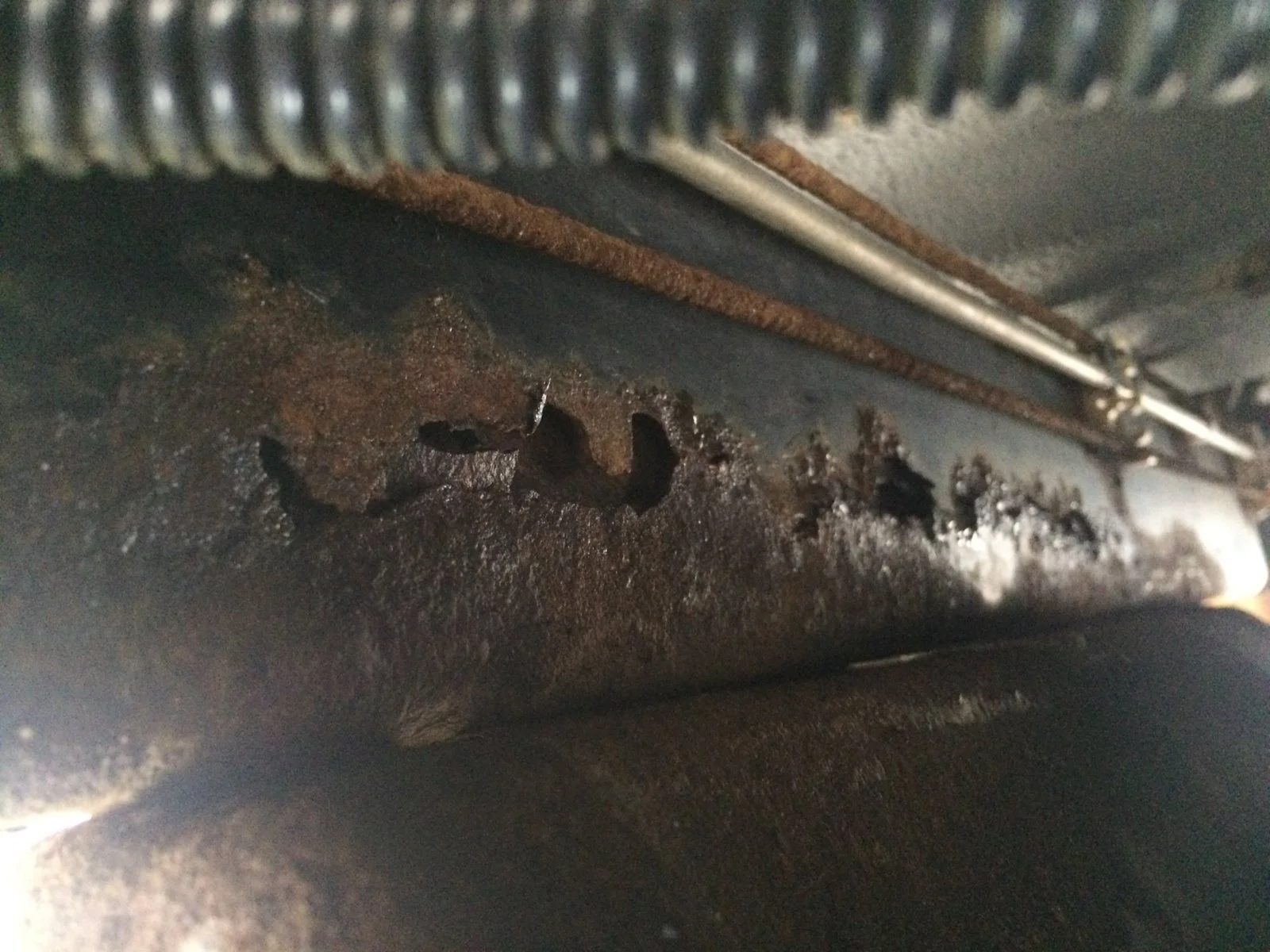

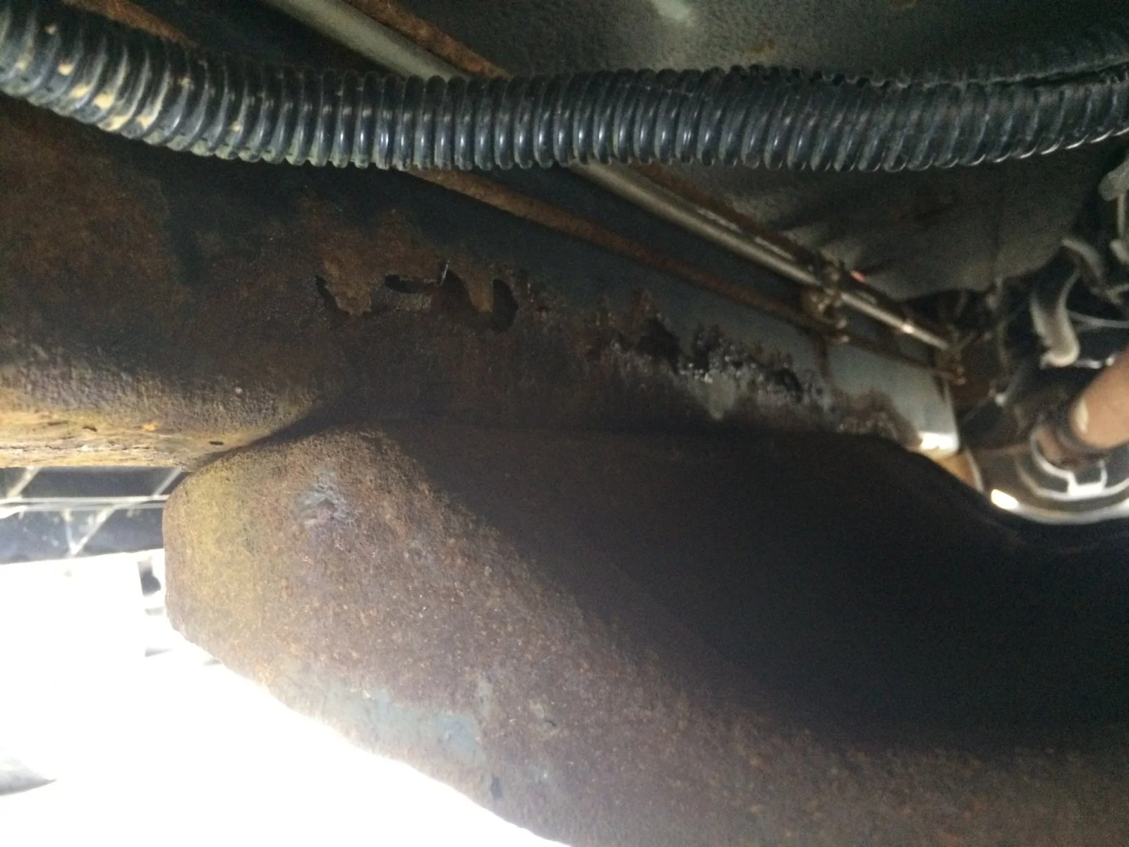

so this is my DD and I plan on welding a sheet of metal of frame cap down the road.....

I know it doesn't look like it but I can pass a screwdriver through with no resistance. I did check the bottom and adjacent side of frame and all seems solid.
I look at something like that and I think to myself, “wow, that’s really scary”. However, I’ve also never owned a vehicle with rust that bad myself, so I’m not entirely sure how safe it is. I can say that being that it’s part of the frame, that is what worries me most. Realistically you could keep driving it for decades and maybe it would never give you any trouble. However, I wouldn’t chance it. I would say keep driving it if you feel up to it, but work on fixing in in the next year or so.
I had the same exact issue when I bought my 99 Tj. I would recommend fixing it sooner rather than later. A couple of things could happen with that much rot, 1) you could hit something with the skid and destroy the lower part of the frame completely and be left stranded with a hanging t-case.. 2) it could give way with a sudden jerk of movement from the t-case and again you would be stuck with a hanging t-case.. From what the rot looks like, you wont be able to get your skid plate off without breaking the nutserts which would leave you with a non-driveable jeep because you would be left with a hanging t-case... I used "safe-t-caps" replacement parts to replace that section of the frame. If you have any welding experience than its a pretty cheap option to fix your issue. I agree with chris that you could drive it and have nothing happen for a couple of years but I wouldn't chance it.

I would also say you could keep driving it but don't do anything that will flex the frame. Also, your brake lines and evap line are rusted real bad too, you could potentially lose your brakes while driving, just FYI.
Totally doable job though, you sound like you can weld, so thats a huge plus and money saving there. Buy the caps and fix this TJ up!

My opinion is to not put this off for two reasons. First, with your brake lines that rusty, imagine a situation where they fail and you have to rely on that frame to keep you (or others) alive. Maybe its my NY experience, but that is a lawyer's wet dream. From that perspective, drive it at your own risk.
From a pure "when is it going to snap and leave me stranded" perspective, it is impossible to tell. There may be cracks that aren't visible through all the rust. Remember that in order to use safe-T-caps, you must have good metal to weld to on both sides of the frame. Once you have less than 1" to the top of the frame, there is not enough to weld to maintain sufficient strength. Every day that you wait is a day closer to making it unrepairable. Hate to see you wait until summer only to find out there is too much rust and now you are stuck doing a full frame swap.

Soon as it warms up I am going to see if I can weld a plate up to it, after I clean as much rust as I can, and let it go...

Plating the side will only last if you cut the old rust off. Otherwise it will just continue to eat away until the plate falls off. Cut out the rust, hit it with some good weld-thru primer, weld on the plate and use some frame saver (Eastwood makes a good product). That should keep it in business for long enough to plan out a frame swap. The only issue you may have is the nutserts for the skid plate. If it was me, I would buy 6 of them before hand just in case. You should be able to get it done in 4-6hrs. Most of your time will be dealing with the damn nutserts.
