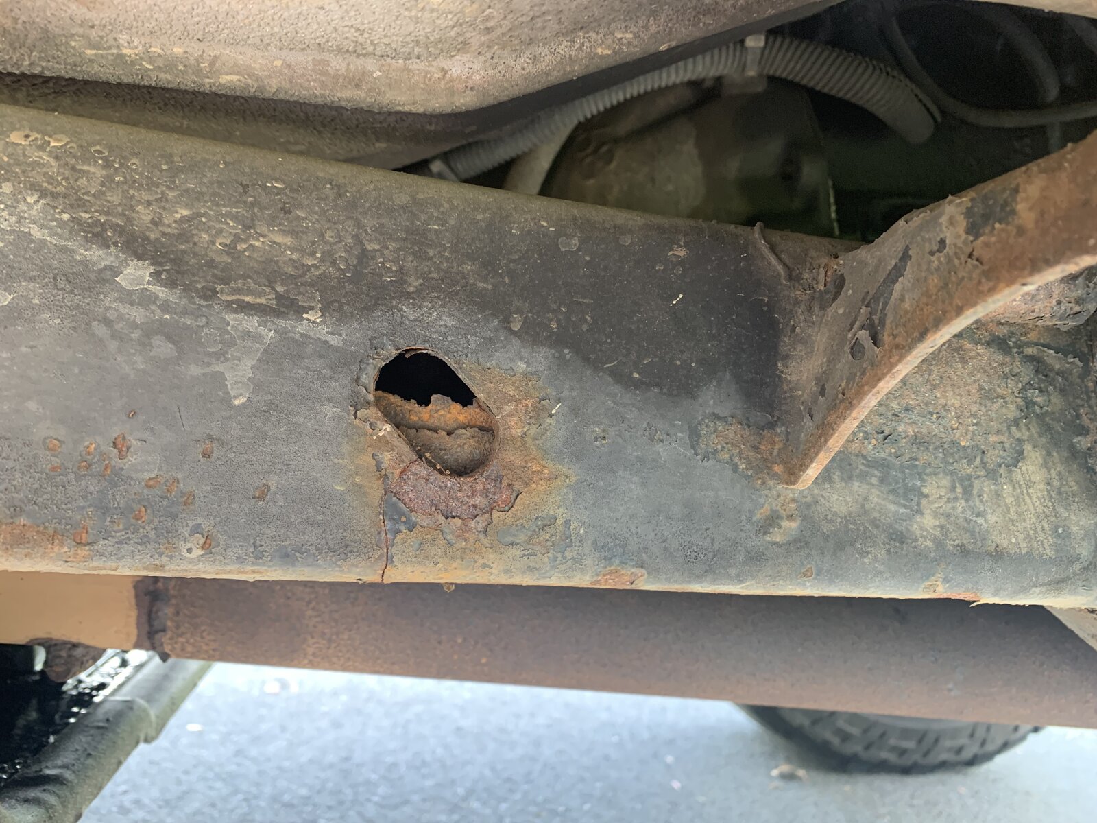

I have a 98 Tj that needs some welding on the frame. I’m planning on doing it myself. If anyone has any pointers I’d be greatly appreciative. Here’s the rust spot on my frame
Welcome,
Being a former NJ rusty frame owner I can tell there's a lot more going on than you can see and will most likely find extensive internal damage.
Take the time to search this forum for frame rust to familiarize yourself with the process. An inexpensive android borescope from Amazon can really tell you what's going on inside. https://www.amazon.com/dp/B08GL4465F/?tag=wranglerorg-20
There is a lot of good info here https://www.autorust.com/ There are patch panels available from several sources but they are an industry leader.

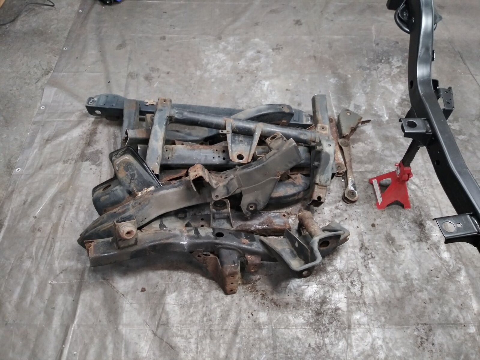

This is my 99' NJ frame
The above link is what we have used, quality product, works great.

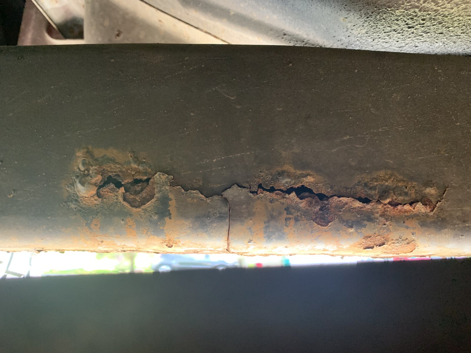

I had a full frame repair job (front and rear trail arms plus center) done recently. I used a combination of Safe-T-Cap and Pocono repair pieces. You'll save a ton of money if you can do the cutting and welding yourself.
You can use a scope if you want but that frame needs to get gone or get fixed. I would read up on Safty Caps and go ahead and cut that section out, clean it up weld in the sections needed. Remember cut and repair one section at a time. I'm going one safety caps over two yrs no issues. If done right it is hard to find any issues with this type of repair. Good Luck.

Curious why one section at a time? Even if you know the entire length of the frame is bad? The shop that did mine (and most videos I've watched) cut the entire length before welding any new sections. They did say that it is better to use three separate sections vs. the one full length piece offered by Safe-T-Cap. The shop I used is on Safe-T-Cap's list of recommended installers.

Your right. I meant one side at a time not one section at a time. Safety Cap recommended that to me. They said it had to do with the weight of the vehicle being supported by the cut frame.
