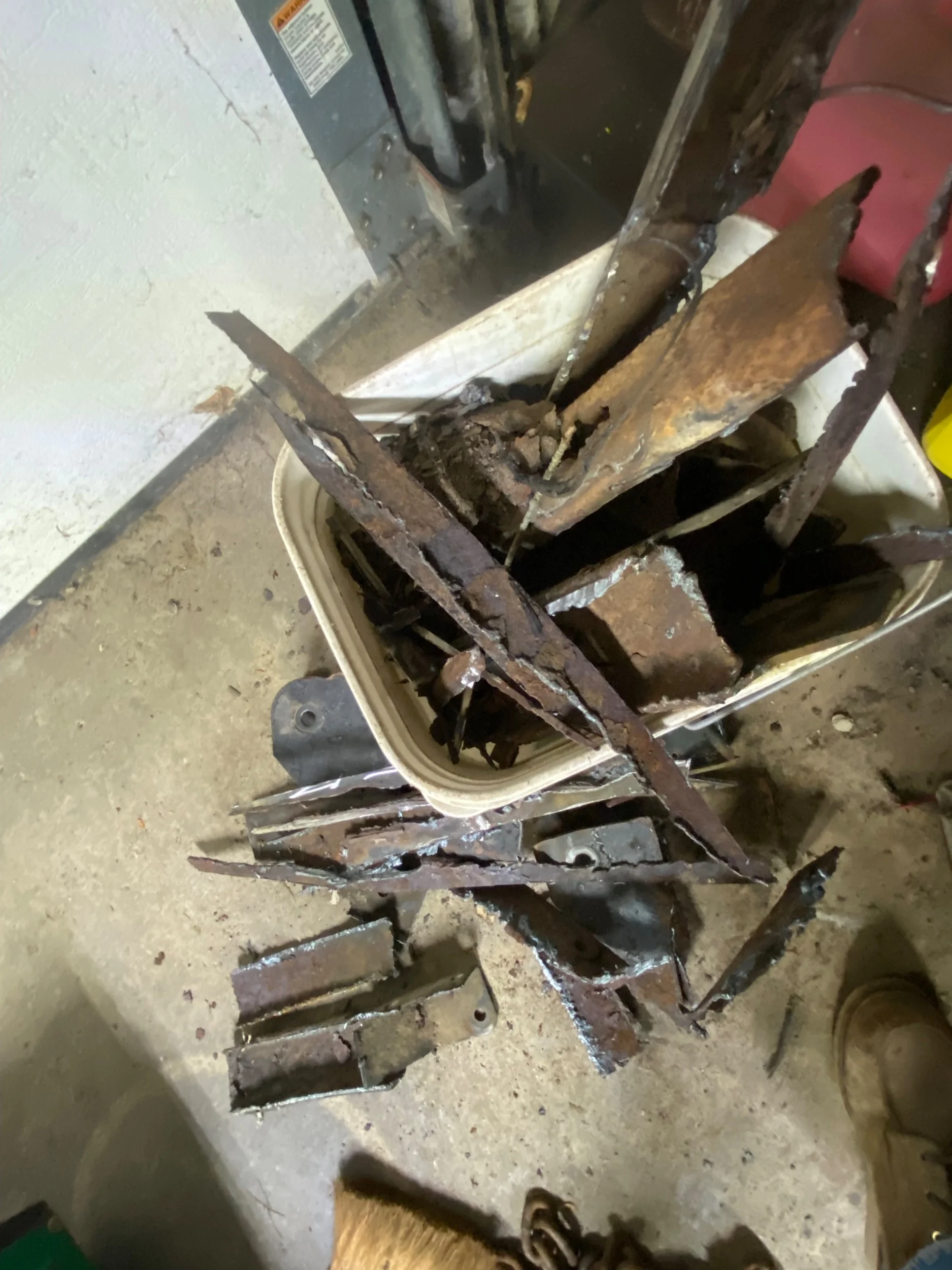

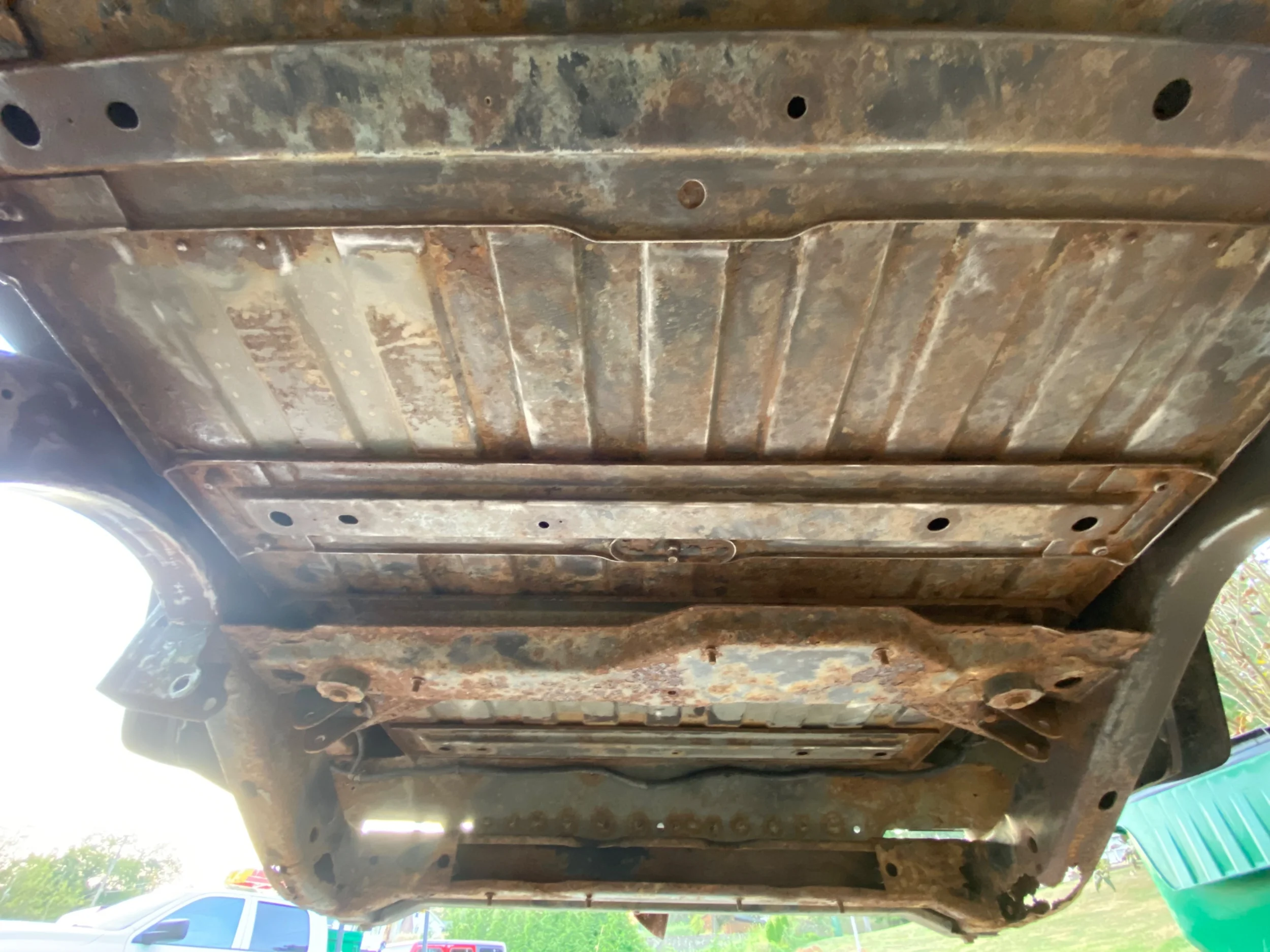

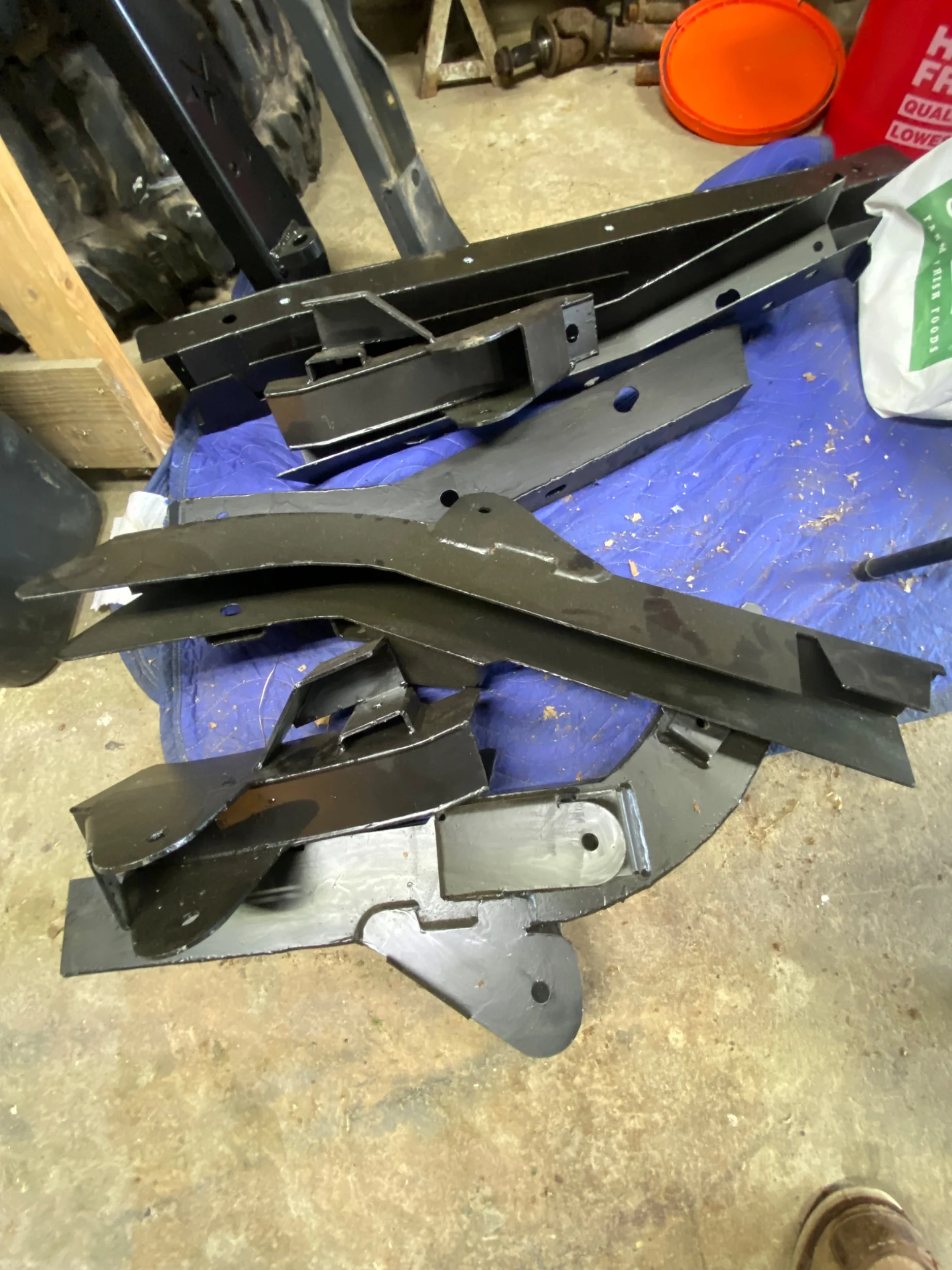

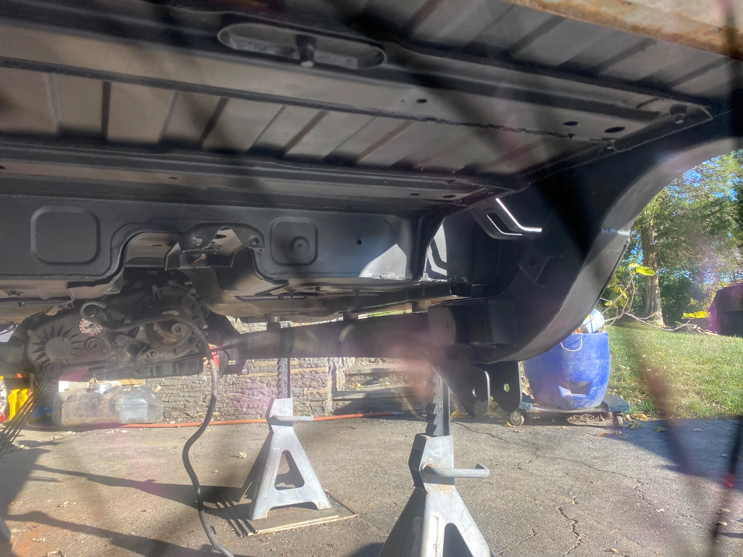

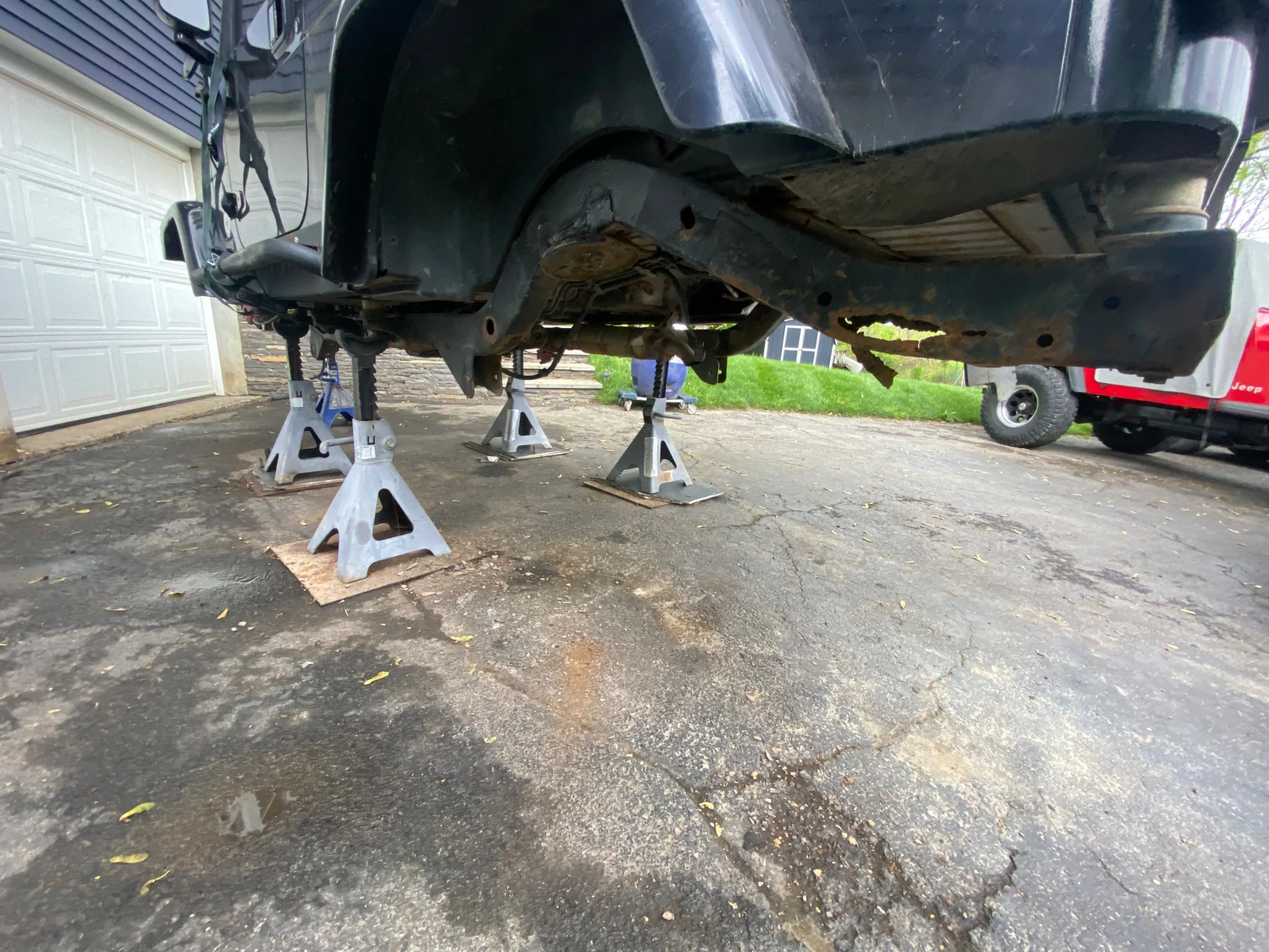

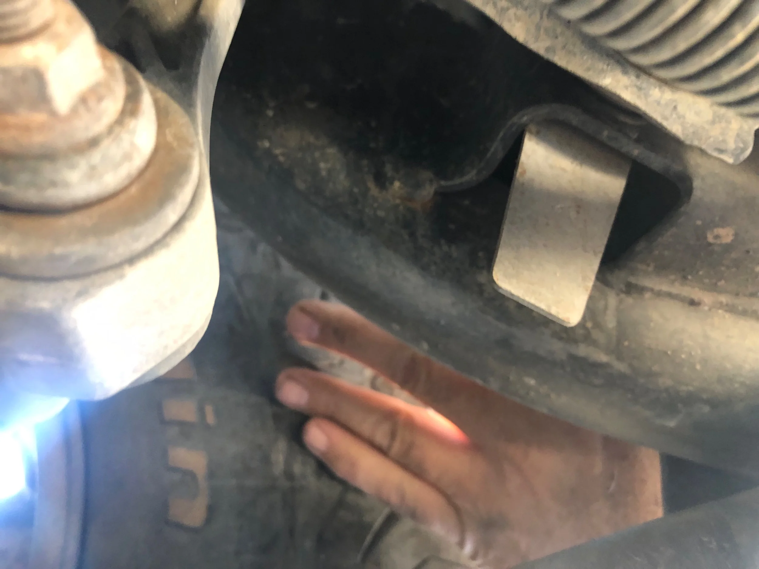

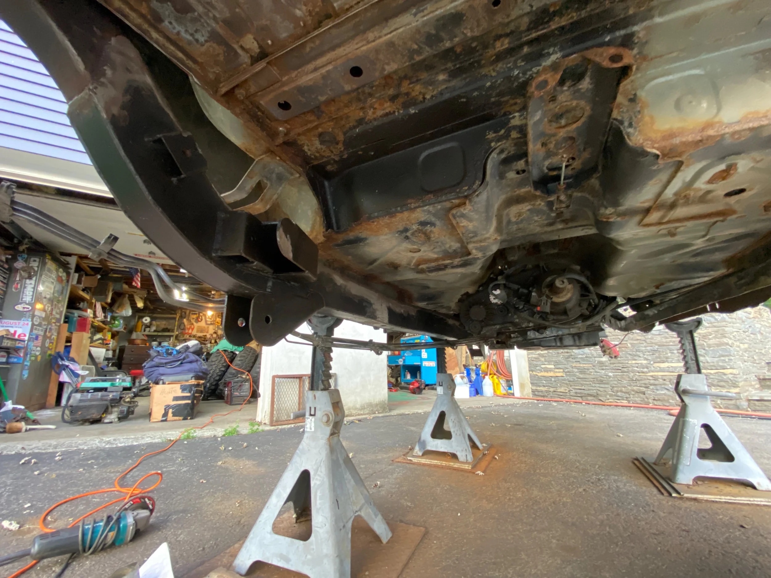

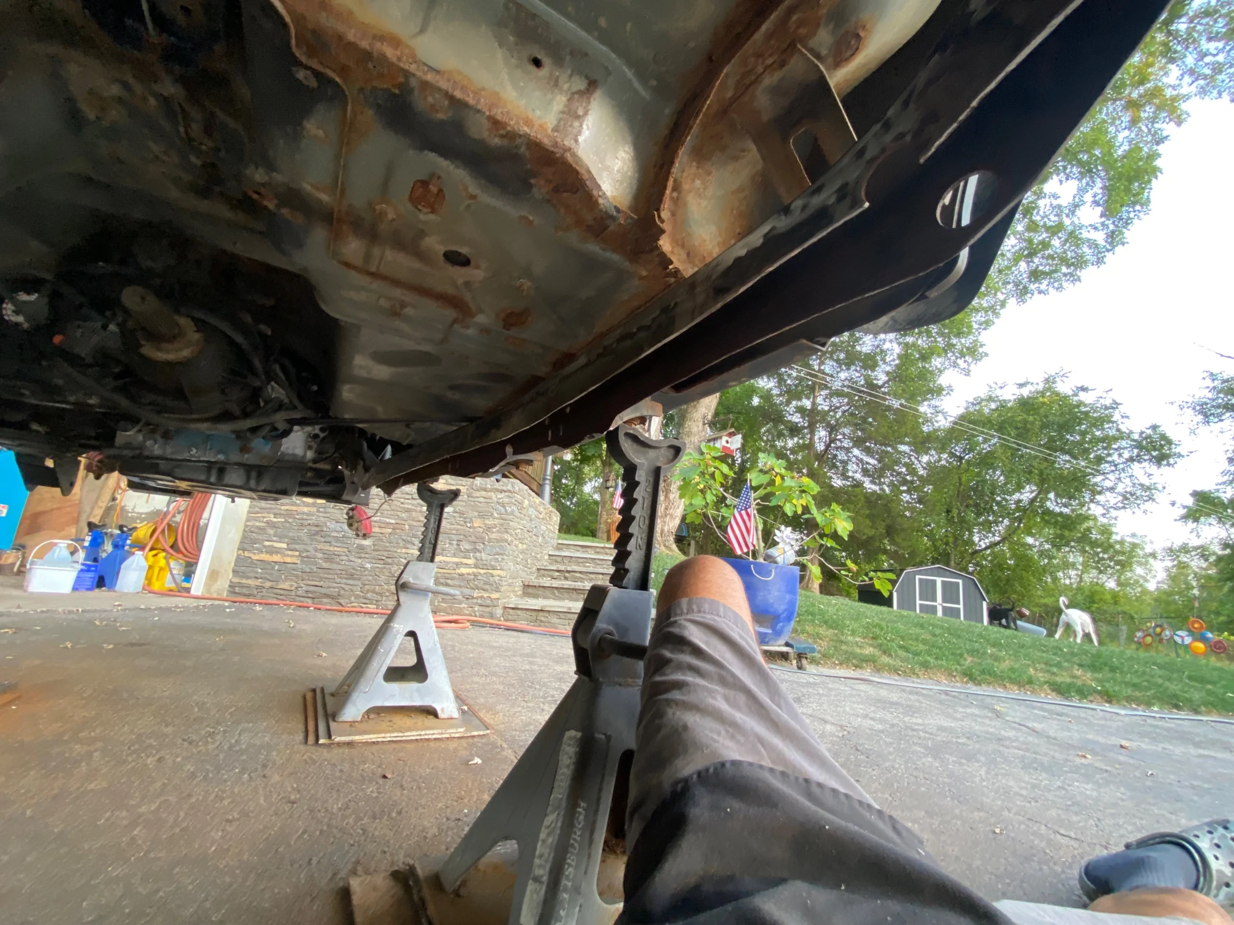

I’m repairing mine now. Not an easy task but a shop local was willing to do the job for ~$4k. At that price I would have bought a clean frame. I’ll attach a few photos for reference. I am completely cutting all the rust out, treating the steel and welding in every safe-t-cap available.

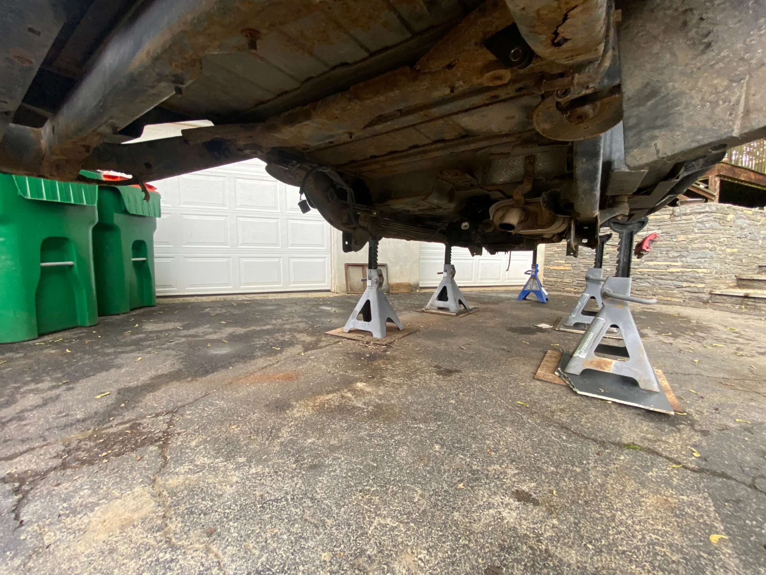

With that frame you will ALWAYS be chasing rust. IMO selling and get a better one or total frame replacement are your choices. On the bright side you have 2 helpers who will learn some valuable lessons. Although they may pick up a few new cuss words. Mechanically a frame swap is doable for a novice the issue is the amount of time and the large space it will require. Being in Ohio it needs to be indoor space. Crunch the numbers and see if selling and heading South or West to get a better one. Picture below shows my 05 LJ with 113K. It spent it’s life in Wy, Co and now Ca.
