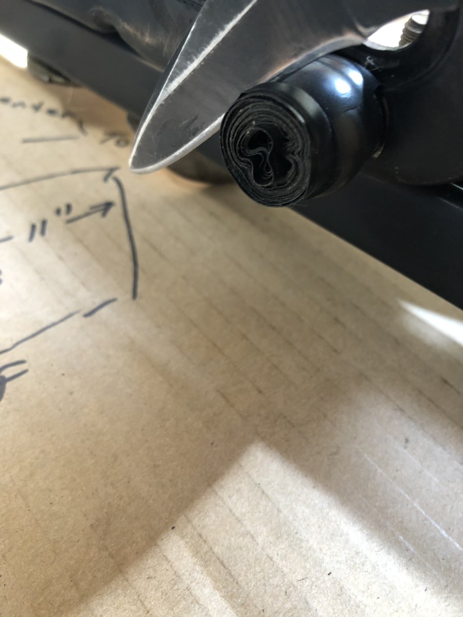

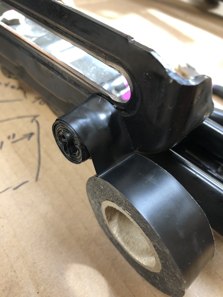

Are your front seats rattling and making a ton of noise?
Don't feel like dishing out 20 bucks for a set of seat support bushings?
Well here's the quick and dirty:
Supplies: Electrical tape, knife.
Tightly wind tape around shaft, the outer diameter (at least on my '98) is .85" or 22mm.
Trim flush w/ the head of the shaft w/ knife:
...And you're done.
Edit: I cleaned the boogers up w/ a mini torch. Lighter would prb work too.
Cost: Negligible if you already have tape. :cool:

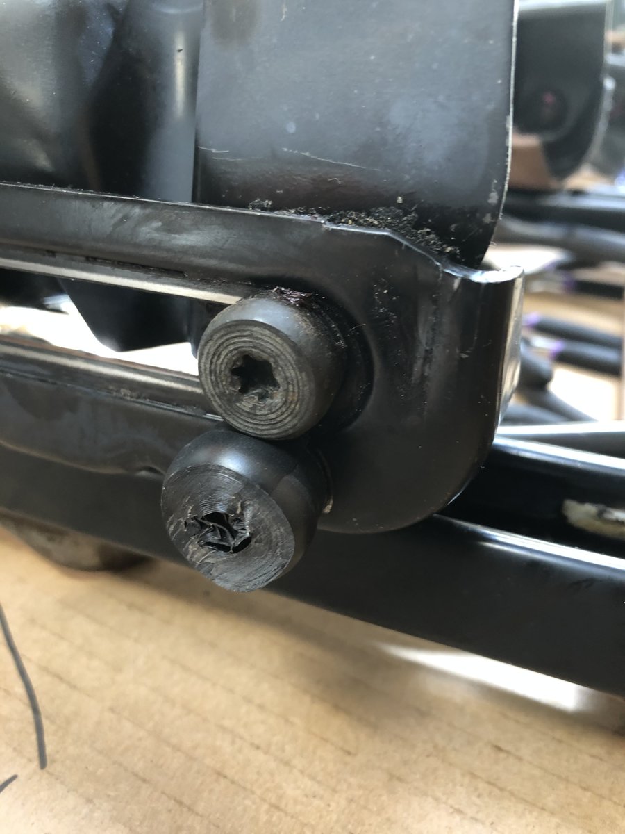

Funny that you've just posted this. Mine broke loose last month. No idea why they cracked in halves like they did, but they did.
Dry rot.
If I come up w/ a more permanent, cheap solution, I'll post here. Who knows, the ET may last another 20 years.

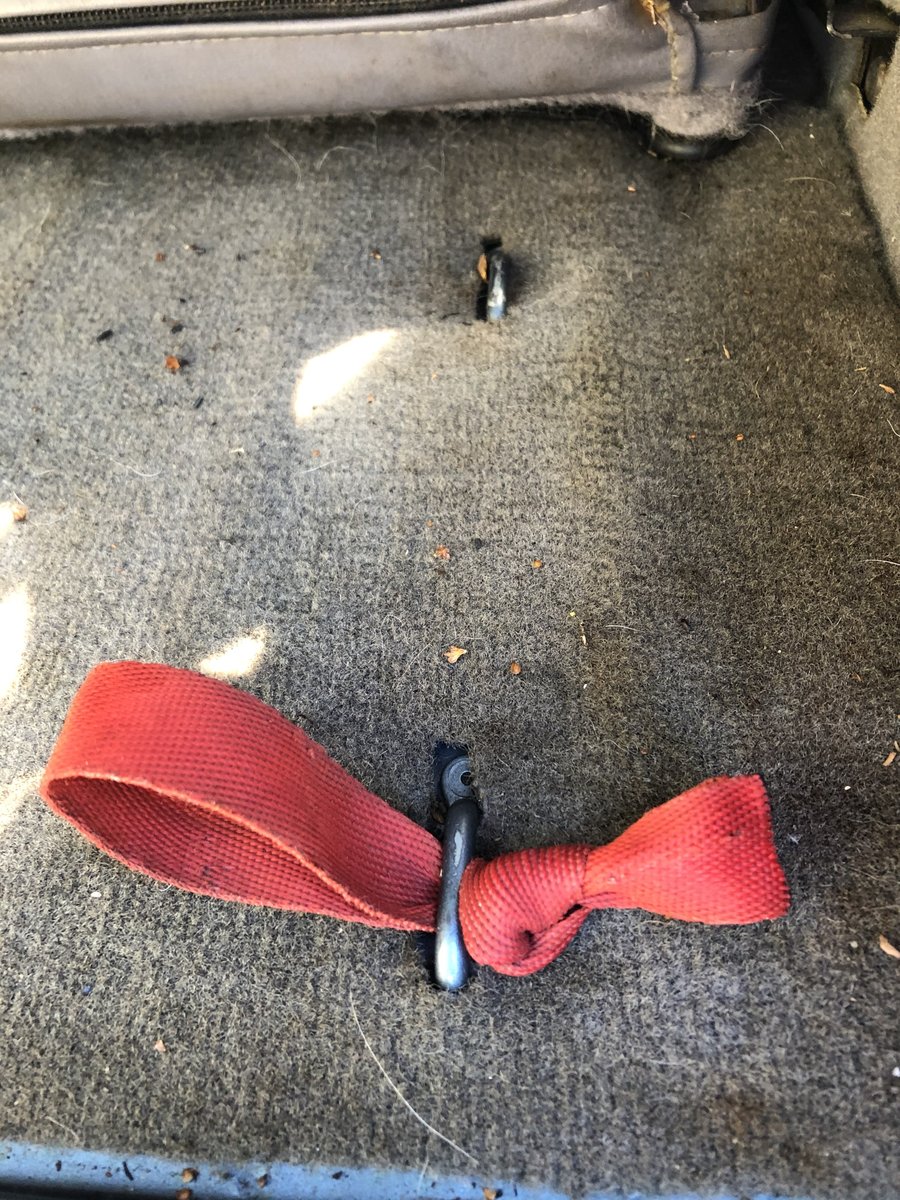

So I had to run to Lowes the other day for some lumber, decided to take the TJ. As I started loading up I realized there aren't any "D" rings in the cargo area to put hooks into.
Never even crossed my mind before.
Super quick and portable fix: Tie an overhand knot in a piece of nylon webbing and slide it in.
Pull it out when you don't need it. No drilling necessary.

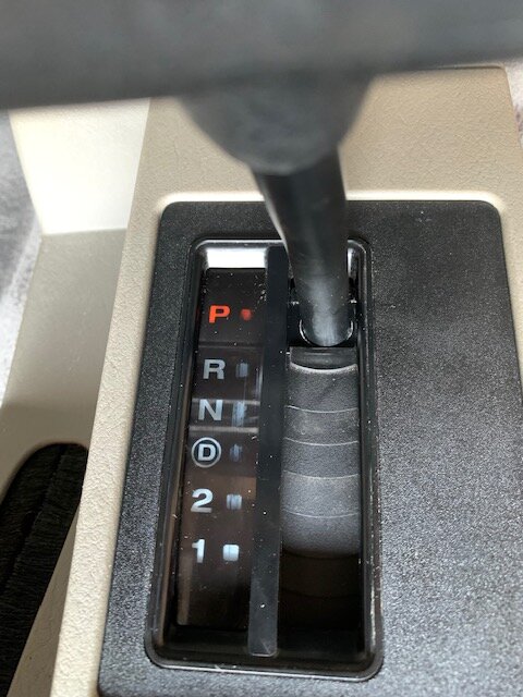

My shift light indicator for my automatic transmission was broken and did not display what gear you were in. A shift indicator is $350 for a new one (no way I'm paying that).
A $3.99 garage sale sign, an exacto knife, a little epoxy, and some time resulted in a new and functional indicator. The orange piece is cut out of the sign in the shape of a capital T. I epoxied the new homemade selector to the smallest piece of the shifter accordion. A hole was made for the new orange indicator to slide over and down the shifter (about 17mm). The accordion looking thing around the shifter handle is factory and slides out of the indicator bracket.
The new indicator is wider and covers the letter/number of the gear you are in too (not just the little hash), which I like better than the stock setup. Thank you for the assist @BuildBreakRepeat
And, I attached illuminated photos for comparison (stock view is dark slate and mod is khaki interior). You can see where the broken factory red tab scratched the indicator windows.
