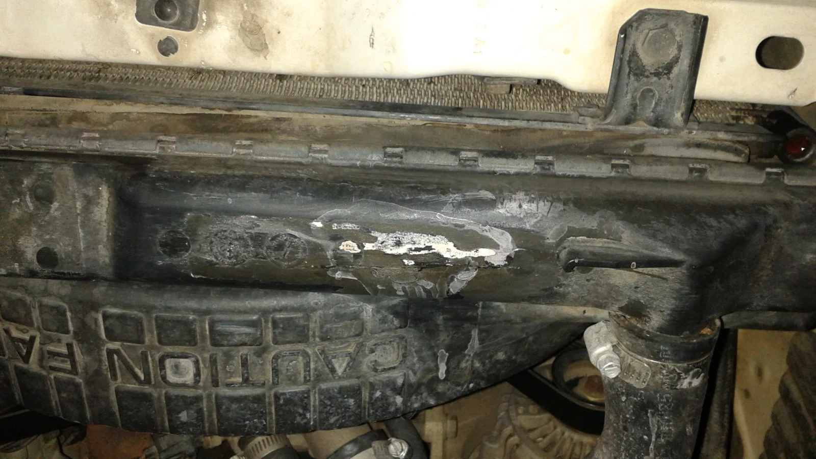

Its summer here, no chance of it freezing. I also mix coolant 50/50. Freeze plug was rusted out so put brass ones in and the radiator crack is actually a large split in the top plastic apparently. Mech reckons there is some issue causing too much pressure in the cooling system. He's chasing a new radiator without charge and I reckon ill take it home once thats put in. Might not be him at fault but I cant handle the stress of trusting my Jeep to be in someone elses hands. I will never afford another

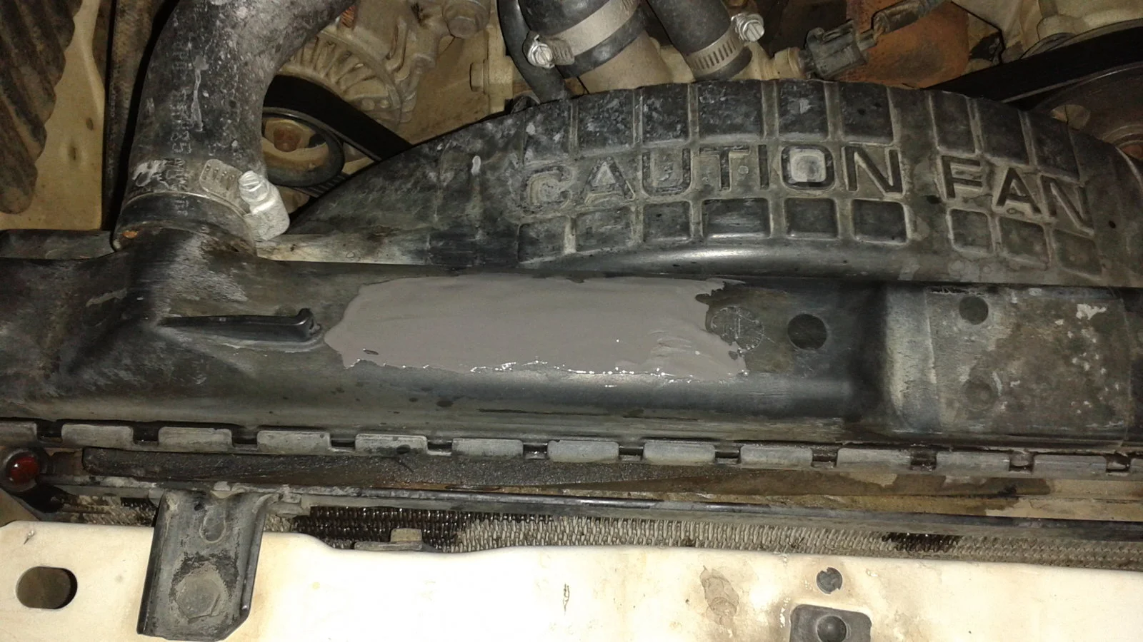

Cracked radiators are fairly common with our TJ's. Mine cracked on me half way to Moab at a gas station in Nevada. Had to JB weld it to get to Moab where I purchased a new radiator. they are inexpensive @ around $115 US.
Thats pretty much exactly how mine has cracked.
