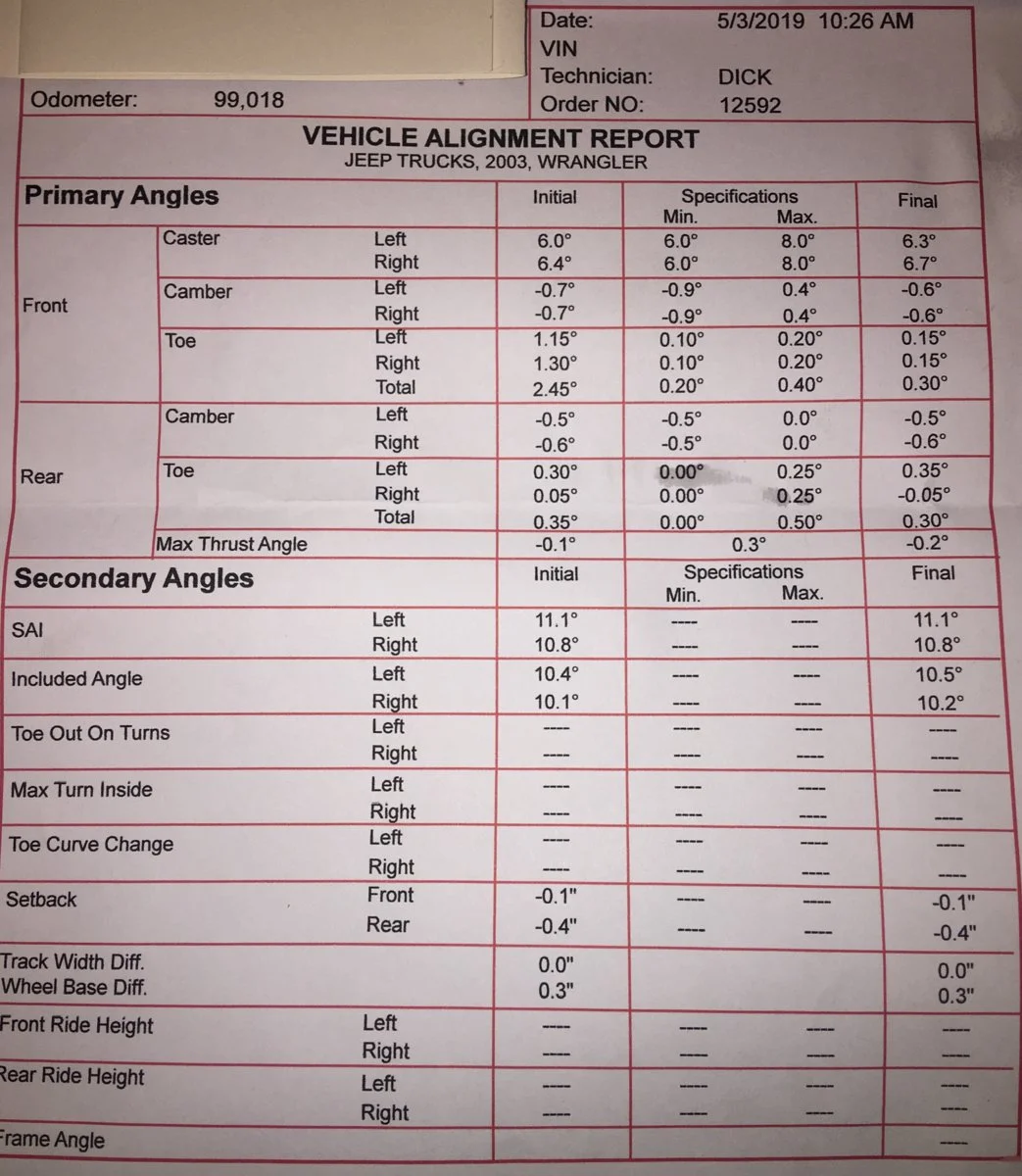

Was thinking of getting road force balancedHopefully that works. At least it would isolate two tires as the culprit(s). If not, you can try to balance again and stress to the tire tech they have to be perfect or you’re just going to come right back.
After that, something is likely wrong with the tires themselves.
