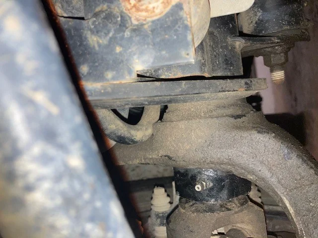

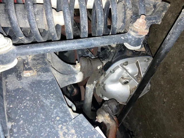

Removed my drop pitman arm last night and I noticed the front axle is shifted to the pass side. I read the posts on centering and all seem to include using an adjustable track bar. I still have the factory track bar, how to center the axle with a non adjustable track bar?

and if it's shifted passenger that might indicate the link is to long, yes?
why is a stock link to long?
who makes an adjustable TB ( a part made for a lifted rig) to be shorter than stock?
we want pics,,,,,,,,,,,,,,,,,,,,,,,frame mount and axle mount.

It is pulled to the driver side. I messed up the original post. I have the rear relocation bracket. I do indeed need an adjustable front bar. Just got the stock pitman on and centered my steering wheel last night. Bar is the next project. Then I need a stock front diff cover and need to fix the aftermarket pass side axle tube seal that popped out. Then my Previous owner issues should be resolved. Well, atleast the ones I want to address right now.
