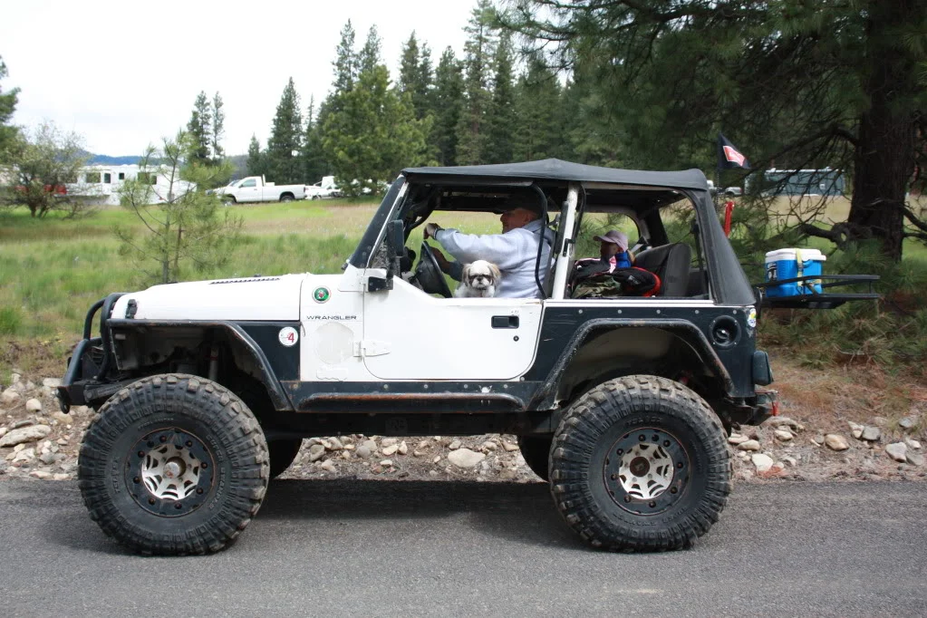

My TJ on a HP44 and HP60 with TSL SX 38x12.5x16.5 which measure out to about 37" tall. They are mounted on Hummer rims in this picture and weigh about 138lbs each. I started off running Alloy USA shafts and Spicer u-joints and it too me 2 years to break a u-joint. Now I have Bobby Longfield u-joints installed. At some point I'll upgrade to RCV shafts also. Mine has the 2 3/4" tubes and my understanding is that your F250 axle should have the 3" tubes. As you know the knuckles & ball joints are the weak area. I have found these ball joints that I am going to try out.
http://balancingrockdesign.com/BFF/index.html
If you are worried about ring gear strength then you can also try this out.
http://www.jantz4x4.com//jantz.php?p=detail&pro=jana_54
