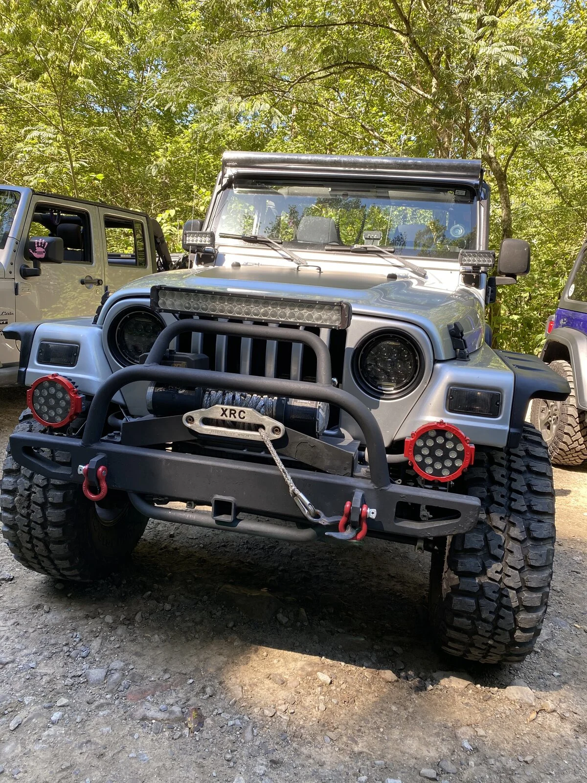

I think this checks all your boxes, winch plate obviously comes off. Don’t know the brand, it was on there from PO. Rock hard or dirtworx I believe.
