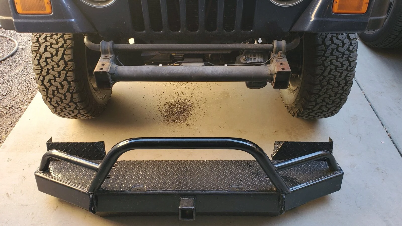

Front bumper with winch plate and integrated receiver mount?
Body Armor and like @Dunkut88TJ says it is no longer made. It's possible Rock Hard bought the rights or made it for some time but mine is Body Armor for sure. I have the rear as well.
I think you are correct, rock hard is very similar, I can’t keep all the stuff straight 🤣
Hahaha What ?!! Oh, no winch plate.
Reactions: Dunkut88TJ
That's a Ranch Hand. Personally, if that top plate is 1/4", I would just drill it and run a winch. Might want to proof it at the winch stall load but most bumpers are designed like that.
If it's not quite thick enough, weld (or even bolt) a pair of backing straps on it and run it.
Edit: Looks like you can simply buy a winch plate for it...
