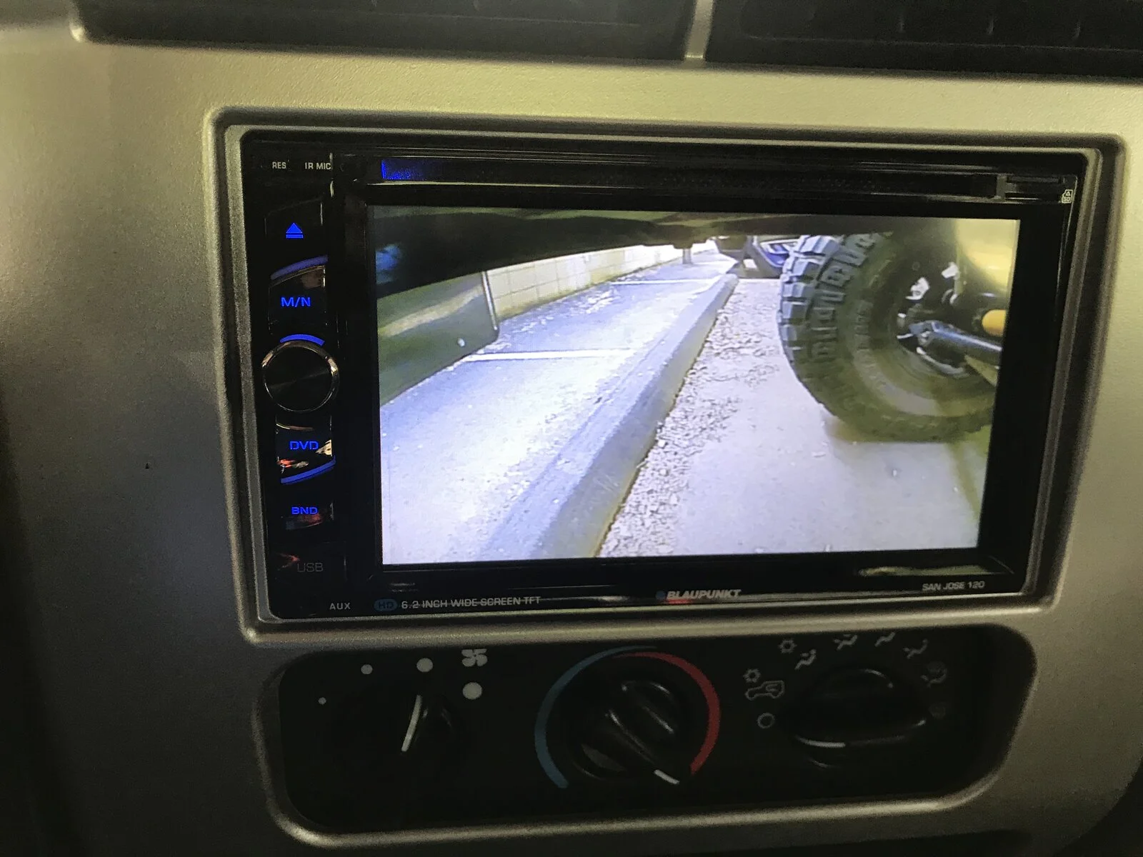

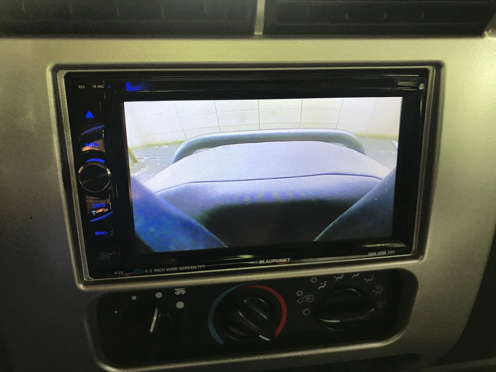

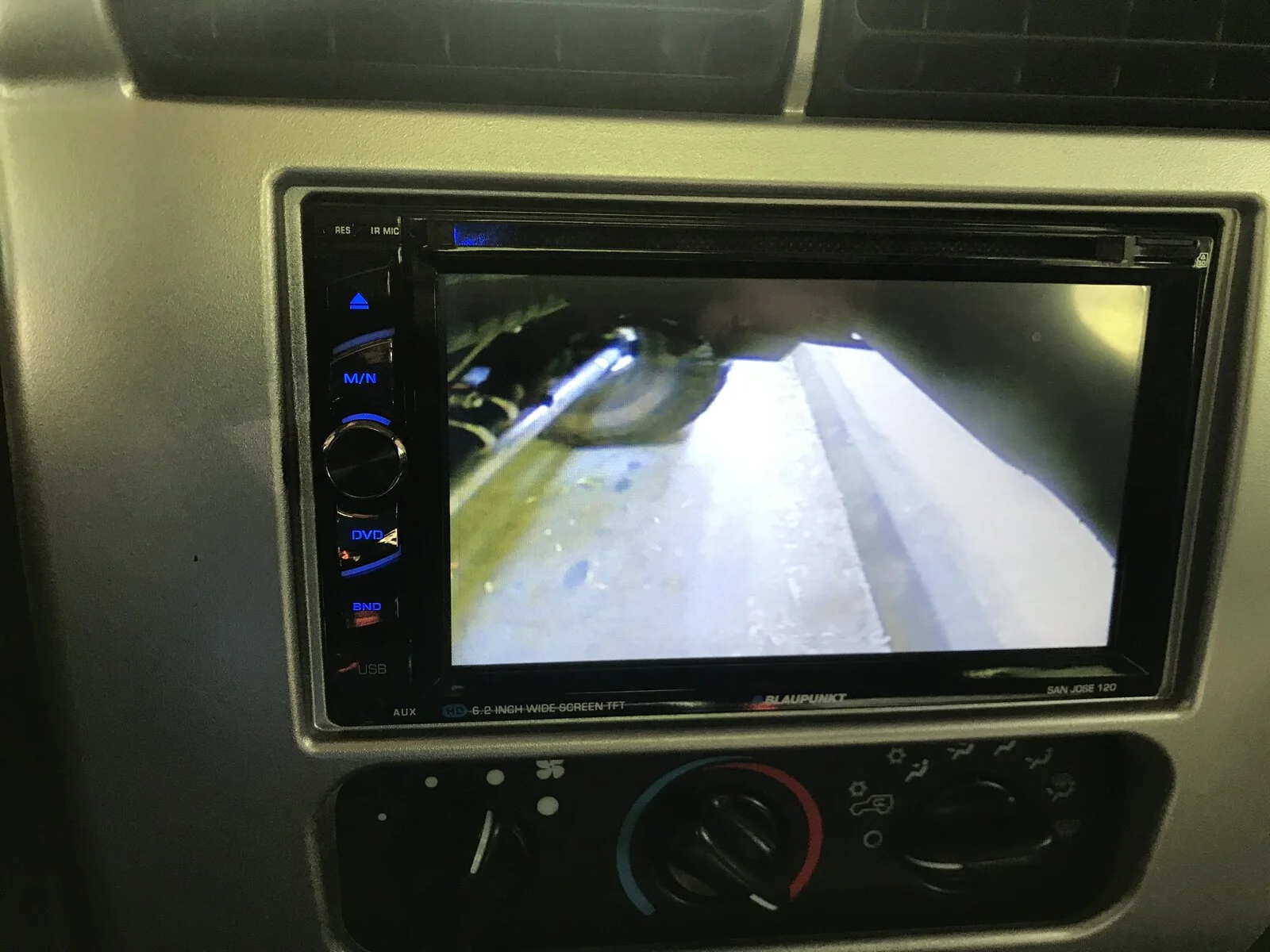

Sorry should have mentioned, I use a SPod to trigger it.

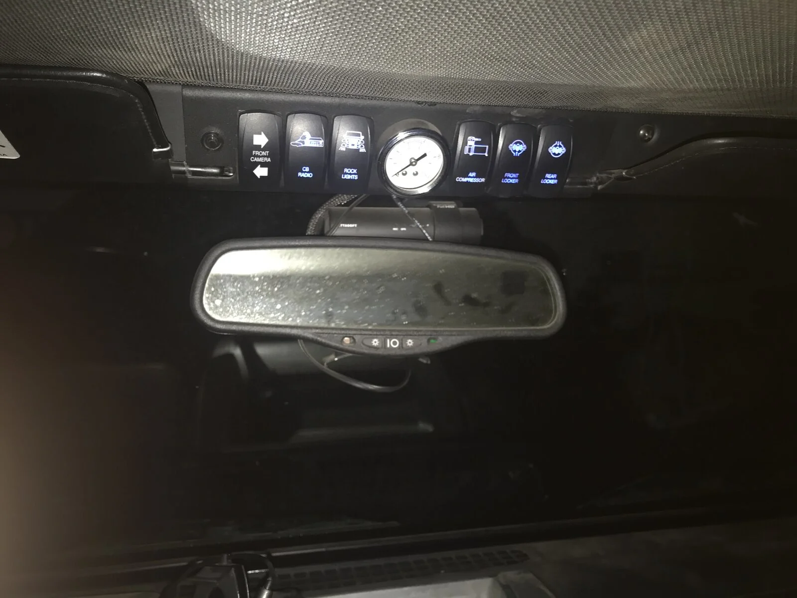

Far left switch: middle position is front. Left or right arrows is a front tire
Howdy, @Apparition ! I'm looking to duplicate your camera system. If you don't mind, can you please tell me where you got that switch on the left above? I tried OTRATTW for a three-position Contura, and they are out of stock until February. I'm hoping there's another source...

Unfortunately I got that switch from OTRATTW.

Sorry - one more question. Is the switch illuminated? I'm trying to figure out the Carling part number so that I can see if someone else has it in stock.

Yes, the arrows on top and bottom are illuminated based on their selection. The part that says front camera is not.

@sab I believe these are the part numbers
VVPZCTS-5001CONTURA V, TURN SIGNAL, ROCKER ONLY
Options:Custom Text: FRONT CAMERA
Etch Style: Vertical (As Shown)
$5.50 1
VED2UXXB-00000-000V-SERIES SEALED ROCKER SWITCH, BODY ONLY, NO ROCKER
Options:LED Color: BLUE LEDs
$17.00 1$17.00
