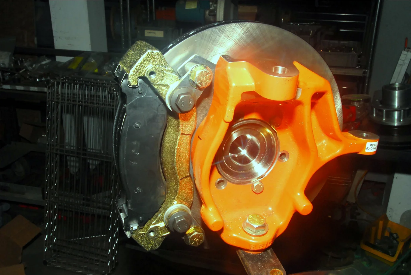

Reid Racing made knuckles for the TJ that were designed to accept mid-70s spindles, bearing, hubs, etc. and also had provisions for high-steer arms.
I am running a set (without high steer arms). However, they were discontinued a few years ago and are probably incredibly scarce.
If you only need 1 side, I believe @mrblaine had 1 side but not sure which. When we spoke some time back, he was hoping to find a mate for it. If he hasn't found one, maybe he has what you're looking for and might be willing to part with it.

I have a left side.
