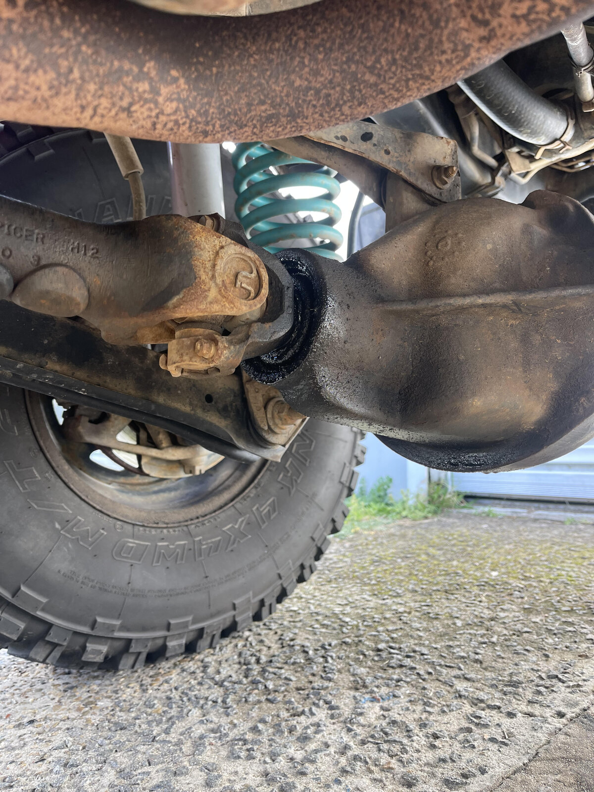

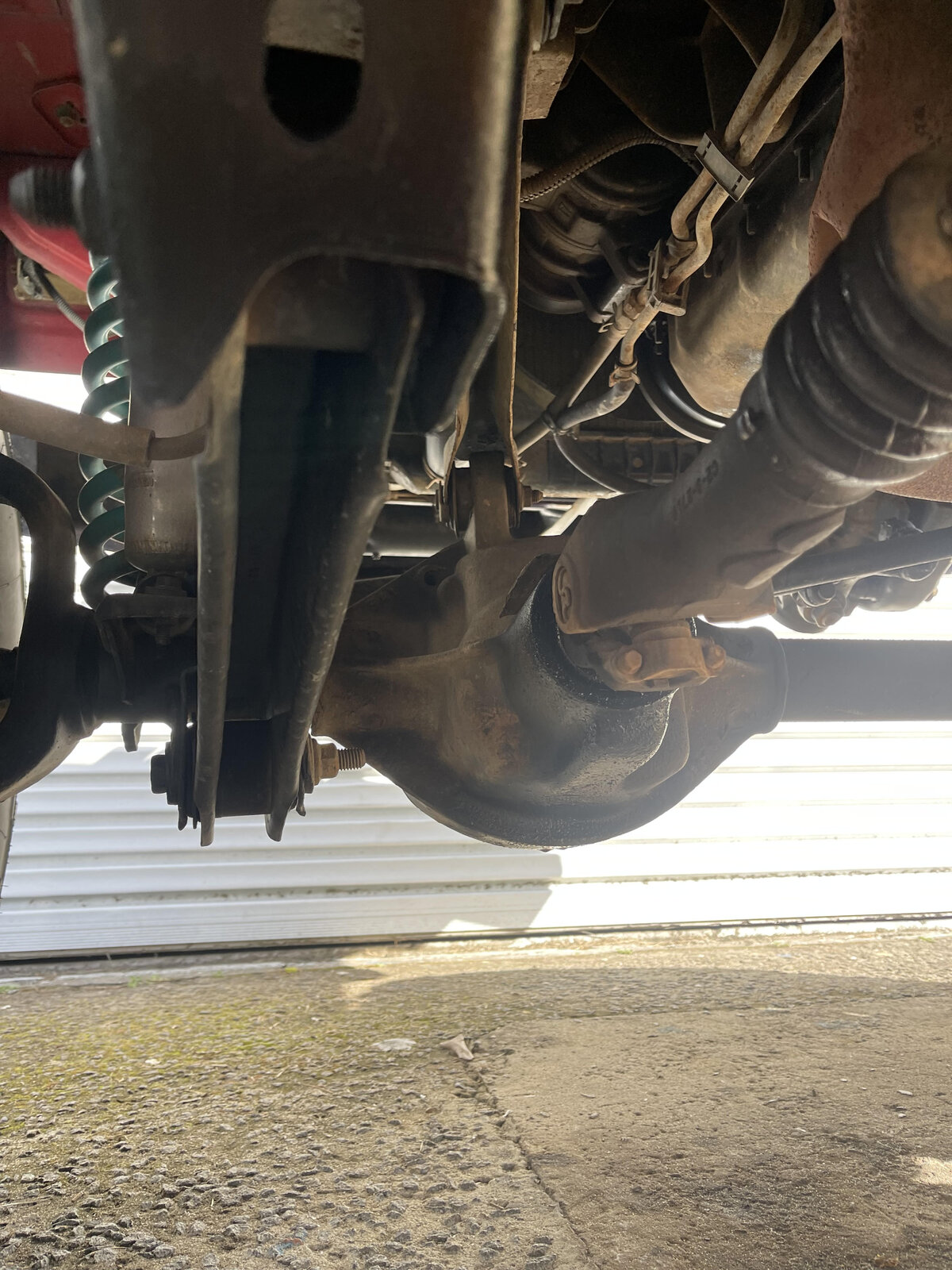

Now, I've got an issue with my front diff / driveshaft and wanted to post some photos on here and describe some of the issues I've been having to get some opinions and help fixing these. Recently, I've had a clicking / scraping sound (I've also heard of angry bird sound or something??) as I initially accelerate and when I am braking coming to a stop. My "general" mechanic (I say general because he is not a Jeep expert) said I've got play in the driveshaft going into the front diff, and it is leaking (as you can see in the photos), and he suggested I take it to a gearbox/diff mechanic. I am mechanically inclined, but I haven't dealt with or done any diff/driveshaft work before, and I don't have a lift or anything like that so I am restricted to doing everything on the ground unless I absolutely have to go and get a jack and some stands. I spoke to the diff and gearbox shop here and they thought based on the above description of noises/play in the driveshaft, it would be a $1100 diff rebuild. So, before I go and fork that out, I have a couple of questions...

Could be bad U joints and bad pinion bearing. Taking the front drive shaft off isn’t too bad. The bolts on the front yoke are like 8mm heads and there are four of them. You can just take the front off of the yoke attached to the front diff and tie it up, or you can take the rear off that attach to the transfer case. You might have to drop the skid plate to get to them. I took mine off when I had my floor pan cut out so I had easy access. Once you remove the straps that hold the u joints to the yokes you can pop them out with a screwdriver or pry bar.
Might check the fluid level in the front diff. Hopefully just U joint making noise and the pumpkin is not dry. had simular issue. Jeep would make intermittent high pitch sqeaking and figured out the lil needles in the ujoint caps where smoked and was easy fix. If your going pull the drive line make sure you soak em down in penetrating oil and break em loose slowly. If they have not been off in a long time they will snap off in the yoke and there a PITA to drill and extract. taking the front off is pretty easy but on the tcase end you need a pretty short 8mm socket on a 1/4 drive. Every time i have tried to break tcase end loose will a box wrench it strips so i wouldn't advise that. Hope that helps ya.

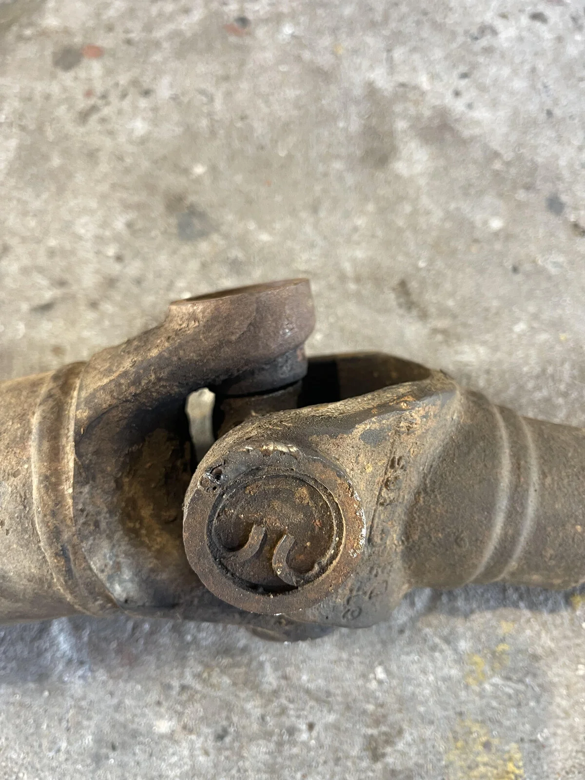

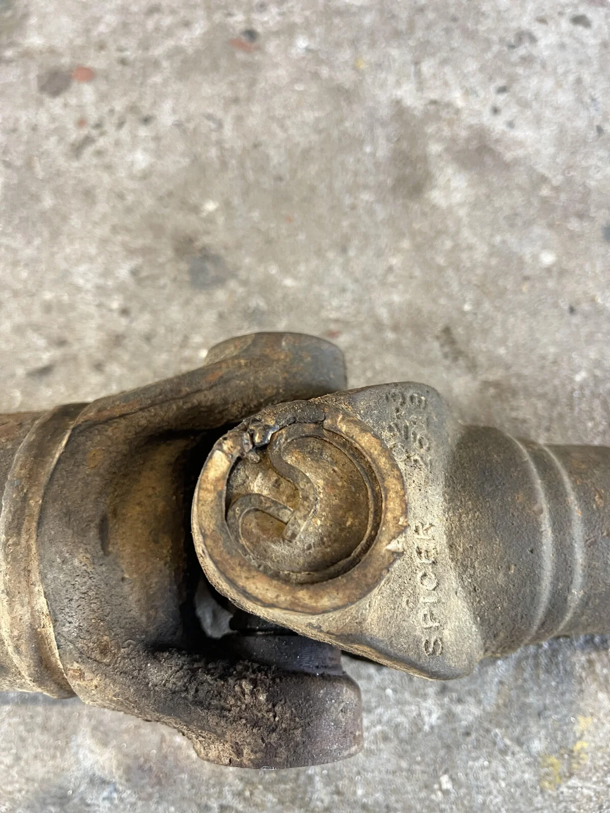

I got the rear driveshaft off. One of the u-joints is gooooone, and I believe its my culprit. One side of it is very loose, and the grease insert is actually gone from it, there was just a hole there. The other u-joint had the grease gun feeder and looked fine. I haven't taken the u-joints out, hardware store isn't open yet for me to grab a couple tools I need to get those apart.
The other good news (kinda, maybe?) is that when I got the rear driveshaft out, I noticed some very shitty, dodgy home welding job to repair the yoke(?). Looks like whoever did it welded the yoke to make sure the clip stayed in. I've never repaired or done any drivetrain work before, but my guess is that isn't normal, so it's good news that I found that.

that's the top end slip fitting yes? so that would be the transfer case output yoke, if i'm not mistaken.
google that spicer # it' should bring up something. they broke the snap ring groove and jimmy rigged it.

Yep, the part that goes into the transfer case.
