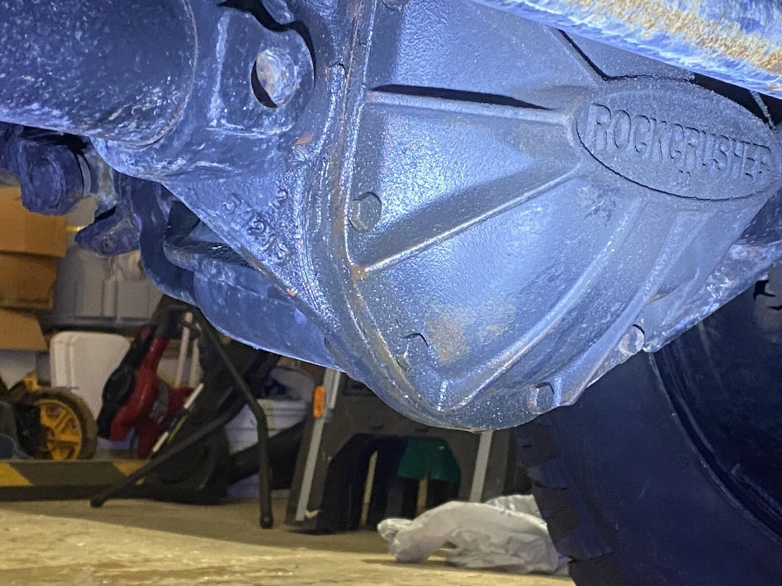

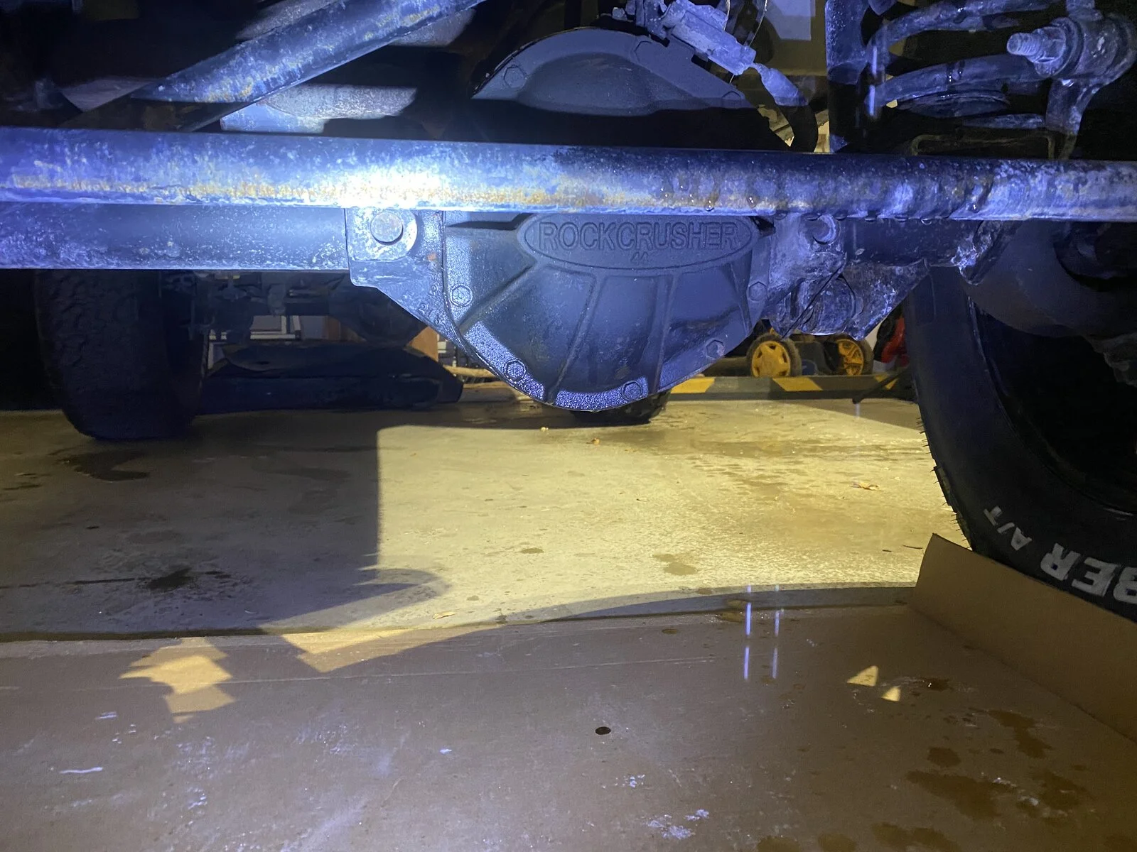

I couldn’t wait for warm weather. I pulled the Jeep into the garage to have a look.
It looks like it is leaking from the seam of the differential where the horizontal rib is in the first picture.
There is no oil on the top. It is running down the seam and drips off the bottom. It’s been in the garage for less than an hour and there is already a dime size drop of oil on the cardboard underneath.

GAsket replacement
you need a gasket get a Fel Pro you wont need gasket sealer for a fel pro gasket
a scraper to scrape the gasket off the diff cover and the diff housing Putty knife and razor scraper
and a socket think its a 13mm and a ratchet
Diff Oil
Brake cleaner for the diff cover and rags
and a drain pan to catch the diff fluid in when you take the diff cover off
1. put drain pan under diff housing
2. clean the diff cover with brake clean before removal
3. use the 13mm ratchet to remove bolts
4. gently pry cover off with a screw drive. tThis when the diff oil is going to come out in hurry
5. clean all the gasket off of the diff housing be careful not to get any pieces of gasket material in the diff housing a towel stuck aroung the ring gear helps
6. clean the gasket off the diff cover
7. wipe both gasket surfaces clean with brake clean (the diff housing and diff cover)
8. clean the bolts
9. put a couple of bolts through the diff cover and hang the gasket on the bolts
10. get the 2 bolts started in the diff housing
11. get the remaining diff bolts started and all of them finger tight
12. tighten in a crisscross pattern you should use a torq wrench for this do not over tighten
13. remove drain plug from diff cover and fill with correct weight diff oil till it just comes out the fill hole you are putting it into a piece of rubber hose over the pointy end of the filler on the oil bottle makes this a lot easier or an oil pump filler for a lower unit for an outboard boat motor is what i use
15. clean the fill / Drain plug and reinstall
16 this is a good time to inspect the for metal shavings the fill is a magnet and will collect the metal shavings there

Yes, it’s water. The ice is melting off the Jeep.

Side Note- personally I would take that aftermarket cover off and put a stock dana cover back on. The factory covers are designed to direct oil in certain directions inside the diff for lubrication and cooling Check out Gale Banks diff cover video on youtube.
