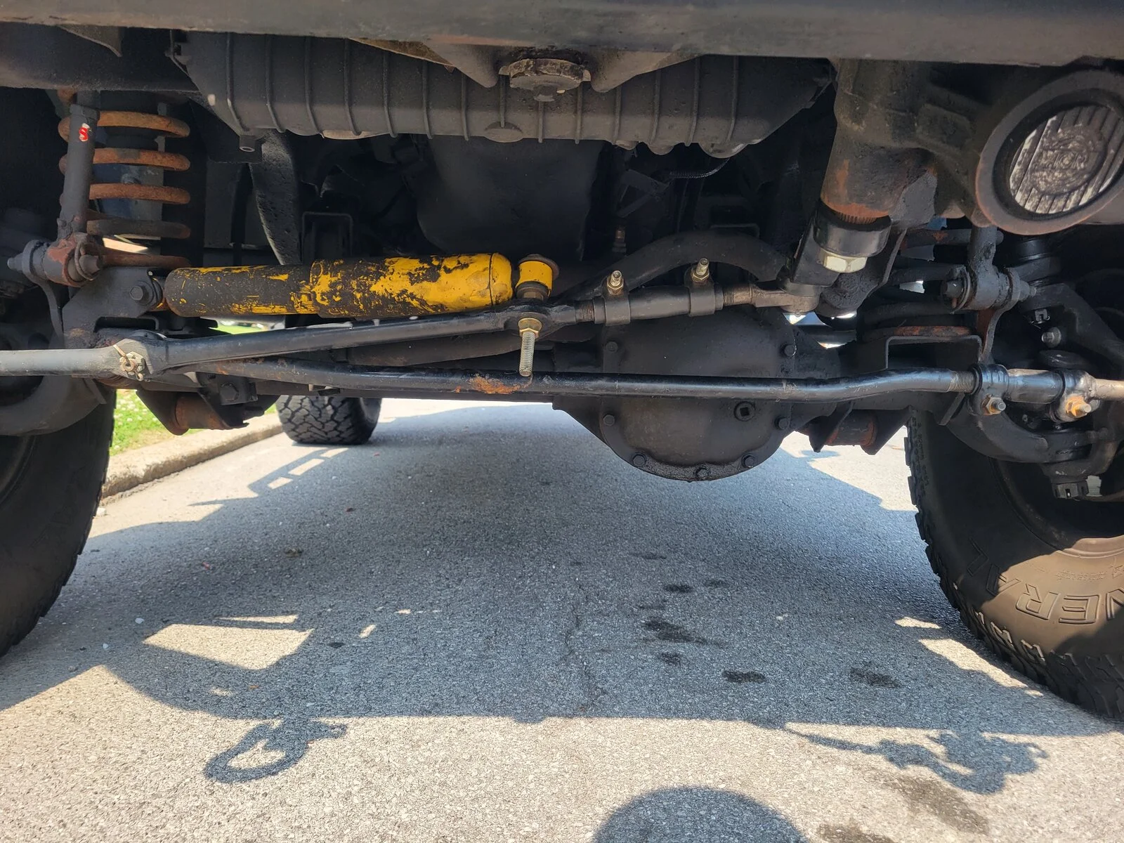

So I went under and checked all spings and found no issues, i replaced the 2 front shocks and it still bounces when i hit a bump at 30, it bounces really bad and you have to brake to about 15 until it stops. How do my angles look in the pic? It has the dropped pitman arm and droppes track bar bracket but those have been on for years with no issues.

Also your dropped pitman will cause bump steer and the track bar axle end bolt is not familiar, I’d want to know the condition of that joint as larger bolts sometimes indicate 2 piece urethane bushings are used-

So I went under and checked all spings and found no issues, i replaced the 2 front shocks and it still bounces when i hit a bump at 30, it bounces really bad and you have to brake to about 15 until it stops. How do my angles look in the pic? It has the dropped pitman arm and droppes track bar bracket but those have been on for years with no issues.View attachment 267261
The Pittman Arm and nut looks new, but you said it's been on there for "years"? Did something happen that it needed to be replaced?

The front end bounces hard , you can see the whole front end bounce when it happens. Ill take a look at that bolt but i do believe its a oem bolt as i replaced the track bar about 3 years ago.

Its about a 2 months new, i replaced it with the same 1 that was on there. The old ones teeth wore out for some reason and it had a ton of play. I thought death wobble was felt in the steering wheel? What im experiancing isnt felt in the steering wheel at all. Imagine your front end boncing and maxing the shocks thats what it feels like. It slams so hard its not funny, and it only does it if you hit a bump first.

Hard to tell From the picture, but it looks like maybe a new unit bearing and ball joints on the drivers side? I see a clean unit bearing bolt while the rest of the underside is pretty grimy. Also, the ball joint nut looks like it could use a few more turns? I would get the torque wrench out and just double check everything is torques to spec and that the ball joints and knuckle are fully seated.
