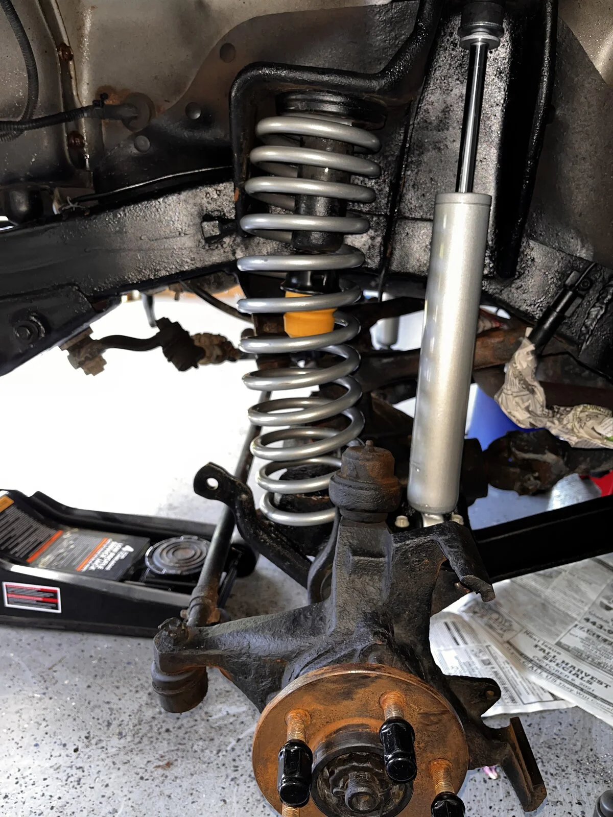

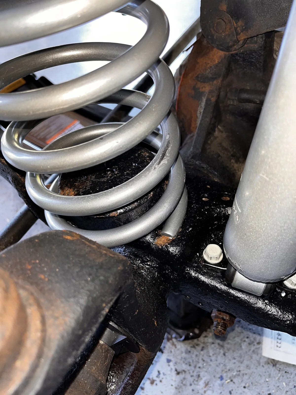

Hey guys so I am installing a RC 2.5 inch lift on my 2000 TJ.
Why on earth is the drivers side coil bowing like this (see pics)
I swapped sides and no matter what coil I put in it bows. As you can see the pig tail is in the split. CA’s (bottom) are loosened. And even when I put the tire back on and tighten everything to spec it still bows like you see.
Any ideas?
The passenger side is fine, only the driver side is doing this.

Have you put the wheels on and basically loaded the suspension or are you still at the assembly stage

Yes I have and it’s the exact same thing
Have you measured your distance wheel to wheel on each side
Also rough country has good customer service- They will actually take a phone call which these days is considered good
I called RC and all they could say was “that’s weird” and once it’s under weight it’ll be ok. None of what it true lol.
If I’m measuring distance wheel to wheel what is the midpoint? Midpoint of axle?
Anywhere- it doesn’t matter- As long as you do it the same on both sides
I would measure tire to tire for instance
I can’t think of any reason why you would have an axle off that dramatically but you’ve got something going on- It almost looks like the spring is too long for the application
Yeah but it doesn’t bow on both sides so I can’t imagine the spring is too long. I swapped sides and it remains only to bow on drivers side
Very frustrating tbh
Yes- there is a cause-
Keep at it - post that measurement- It would take some pretty worn control arm bushings or something to have your axles that misaligned - we can see it is installed correctly
Jouncing in up and and down to relieve bind after install is good to do
Well it is a 22 year old Jeep and everything was original hardware on it. Shocks, coils, end links, calipers etc
Though it only has 56k on it there was some serious dry rot and rust
