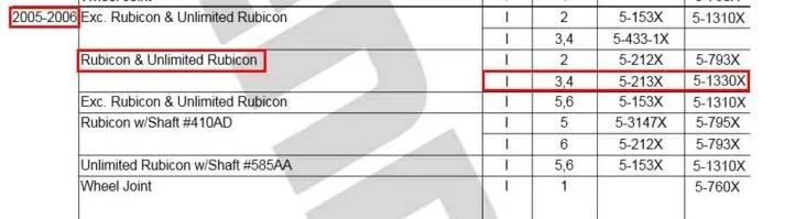

For the front driveshaft's very front u-joint you want a Spicer 5-793x.
For the front driveshaft's two rear u-joints inside the CV you want a Spicer 5-1330x.
A great webpage and site for this information is at http://www.dennysdriveshaft.com/p22...2003_to_2006_jeep_tj_rubicon_and_unlimit.html
The 5-760x is for the axle shafts, not for the driveshafts. And I would stay with the sealed non-greasable u-joints which are the p/ns I suggested above. :)

Finally, that chart I gave the link to above gives a complete list of all u-joint part numbers for your Rubicon. :)

And regarding knowing what u-joints you need for the rear drive shaft, have you still not looked at that u-joint chart I gave the link to above in my first post? :D
j/k... here it is....

I looked at that link, but my rear driveshaft isn't the stock one, and I'm not sure if Denny's and Tom Wood use the same u-joints in their custom rear driveshafts.
Oh, I didn't know your rear driveshaft was aftermarket... all bets are off. You're gonna have to ask whoever built it for you. You can also measure the distance between the outsides of the bearing caps to know if they're a 1310 or 1330 size, they should have used one or the other. The diameter of the bearing caps are the same between 1310 and 1330. Measure the distance between each pair so you know if they're a 1310 to 1330 converter u-joint. There would be a different distance between each pair if it's a converter u-joint. I.E. 1310 on one side and 1330 on the other side.
