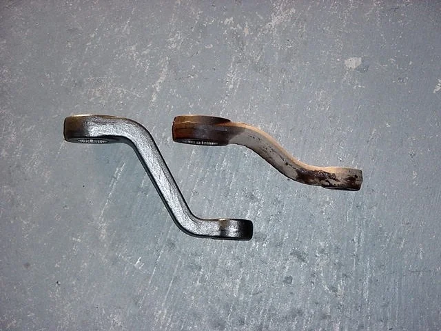

Does it have a dropped Pitman arm installed on the shaft that comes down out of the steering box? If you don't know, post a photo of it from the side....
This shows what the Pitman arm looks like... the one of the left is dropped, the one on the right is the factory non-dropped Pitman arm. Not all dropped PItman arms are dropped as far as the one on the left but if it's dropped more than the one on the right, it's a dropped Pitman arm which screws up the steering geometry.
Hopefully the previous owner cluelessly installed a dropped Pitman arm which makes the cure easy... replace it with a factory OE PItman arm.
