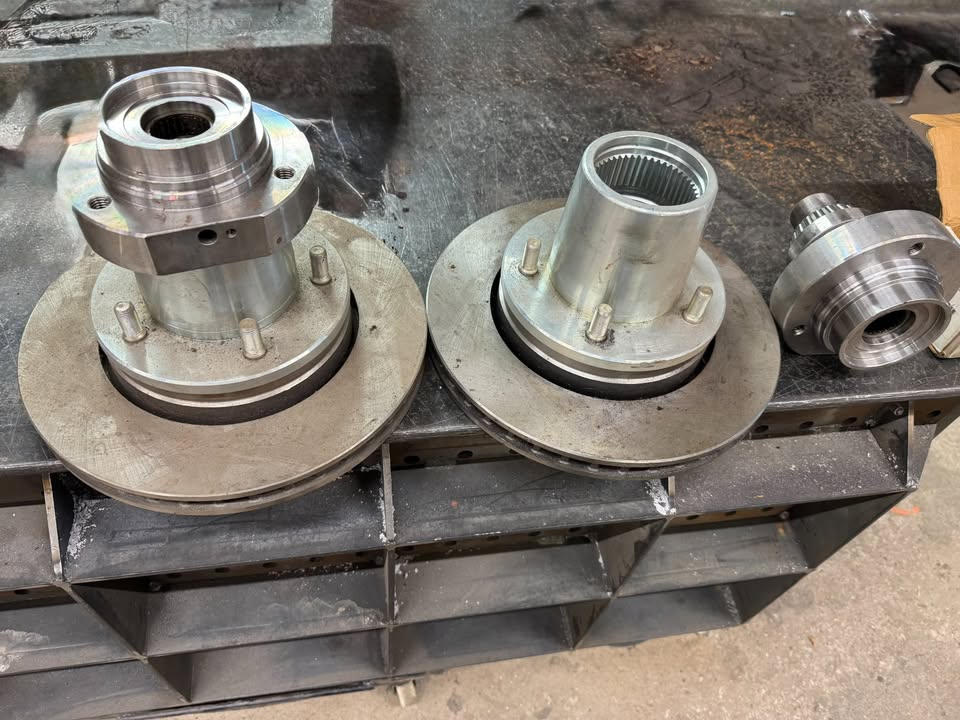

Been reading this thread and a few others. I have the opportunity to pick up a NOS Warn big hub kit (5 x 5.5). I believe it is an old Warn kit anyway. The pictures show a "flat spot" on the spindle, which appears unique to Yukon/Warn. View attachment 658823
It may be an older Yukon kit when they were still using the Warn Locking Hubs. The shop that has it bought it from another shop in a "going out of business lot" so they don't have a ton of info He's asking a fairly reasonable price, compared to what they are selling for on Yukon's site right now.

Now that I'm not in a hurry to get done before Kat time. Yes, I have experience with the big joint shafts and hub conversions. There are 2 solutions there. Get rid of the big joint shafts or build a stub shaft that is JK joint on one side and hub conversion on the other. What I don't know is what the JK hub conversion is using. Unless it has changed, the JK hub conversions are only made in the 5.5" bolt circle. What I don't know is if they are using the JK joint. If they are, then we need to put eyes on the stub shaft to see what it takes to use it as is or adapt it to an existing TJ conversion.
Regarding the above kit. That is not a CJ rotor which is what the Warn/Yukon kit uses for the 08 kit. Warn had the customer turn down the OD on the CJ rotor to get it to fit. Yukon does it for you. I can get some pics later to show what that looks like with a diameter and then the diameter and thickness of the JK stock front rotor as a comparison to see if perhaps we are looking at a JK conversion. See if you can get a diameter and thickness on the rotor there.
One thing that would help is to see if they will measure from the face of the spindle where it butts into the face of knuckle out to the WMS. The more I look at it, the more I think we are looking at a JK conversion. The stub shaft also looked longer than the typical one found in the 08 kit but without dimensions, it is hard to know.

That is the Solid JK kit. Reading the description shows it uses the 760 joints. It also has the Speed sensor port.
@mrblaine over and above as always. Thanks for the info and the time analyzing the pictures. Honestly, it would make sense that it’s a JK kit. The shop that unloaded it to Rich was very focused on newer stuff and they did all manner of work (cars, trucks, 4x4 or not).
