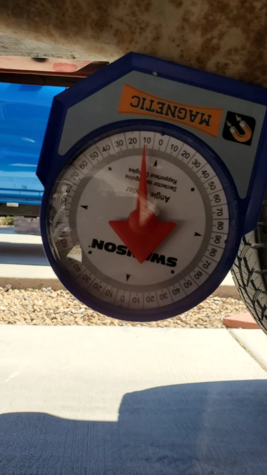

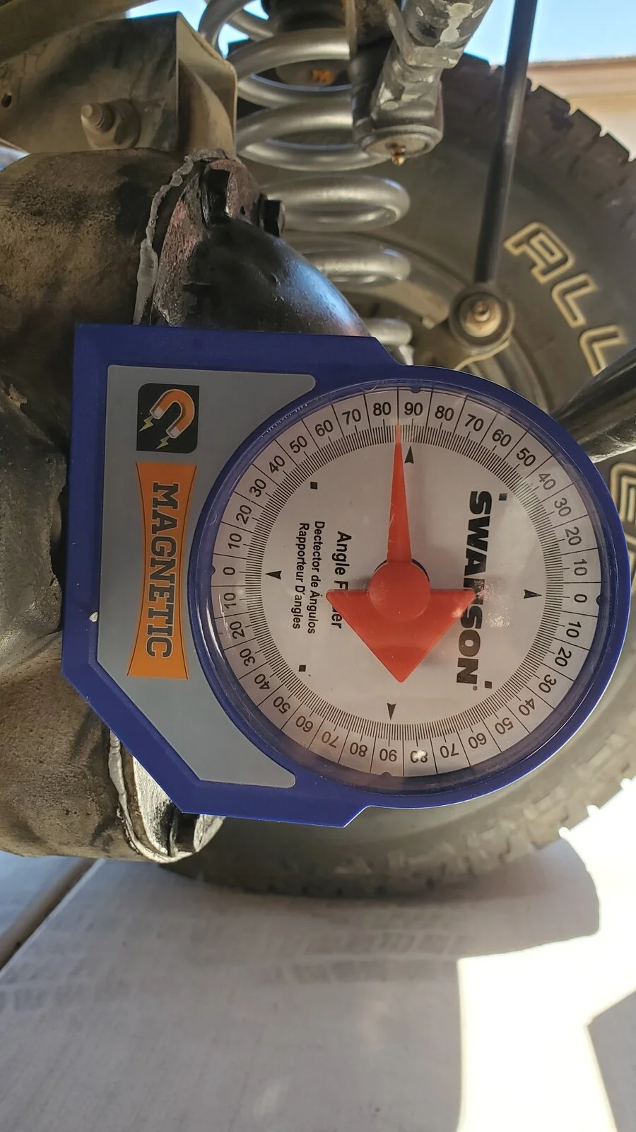

Hey Jerry thanks for the reply. Not sure if this helps, but these are my angles on the pumpkin and the front driveshaft. Looks like about 6-7 degrees of I'm doing it right.
20210606_141103-jpg.257631
The pinion angle itself is irrelevant, what is relevant is the angular difference between it and the driveshaft. Ideally the difference is 0 degrees. But again, the front pinion angle should be fine as-is. The front driveshaft is way longer than the rear driveshaft so it is not nearly as affected by suspension lift height as the rear axle's pinion angle is.
Your speed sensitive shimmy is no doubt a tire problem, very likely simply not well balanced enough.
