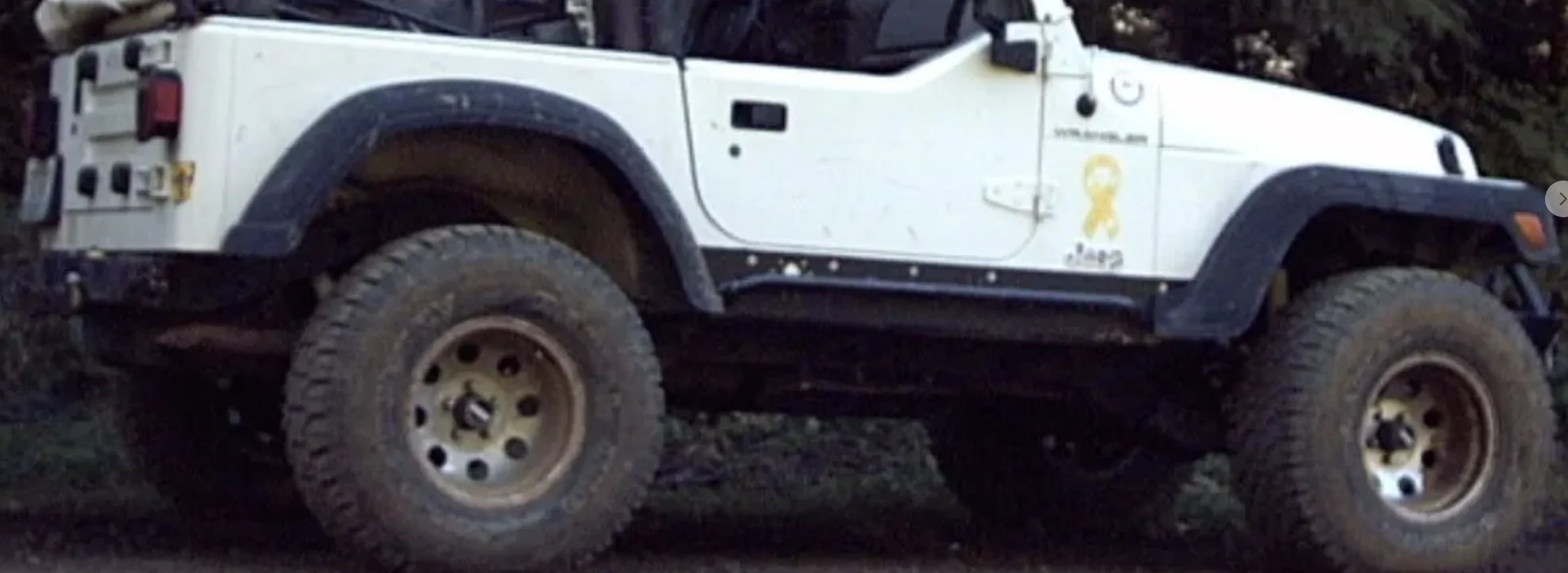

Had an Jeep come into my business with locking hubs on all four corners. Don’t recall all the specifics, except that the owner had done the install.

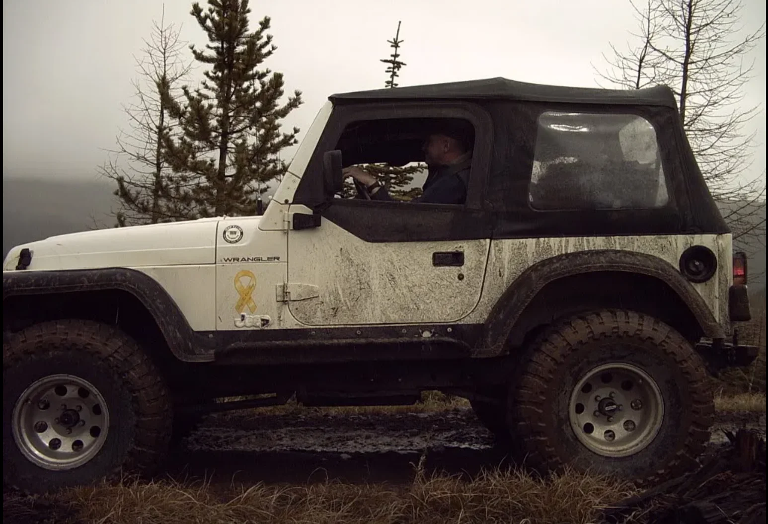

He did. Was a now long gone Warn full floater kit. Unless you are lucky enough to stumble onto one in a garage sale you will be hard pressed to find one.
Yep I had the Full floater kit from Warn for the Dana 35 with small hubs and a Warn small hub kit on the front also... If I'd only known in 2006 when I was building my TJ the first time how hard these would become to find I'd have held onto the parts.
You can't really see the hubs on the front because the sticker had fallen off.
I knew I had a picture of the other side some place. Both hubs had the stickers still.

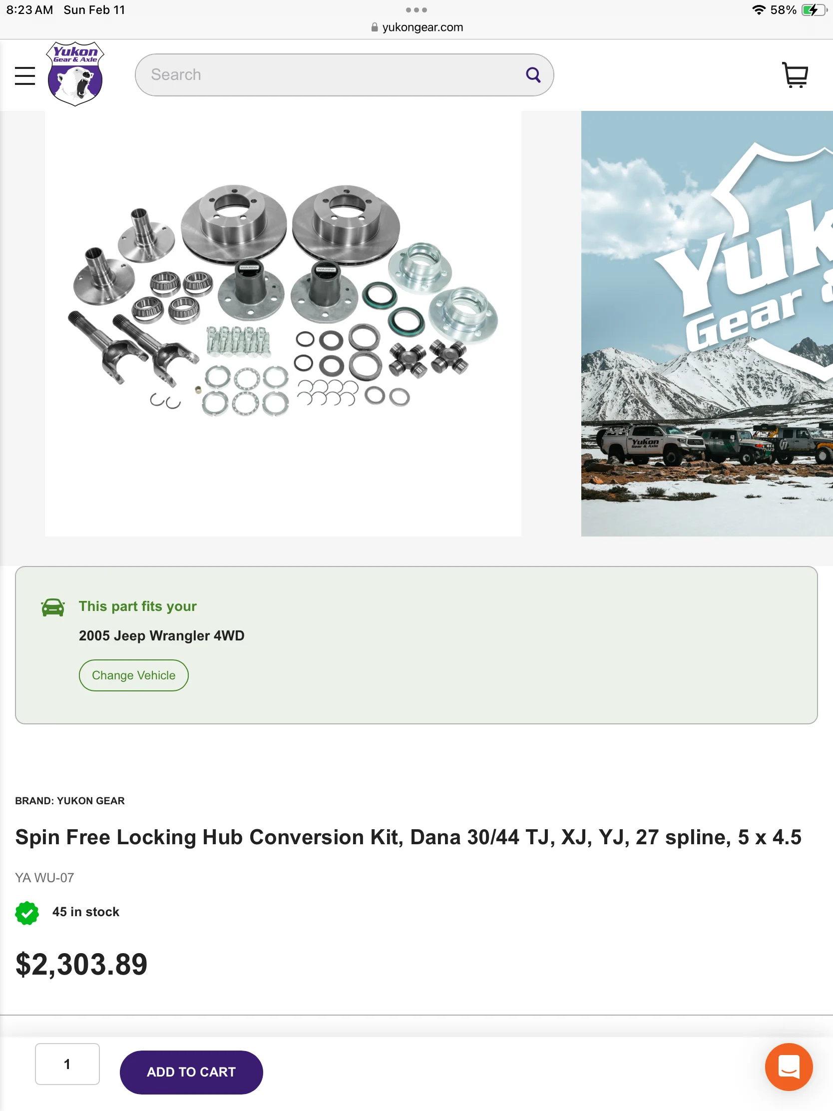

The only FF kits I know of now being offered are from The Herm the Overdrive Guy and those are for old school Dana 44's.
https://hermtheoverdriveguy.com/30-spline-full-floating-axle-kits
Could you use some of the parts to make your own FF kit I'm not sure.
