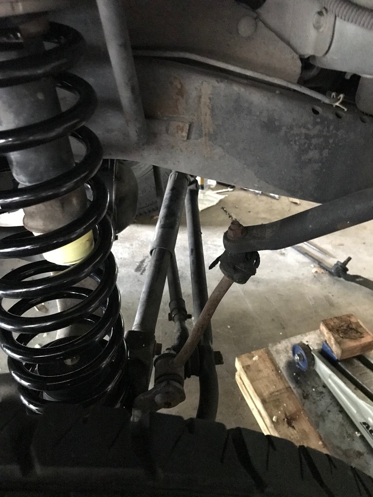

So I installed ProComp springs that are 2.5” taller than stock and Rancho 5000x shocks (55239 and 55241). I did the following test on the front: with the track bar disconnected but the sway bar link connected on one side, I started lifting the frame on that side, the suspension extends and eventually what stops the extension is the sway bar. This seems like it wouldn’t be good for the articulated end of the sway bar link. I could get longer sway bar links, but then what would stop the extension? Or will the extension be a lot more limited once the track bar is back on?
This is what I mean:
I lifted that side of the car until the suspension stopped extending. At that point what's keeping it from extending any more is the sway bar. The shock has another 1.75" to go and the spring is almost fully decompressed. It just seems wrong that the sway bar link is what would limit the extension.
If your non-stock shock travels exceed the range of the stock sway bar links, then you run the risk of putting the ball and socket into a bind and breaking it. The bottom line is that you need longer links or a link with a greater range of motion.

The primary reason people disconnect the stock front is because the stock front is very stiff and will typically resisting articulation before the links become a problem. However, a suspension lift moves the stock links past the middle of their range of motion causing them to reach bind on the droop side earlier than they were ever intended to.
Why? Its doing what it is designed for. That is it's attempting to keep both sides level. As one side droops the swaybar limits its travel and eventually stops it. This is why folks use disconnects.

I don't think the OP knows what he wants for sure, but he certainly needs some longer front sway bar links. I didn't mess with trying to find some longer one's that will simply bolt on in the same way the stock one's do. In fact, I just tried to find some and couldn't. Doesn't mean they're not out there, but most people go with the JKS quick disconnects. These are adjustable and you can disconnect them when going off-road, which is valuable for getting more articulation and performance off-road. Choose proper length for your lift.
It sure is , and get out in the woods and something is gonna give possibly .
