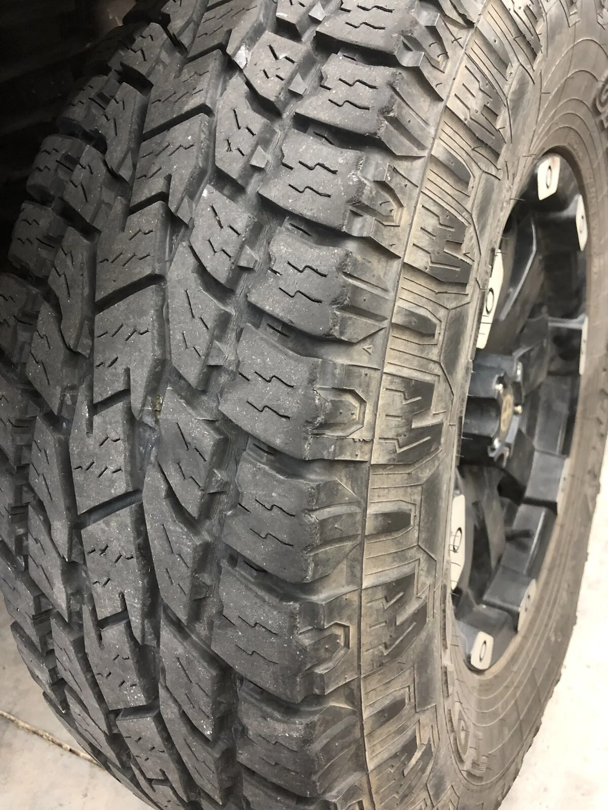

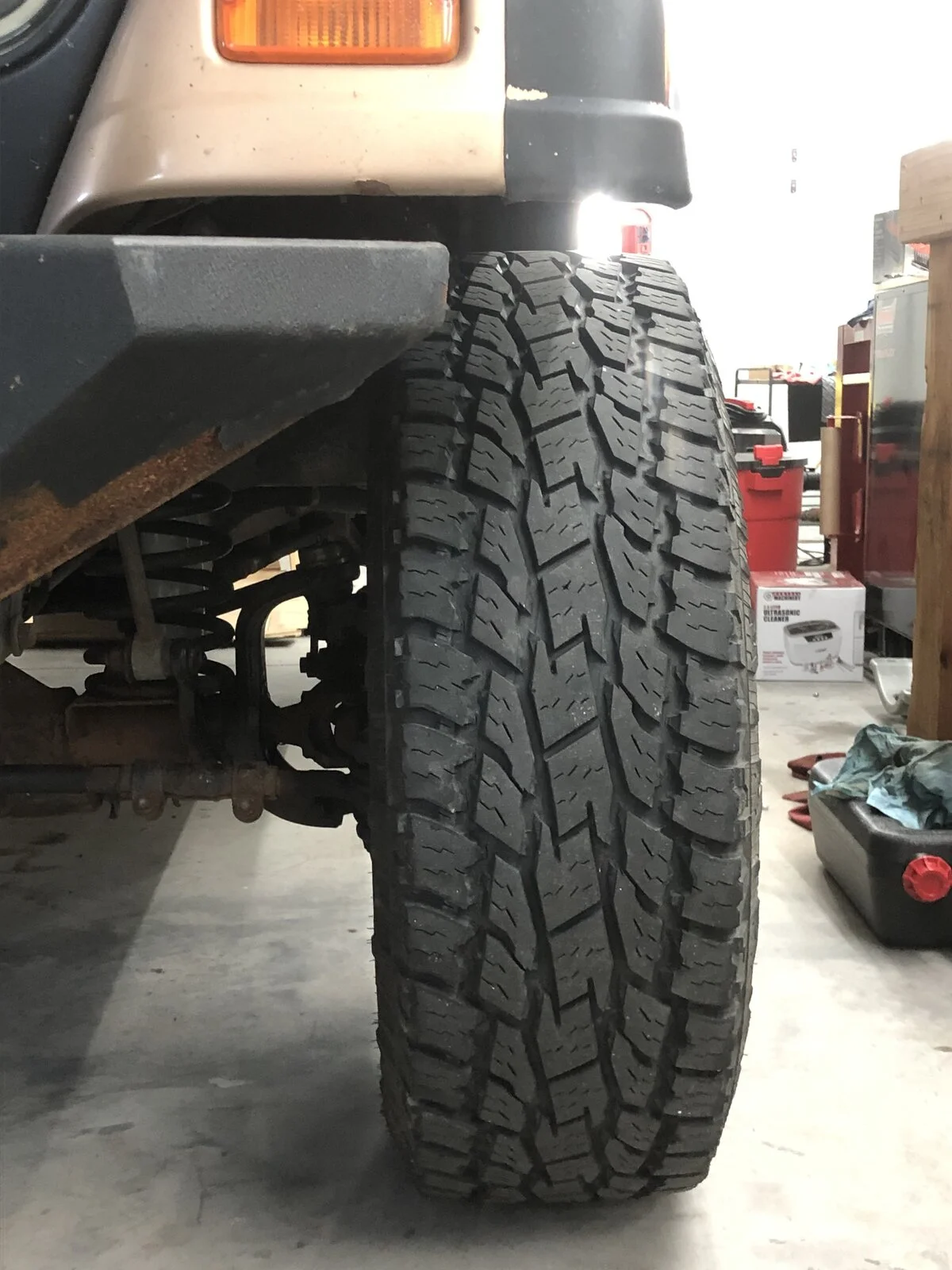

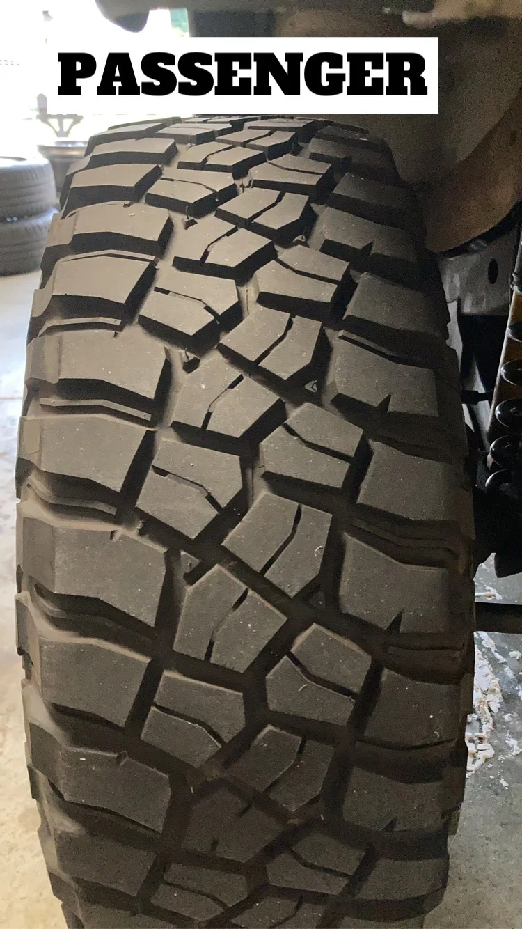

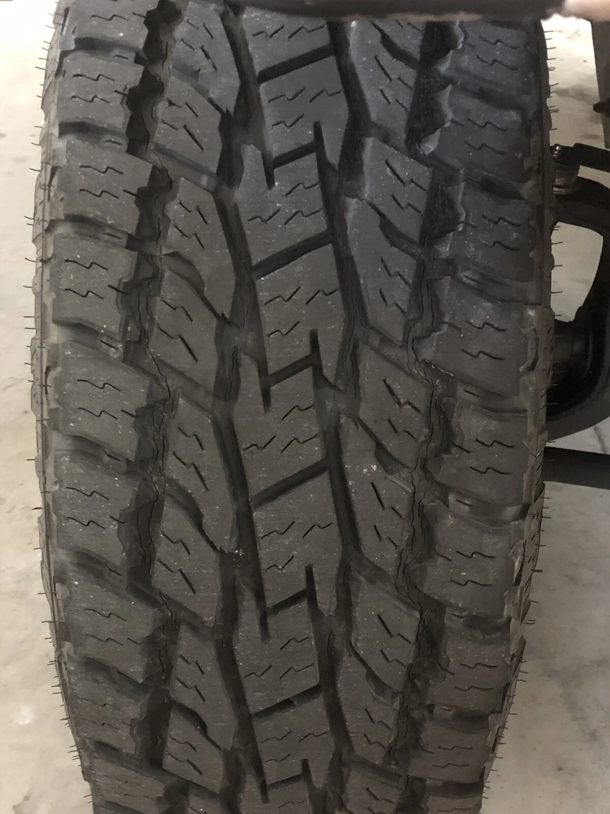

Recently noticed that my front tires are cupping HORRIBLY. I am running 33x12.50x15 BFG km3's. The rear tires are all evenly wearing and look much newer than the front ones do. The set has probably 9-10k miles on them. They were originally on my TJ and I rotated them at the 6k mile mark. At that point there was no irregular tire wear. Since then I got rid of the TJ and purchased an LJ and swapped all the parts. Since they have been on the LJ, they have started to wear badly on the front and started to howl and cup. I did align the tires when I first put them on. I can tell now that it is not aligned anymore because the jeep will pull to the right and the steering wheel is not center. Also sometimes when turning the steering wheel I hear a loud pop noise. Nothing is rubbing so I'm not sure what the noise is. Maybe a bad track bar bushing or ball joint? I am also on stock control arms right now so could it be improper caster?(2.5 in suspension lift). I needed a beefier tie rod anyways so I bought the ZJ tie rod and am going to re-align and check all the components when it comes but I was wondering what things specifically I should focus on. I will also probably rotate the tires so they don't cup any further but I really don't want the current rear tires to move to the front and start cupping as well.

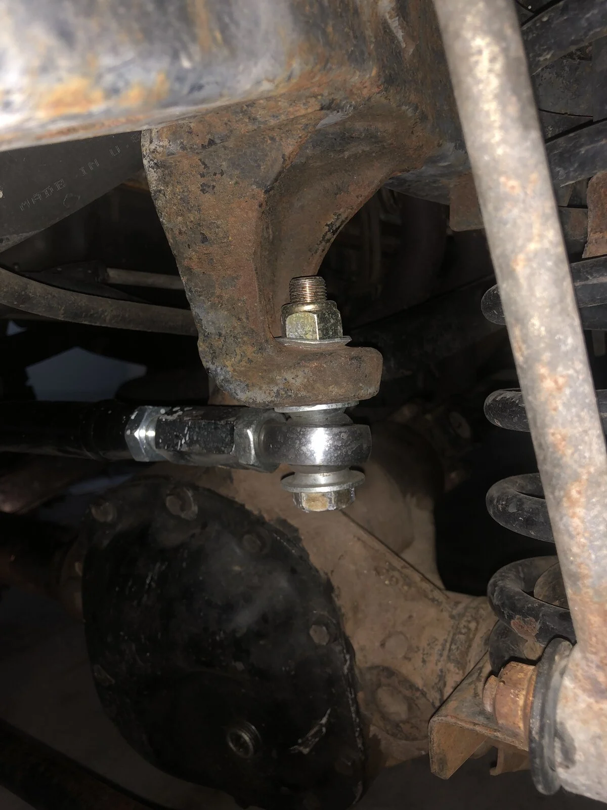

Did a dry steering test and didn’t see any play in the tie rod or drag link end but I did notice this slop on my track bar. Does it just need to be tightened or is the bushing bad? I believe I had it torqued to spec

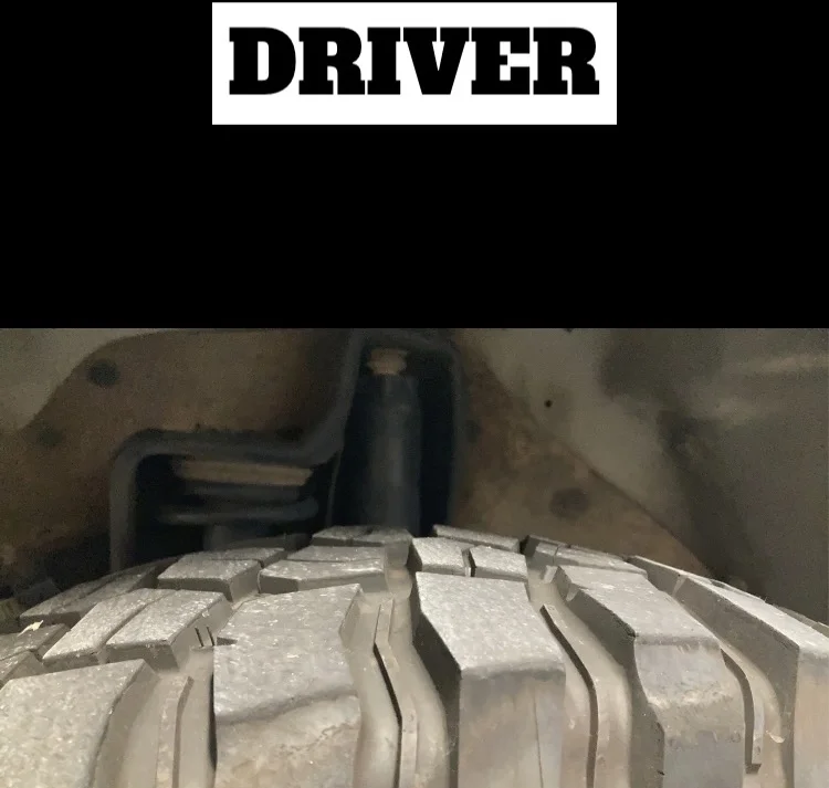

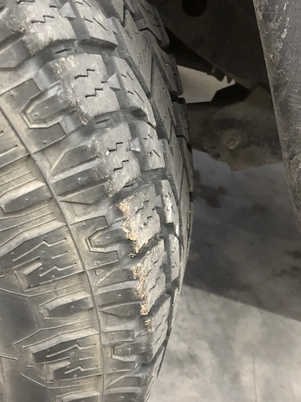

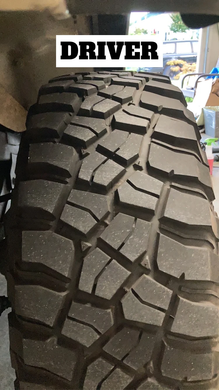

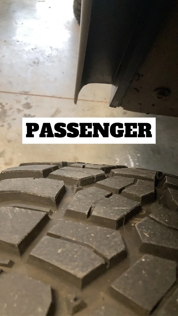

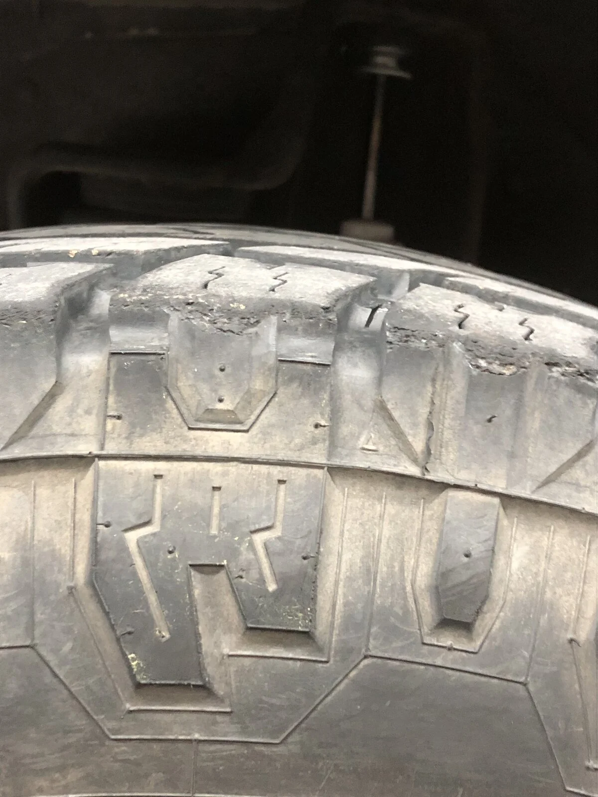

How about showing us a pic of this cupping that's happening on those front tires ? Both sides.
Try tightening first.
That (spherical) bushing should be straight up and down, tight to the bracket.
Did you swap that from the other jeep?
Reactions: DropTopDon
That's what I thought, will try tightening again when I replace tie rod tomorrow. Also yes the track bar was from the old jeep.
There should be zero movement in your track bar. Can’t believe that is not causing some drivability issues.
Reactions: AndyG
My thought exactly- has to be it seems- looks like death wobble waiting to happen.
That johnny joint in it needs rebuilt bad. The mount bolt is captive and tightening the nut will not affect the bushing.

Went to tighten the track bar at the frame and it was so loose that I could move the nut with a box wrench and one finger. Got the new tie rod in and torqued the track bar frame side mount to 110. Still not flush with the mount even when torqued though. Aligned my jeep and rotated tires and then took it for a spin. It drives much better now and the steering feels much more responsive. Will keep an eye on the track bar to see if it needs replacing
