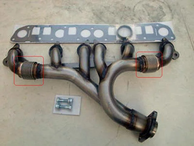

Since the main point of your post Joe was your cracked header, I will guess you have a 97-99 TJ. Those model years were infamous for cracking their factory header, mine cracked three times before the dealer installed the upgraded/more flexible factory replacement header that came out mid-1999 model year.
If that's what you have, its problem is that it doesn't have any way to flex at the two points it commonly cracks at. The engine rocking back & forth due to torque is what flexes then cracks them.
I would not install one of those expensive Borla headers or the standard Banks headers either. They'll crack just as fast and 3X the cost. The Banks Revolver header is worthy and won't crack but it's also 3-4X as much to buy as non-name brand headers like are sold on eBay.
The factory came out with a more flexible design that incorporated two flexible steel bellows at the two points it normally cracks at. Like the below header, you can see its steel flex joints inside the red outlines. Such headers are not expensive and are available in the aftermarket on places like eBay and Amazon.com. Most people report good luck with them. That's the way I'd go if your TJ is a '97-99 like my guess is.

To elaborate on what Jerry said, I was assuming you had 2000-2006 TJ, in which case the exhaust manifold is much different than the one Jerry posted. I've never really heard of the later manifolds cracking.
However, if you have the earlier exhaust manifold like Jerry posted, I would not weld that one either. That one will just crack again if it is welded.
